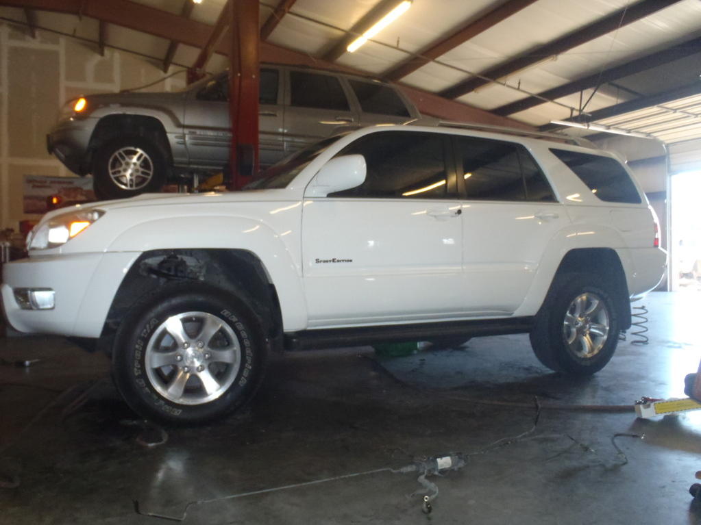

2005 SportEdition
2wd
v8
FJ Coils off a 2007 FJ with 26K miles on them
Bilstein5100s set at 0.85"
Before measurements:
Front Driver 33 7/8" Front Passenger 33 3/4"
Rear Driver 35 1/4" Rear Passenger 35 7/8"
After measurements:
Front Driver 35 7/8" Front Passenger 35 7/8"
Rear Driver 36 3/8" Rear Passenger 37 1/8"
I ended up gaining a little over 2" in the front and 1.125-1.253" in the rear.
After Insall pic first then Before Install pic second:

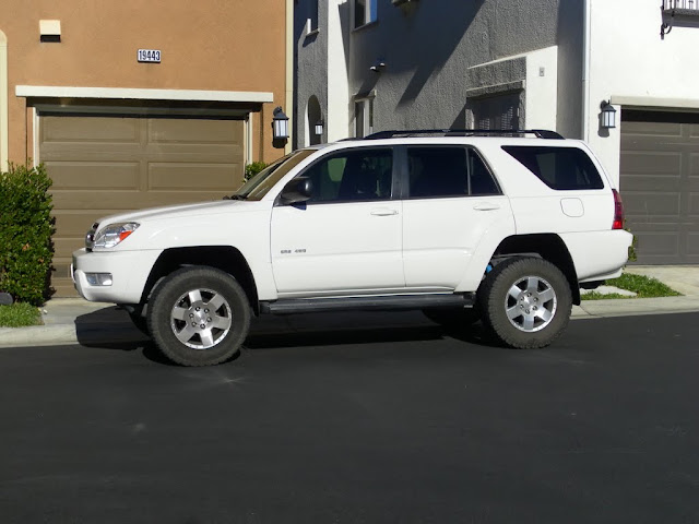

2004 Limited 4X4 with rear air
V8
2008 Front FJ springs, FJ Bilsteins all around (removed Xreas)
1/2" Toytec front spacer
Gained 1 1/4" up front and 1/4" in rear.
Before
[/URL][/IMG]
after
[/URL][/IMG]

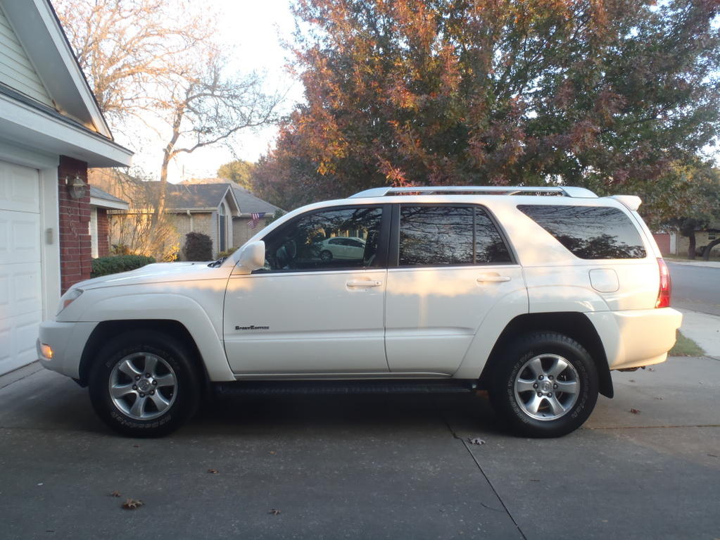

After.jpg~original
FJ springs and the silver bilstiens, 1/4 toytec spacer= 1.5 front and .5 rear.
