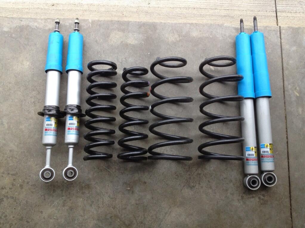

Ive got 2 different set ups detailed here if someone wants to add them to the spreadsheet: FJ Coils
Cliff notes: 2007 4wd V8 Sport, no aftermarket bumpers, etc.
Set up #1
Front: Daystar spacer lift (1" spacer, advertised as a 2" lift), stock springs, stock XREAS shocks = 2" lift
Rear: 2007 4wd FJ rear coils, stock XREAS shocks = 1" lift
Set up #2
Front: Bilstein 5100 shocks, 1.75 setting, 2007 4wd FJ Cruiser springs = 2" lift
Rear: Bilstein 5100 shocks, 2007 FJ Cruiser springs = 1" lift
I have a 2007 t4r sr5 v6 4x4 , I want to level it out for now and I just picked up a set of stock fj bilsteins w/ 18k on them off an 09, was this purchase worth it? And will it level out if I add the fj coils? Any help is greatly appreciated
2005 V6 Sport 4x4
FJ Coils off of 2012 w/ 2400 miles
Bilstein 5100's all around, fronts set at 1.75
Before - After
Driver Front: 33 7/8" - 36 3/4"
Driver Rear: 36 5/8" - 37 5/8"
Passenger Front: 34 - 36 3/4"
Passenger Rear: 36 3/4" - 37 3/8"

2005 Limited V8 4x4 XREAS numbers
So, I got my lift in today and I thought I would share my numbers for those who might have my setup and are wondering what this lift will do. Dealer installed it, it was expensive, but it came out almost exactly even! Money well spent and I couldn't be happier with this look. The lift: FJ springs from an 07 (Zero miles on them, not even a scratch), Bilstein 5100’s front and rear, set to 2.5 max setting front, Daystar 1.5 back, stock 265/65/17’s, first number is before, second is after, keep in mind I have only driven it 3-4 miles since install:
• Front Driver: 33…36.25
• FD Hub up: 19…22.25
• FD Running Brd: 12.75…16
• RD Running Brd: 13.5…15 7/8
• Rear Driver: 34 7/8…37 3/8
• RD Hub up: 21…23
• Front Pass.: 33 1/8…36.25
• FP Hub up: 19…22.5
• FP Running Brd: 12.75…16
• RP Running Brd: 13.5…16
• Rear Pass: 35.25…37 3/8
• RP Hub up: 21…23.25
My Runner is a Limited 4x4 V8, had XREAS and so far, I won’t miss it. There is A LOT less nose dive, and it is better at tight turning, and it takes bumps better, it is almost too smooth but I love it so far. My fiancé is most certainly gonna like the new ride quality better, less bump feel.

2006 sport edition v6 2wd
2010+ FJ Trail Teams bilstein shocks and springs
Daystar 2.5/1.5
Well, I finally installed the lift. I installed new Bilstein 5100s and FJ 2010 springs in the four corners. The fronts were placed at 1.75" lift. Measurements are after alignment and 50 miles. The rear settled about 1/8" in that time, the front did not budge.
I have to say that this setup is living to its expectations. The ride is improved, a tiny stiffer, but not as much as the OMEs I had in my 3rd gen. The ride is just perfect. This week I am going for a 600 mile drive towing the boat so let's see how that goes.
Measurements before:
FL: 32 15/16" ; FR: 33 1/4"
RL: 35 1/2" ; RR: 35 3/8"
After:
FL: 35 5/16" ; FR: 35 1/2"
RL: 35 7/8" ; RR: 35 7/8"
So about 2 1/4" lift in front and 1/2" in rear. I still want a little bit more in the rear so I may install Cornfed's 1" spacers.
My ride is a 2008 4Runner 4wd V8 with 50k miles and stock 265/65R17 tires.
Bottom line: just do it! I did it alone and it took me the whole day, but was well worth it; including the front spring compression/installation. I will post some details and tips in another post.
EDIT: ok, so here is a report after 1,000 miles. 750 of those were towing a 4,500 lbs boat:
FL: 35 1/16" ; FR: 35 5/16"
RL: 35 5/8" ; RR: 35 1/2"
So a drop of about 1/4" all around..... I hope it stops sagging. I also measure at the running boards and I have about 1/8" rake front-to-rear, so rear spacers are coming on top of Firestone air springs for towing.

I lifted my 2004 4wd 4 runner this past weekend. 122,00 miles on the truck. stock measurements from the ground to center of wheel well front was 33 and the rear was 35. I bought 2012 FJ Cruiser rear coils and front strut assembly with toyota struts with 12,000 miles. I installed a 1 1/2 inch spacer in rear and 2 inch spacer in front. (top mounted) finished results are 36 inches front and 37 1/2 rear. Also the lower mount on my truck was 39 mm and the lower strut assembly was 41 mm. I read about grinding and all that but we took the lower control arm off and decided there is not enough material to grind on the mount. So, I took a piece of 1/8 steel placed inside of the mount put a long bolt through the other side placed a bunch of washers on the bolt inside the mount then placed a nut on the end of the bolt snugged it up against the steel then took an impact wrench and tightened up the bolt even more which of course spread out the mount. this worked perfectly!! The other side we left the lower control arm on and just did the same thing while still on the truck. We loosened up the alignment bolts on the lower control arms so they would fall out of the way. Marked them and it worked great.
Wondering if this setup from a 2013 FJ will work on my 04 4Runner.
