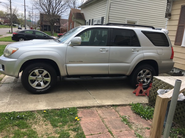

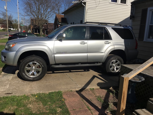

I did mine last year, I used Moog 81081 2009 fj rear springs $57 and 07-09 fj DTA 70020 quick struts and rear shocks $169 and did a supreme suspensions 3" front 2" rear spacer lift $165. All purchased on Amazon and installed by me, I eliminated the xraes factory suspension.
  • my06t4r-albums-my-06-4runner-picture55789-before-fj-struts-springs-lift-spacers.jpeg

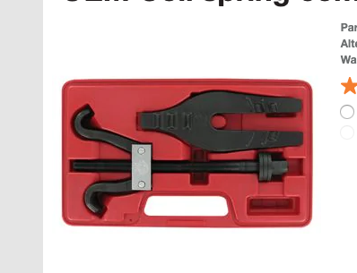

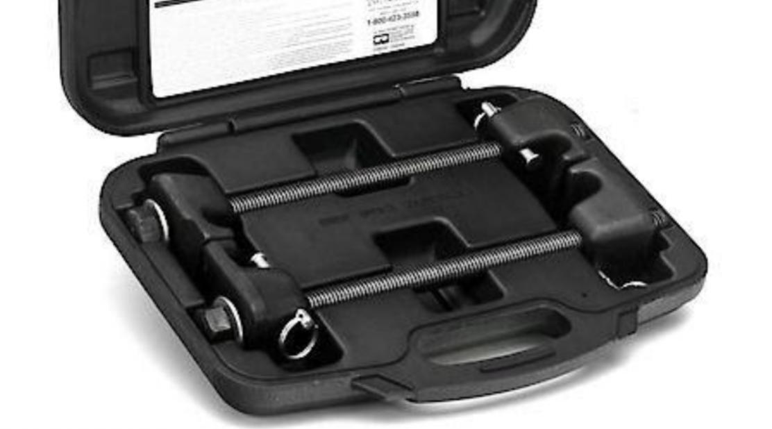

Here are some images of compressor spring kits that are available to rent near me.
The first image didn't work for me... although NOW that I read it, it seems to be made to compress the spring on struts (not sure that I'd trust it for that... I used the no-compressor trick written up on this forum... it's one where you use a jack to compress and slowly decompress the lower control arm, so you end up slowly and carefully releasing and then recompressing the strut coil without using any type of tool... just the weight of the vehicle, and some jacks... for the struts, I'd prefer to pay a shop to compress them, rather than use some cheap kit that I've never used and risk getting hurt).
The second one I would tend to favor, as I prefer having a flat piece or a disc shaped piece inside the coil spring, and I suspect it would make it easier to remove.
I would suspect that the third kit might be hard to remove one the spring is in place, but your experience may differ.
