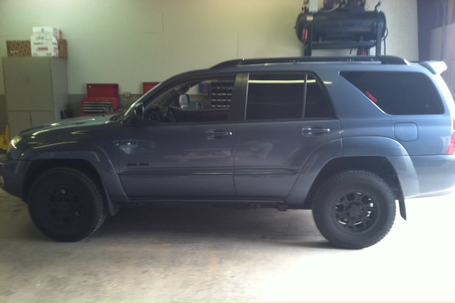

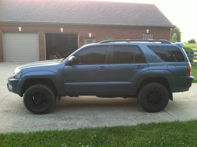

Here's a one of a kind front end only Fj swap...
Its an adjustable Pro Comp drop bracket, modified to fit a fourth gen (05 limited V8). Max allowable lift is seven inches, I currently have it set to just over 4 inches, need alot more work and bigger tires before I can go to 6".
Current wheel well height is 43.5 inches off the ground (sittin on 35's).

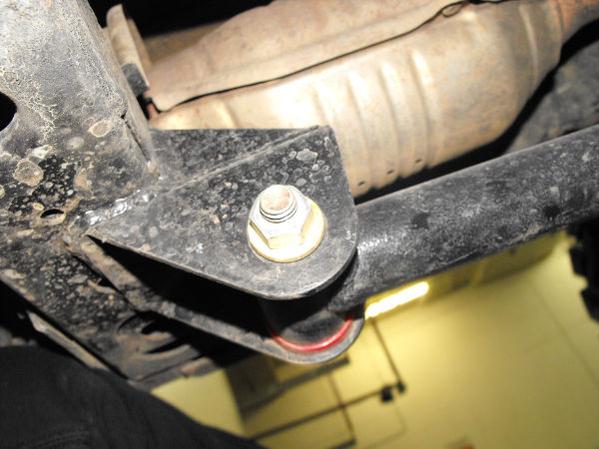

Sorry for the delay in responce, didnt notice the question till last night...
Anyhow, the biggest part was getting the rear supports from the bracket to the crossmember, this required fabricating a small bracket and some welding to make it work:
The rest of the problems were all minor but where none the less a pain in the butt. Forward crossmember bolt holes were slightly off, getting the upper coil mounts to fit perfectly were difficult to say the least and then once tested they required removal (entire front end disasembled) and rubber "washers" were installed to limit longitudinal movement of the shock as it was thumping and clunking around. Also a bar is inserted into the forward crossmember to strength'n where the bracket bolts to it - that was not nice to get in and required more welding to fix up the hole we made. There were times where all we could do was walk away and have a beer. I never concidered it to be impossible, just very difficult as it felt like nothing really went smoothly and evrything took more work then you would have thought needed. We spent just over a week on the front end alone and even more time on the rear end. The easiest and most fun part was grinding down the axle while mildly drunk.
Oh, and we try'd to fit a tacoma kit first but it was off on the width, however the rear supports were almost perfect, so a combination of the two kits would have complimented each other very well.
If you are looking to do this for driving purposes I would say that the truck handles very well on the front end, but my rear end is pretty sloppy with my Bilsetin angles and the super flex leafs... so I woudn't recommend that for you.
