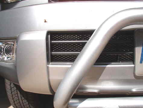

4th Gen Grill Inserts....sample pic...

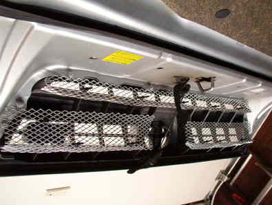

ok i took a few more pics....the ones from further away dont seem to show p, so ill post a few close ups...
loyd,
that looks really good! How did you mount the mesh in the back and tell us where to buy that stuff.
I like the mesh in the scoop too, that's really nice.
Good job. Where did you get the bug shield?! I guess you are in Canada?
yes the guard is from canada...theres a few posts already discussing that one....but you can get them. as for the mesh, i mounted it with thin black zip ties, to the plastic in the grill.....it sits in there tight and wont budge. there is a similar mesh at home depot for the rain gutters - same style anyways...this stuff is chromed or chrome painted, for auto applications. i bought it at an auto parts store down here - canadian tire. it comes in a 4 ft x 1 ft sheet, and you use tin snips to cut a piece to fit each grill - upper/lower. i think i needed 2, and had lots left...it was 50 bucks canadian - rip off but worth it i guess. here is a sight with a few close up shots...and order info....
http://www.autodirectsave.com/MeshGrille.asp

just make sure that stuff is stainless, or else it will rust out in no time....good luck...be carefull that stuffs sharp!

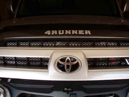

Just wanted to let you know I bought the stuff from Home Depot too, and installed it tonight.
One thing I did since this wasn't quite as shiny as the stuff bought in the auto stores. I bought some of that chrome spray paint and coated the gutter gaurds with it.
It really helps it shine a little more.
Here are some pics, sorry they aren't that great. It was starting to get dark.

it sure does help keep the bugs out of there, that's for sure!!
just took a trip down to the ocean, and when I got back, I noticed all the bugs that were stuck on the new insert rather then stuck in the radiator.
