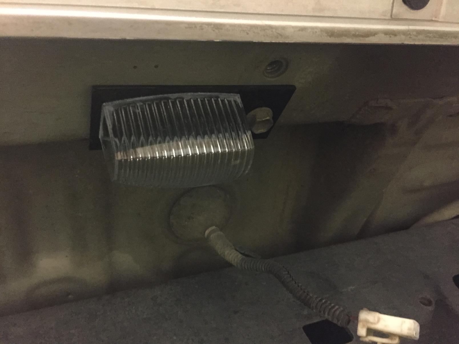

Here's how the housing will mount. I really didn't want to cut the OEM connection, but finally decided to cut it with about a 2" tail so I could always reuse if I needed to.

I removed the running boards off of my 04 Limited today and had this exact idea as I was unplugging the wiring harness to the lights.
I wonder if anyone has taken apart the factory running board to get at the OE wiring harness? There are lenses with sockets on the running boards with a loomed harness. Could be an easy weather-tight solution, assuming I can easily mount the lens under the truck.
