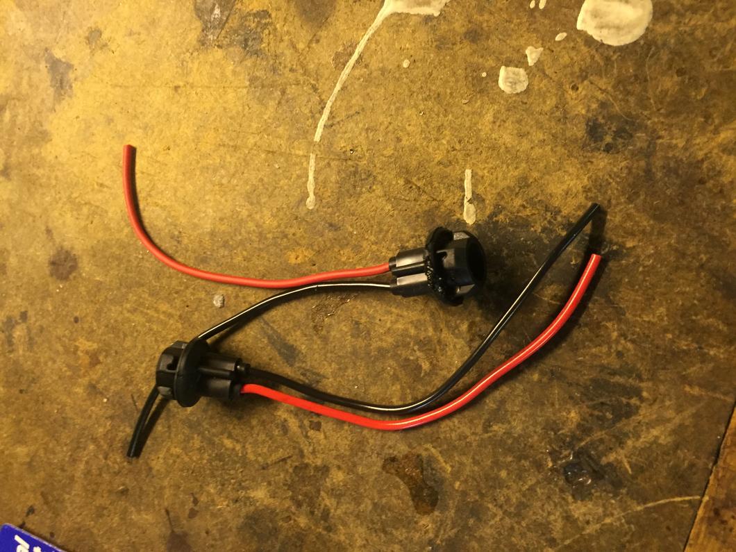

4th gen Ground Lighting (without running boards) for ~$10
nice job... i would use some thing better then super glue to hold the lens. use some kind of L bracket or drill a hole through the center and a bolt, stopper then nut.
Yeah, I searched Home Depot for some sort of bracket I could use, even looked at framing straps, but couldn't come up with anything that I could Jerry-rig into place with the light. I'm going to keep an eye on the super glue, and see how it holds up. I'm actually thinking the plastic will break before the glue fails. But we'll see.

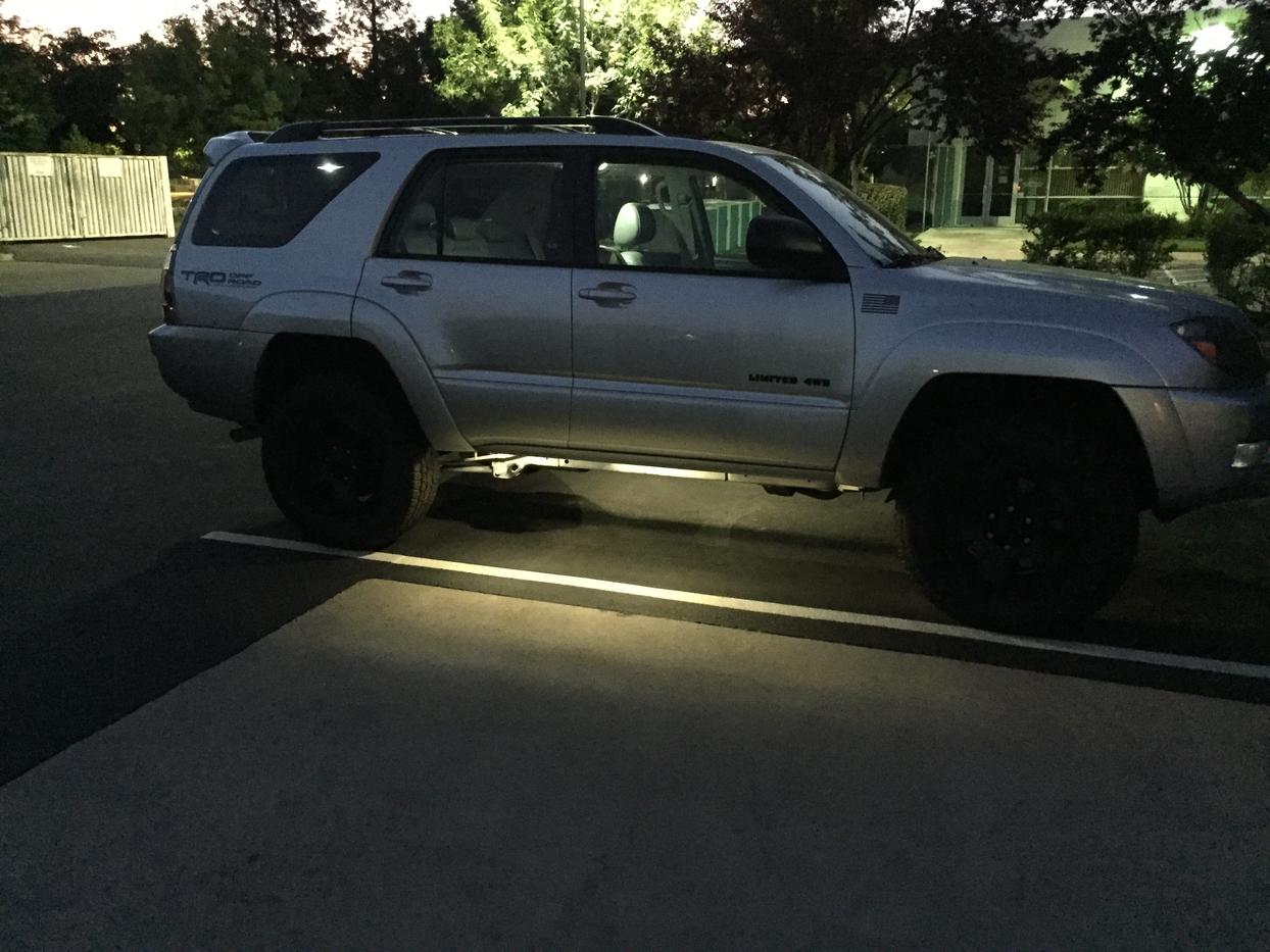

Here's a glamor shot. The parking lot lights were a little bright, but I think this shows how well it lights up the ground.

Nice work OP. But if you main goal was cheap and easy why not just bend a few pieces of left over metal (or plastic even), re-use four of the running board bolts, and these guys: https://www.amazon.com/dp/B00MXJ4XY...TF8&colid=3PLPUKQIB9UZ9&coliid=I3UG0VZTWJ840X
No offense to you solution, it certainly looks like it turned out well, but it seems like more work than other alternatives at about the same (albeit, quite low) cost.
Those are pretty cool looking, but I hadn't found anything like that before starting. I might have used those, but I'm not very electrically proficient and didn't want to mess anything up. I wanted to keep with the OEM bulb base as well. Also, I wanted to stay with cheap replacable parts, so when something gets smashed or broken it can easily be fixed.
Yours turned out nice for sure. I have to admit, I chuckled when I saw you pillage nightlights for lenses, but appreciate your ingenuity. ;):
Update: After some decent driving on forest roads, the lights are still working great. I didn't take on any crazy terrain, but there were some ruts and rocks. I figured I'd find the bolts or plastic a little loose, but all is still tight and holding up very well.
@ Silver_midlife_t4r
Looks good! I like the ingenuity of the mod. I am interested in how it holds up over the winter (if we get one this year), especially if you take it to Tahoe in the snow or ever hit the mud (Prairie City can be fun with the right amount of rain :D).
