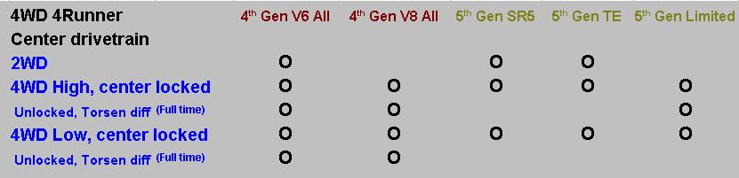

A little graphic representation if you like that sort of thing.
