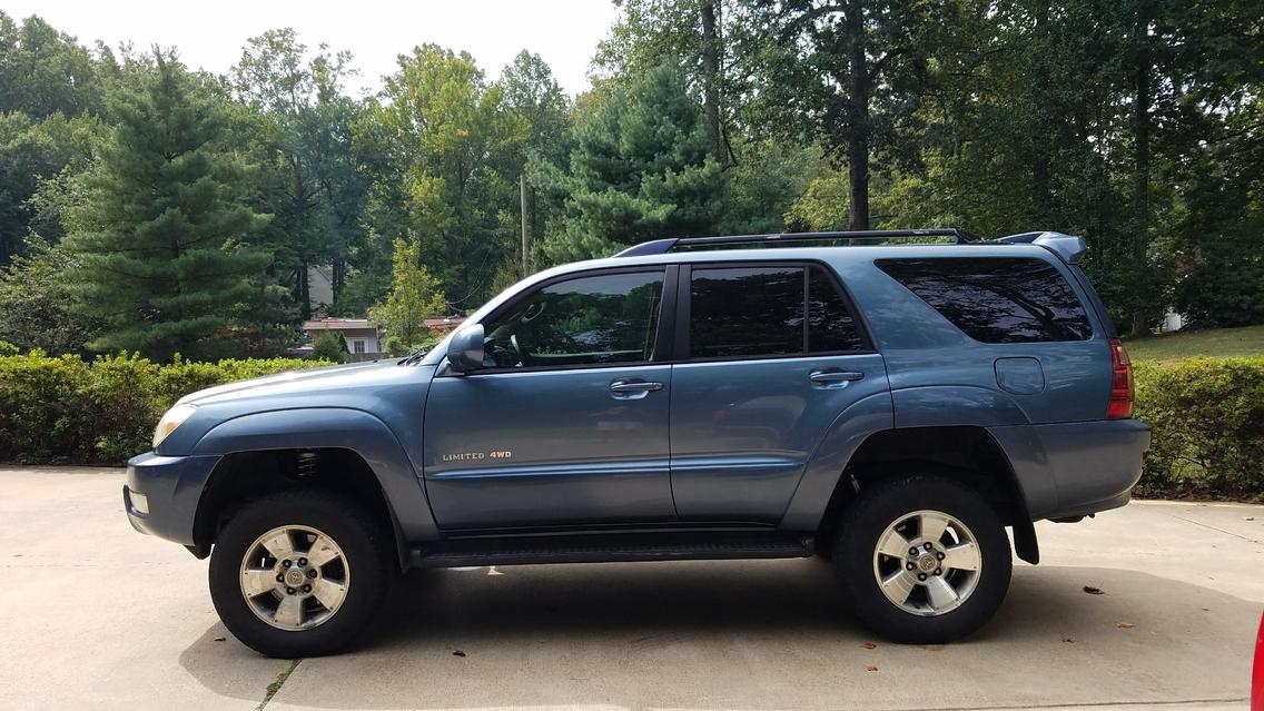

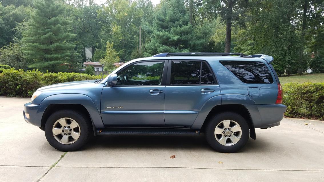

3" Ultimate Toytec Lift Kit
Just finished installing my Toytec 3" kit. So far I'm really happy with the quality, instructions, and ease of installation.
Got some new Dynapro ATM's in the trunk and should be on tomorrow.
As of right now I actually gained 4" total lift but I'm hoping once the springs settle in it should drop down.
