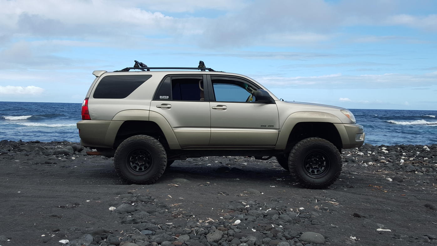

Howzit friend! I went with the 885OME coils because of what ive learned from this forum. The general thought as noted on the first post of this thread is that the 885 coils are good for a nice lift and some added weight if you have a v6 T4R with added weight (bumpers etc) or a V8 stock. The 885s and bilstein 5100s that I installed on my 04 v6 T4R are relatively sturdy on the road and handles well off road. Ive got the bilsteins on the second notch as of right now. Depending on your plans the adjustable 5100s are a very good purchase initially with the OME886 coils IMHO. Since I'm planning on a front bumper in the future I don't consider it a nuisance to drive around till then. There are no other upgrades "needed" for a 3 inch lift. However, there are a bunch of "wants" lol perhaps some after market upper control arms in the future. When you get into a lift higher than a 3" you'll most likely need upgrades in other areas. Things like sway bar relocates, diff drop kits, etc. I installed Procomp fj lift coils in the rear with bilstein 5100 shocks as well. Don't know much about the superflex as you've mentioned but I'm sure it will work just fine. Heres a pic of my T4R as of right now. aloha from Hawaii!

Nice runner!

Thanks for the kind words my friend! I don't see many gold T4R out here either. Most are completely BLACKED out or silver. As for tires they are 285/75/16 on cragar steel rims and 2" wheel spacers. I did do a 2 inch body lift (fat pats) on mines which gave me the clearance I needed to run these tires without any trimming to the body mounts. It was either a "body lift" or a "bracket lift" to run the tires without trimming body mounts and fenders. Considering that the Rough country FJ bracket lift (which is a complete 6 inch bolt on lift) costs $1500 shipped to Hawaii....I was happy to "try" the body lift for right around $130 bucks! I'm glad I went that route instead. Looking forward to seeing your rig up and running!
