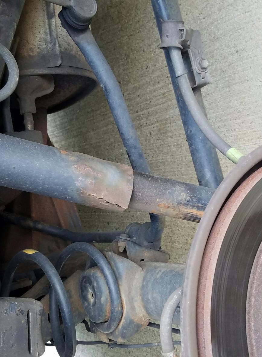

My 2006 4Runner Limited rear XREAS shock has rusted out and have a super spongy/loud metal scraping ride these days. (Hopefully I was able to attach the photo). I originally assumed it was the brake pads so when I pulled off the tire this is what I found. Also will need some new shoes since the tread is almost done so hopefully I can get some suggestions on new shoes with the kit I listed below.
After reading over a ton of the material I have decided to replace the XREAS for cost as well as ease of replacement down the road.

Is there anything else I need to be aware of or look out for? Eventually when I get some extra cash I plan on getting a new set of UCA's. I didn't notice anything about having to extend any lines (steering, brakes, etc.) so I'm assuming that it's pretty much bolt on with the exception of the re-alignment.
