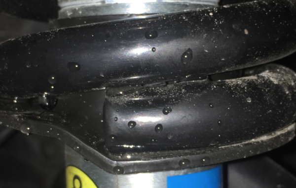

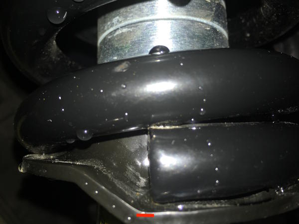

Spring Seat Question
I just installed 5100s with OME 884s and one of the spring seats moved a little during installation. The driver side spring is not flush with the lip of the spring seat (shown below, red line is the gap between the end of the spring and start of the lip). The passenger side is flush as shown.
Driver - gap:
Passenger - flush:
I've read that springs should be installed so that they are flush against the lip on the spring seat but I don't know the reasoning behind why this is needed? I know it is right to have it flush so I'll probably correct it when I have time.
Driver - gap:
Passenger - flush:
That shouldn't effect anything, there is no safety concern. They just need to be close. If anything it should help correct driver's side lean the way you have it.
