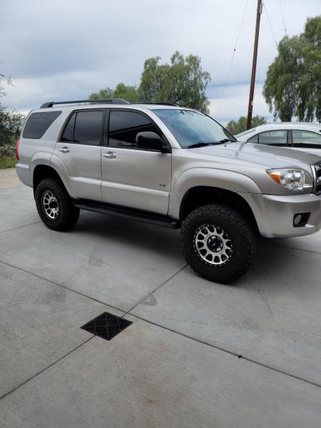

Last week I just installed the OME kit. This is a full 3" lift kit (got more actually) and required I replace the UCAs as well. It is among the "cheaper" lift kits, but still much more significant in price than a set of Bilstein's and stock coils. I opted to do it myself, but nonetheless, this kit is a whole different league than a spacer or leveling kit. This is where performance starts to really shine. While the first couple hundred miles were rough, the suspension has started to break in nicely. The vehicle looks like a total off-road beast and I can't wait to rip her along the mountain roads of Colorado. Until then, I cannot attest to the actual off-road performance of the OME kit compared to the Bilstein's. As for highway/around town, it's MUCH stiffer than stock or the Bilstein's, BUT not uncomfortable. Just a firmer drive feel (great for emergency maneuvers with quick ability to recover. Cant even feel my car tilt or drift on hard turns).
