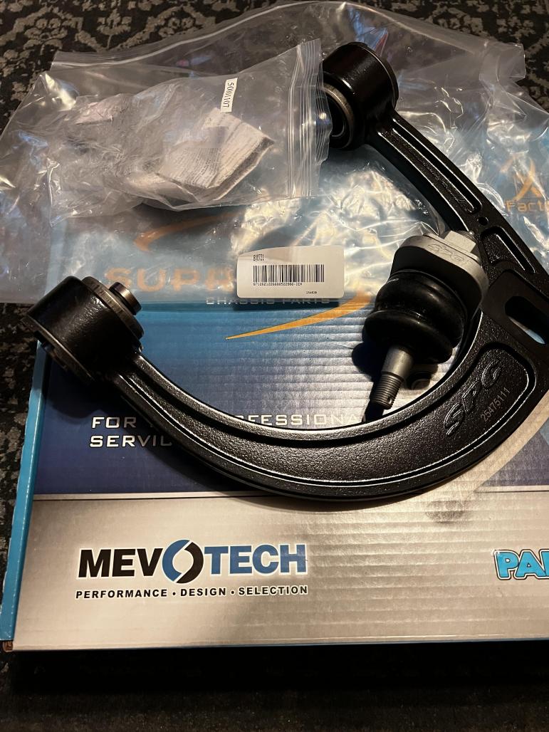

Mevotech Upper Control arms (Rebranded SPC)
Just picked up some Mevotech UCAs and they seem to be rebranded SPC UCAs! Saved some money and my 04 SR5 will get a lift soon!! $411.58 on RockAuto vs $695ish for SPC!

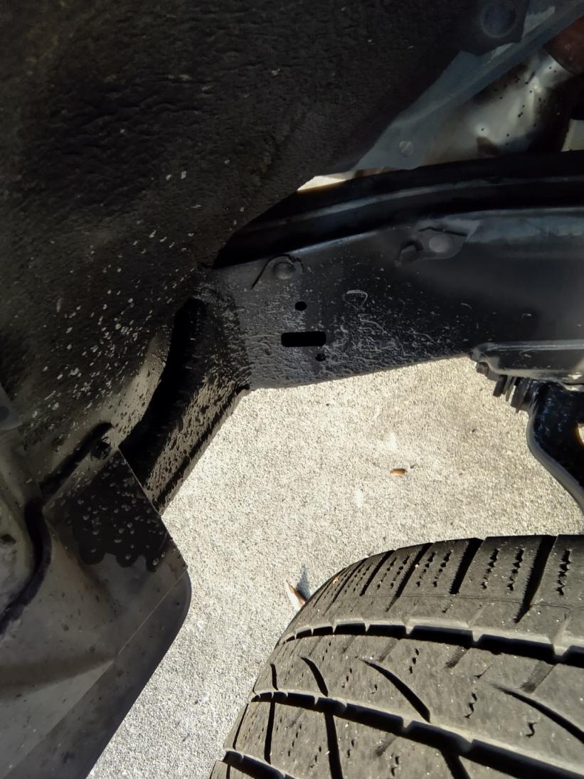

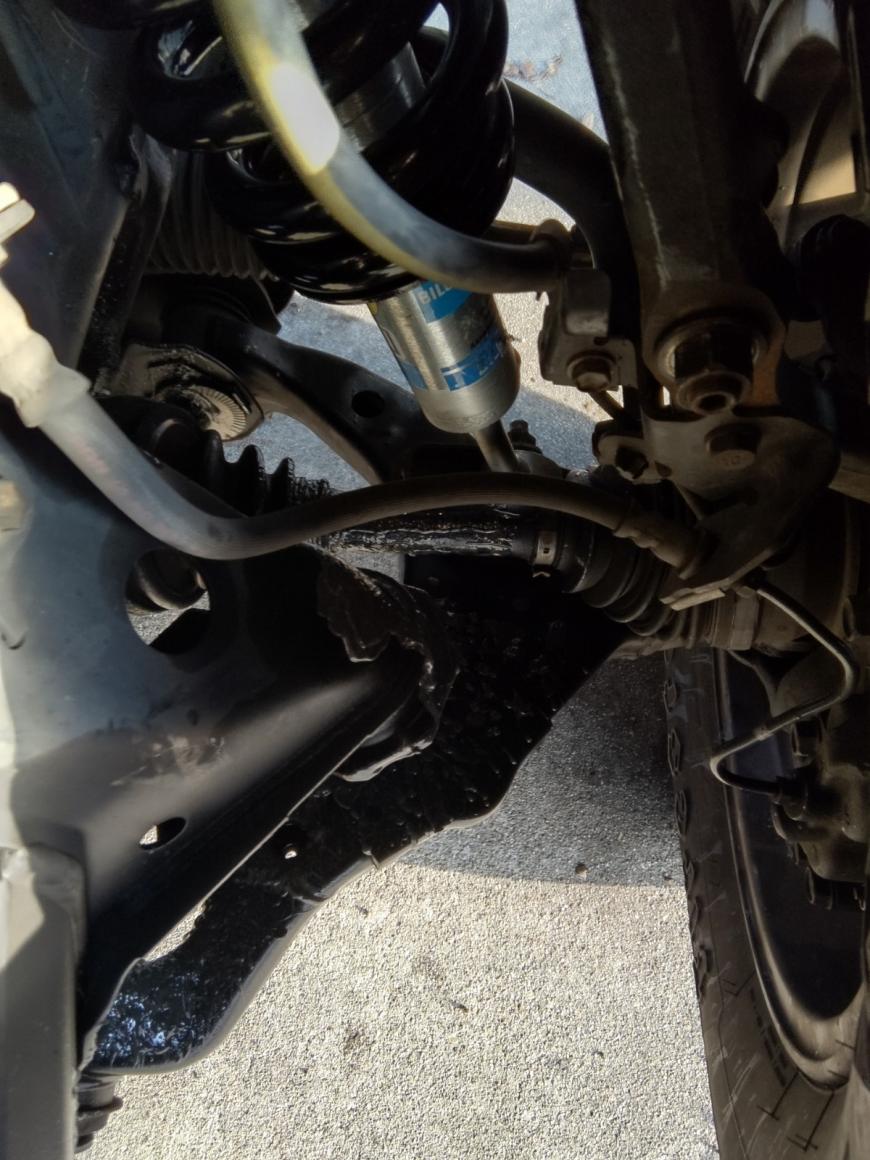

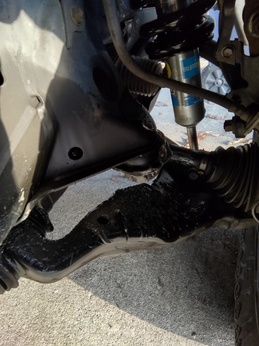

So I did my lift a couple weeks back - Bilstein 5100s and OMEs all around and SPC UCAs. Today I noticed a grey grease/sludge splatter from the suspension areas (happened both on driver and passenger sides)
Any ideas what this is? Big problem, small problem? (2004 V8 Limited)

Edit: Did a little investigating - seems like I tore the CV axle boots, does that seem right? Would purchasing these from CVJ and replacing them fix the issue?
Edit 2: If I'm on the right track diagnosing this as a CV axle boot issue, can I order these and just replace the boot?, following a tutorial like this?

The boots always break when you do the lift. You need to drop the front diff. Get a kit. I changed both axles, boots were broken.
Yes, replacing them with CVJ boots will fix the issue. Just fair warning, it's quite straight forward, but an extremely messy job.
You don't need a diff drop. Diff drops actually don't do much/anything at all on our 4th gens.
