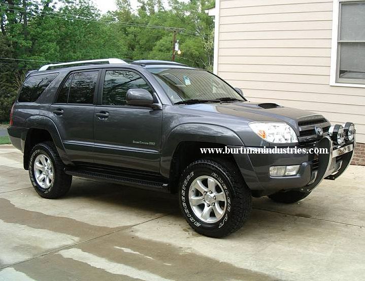

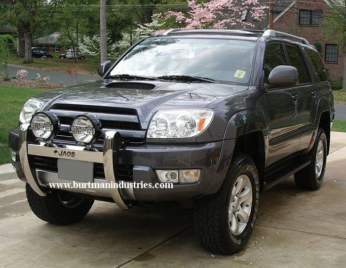

Burtman Industries Lift kits
more pic on the link above
