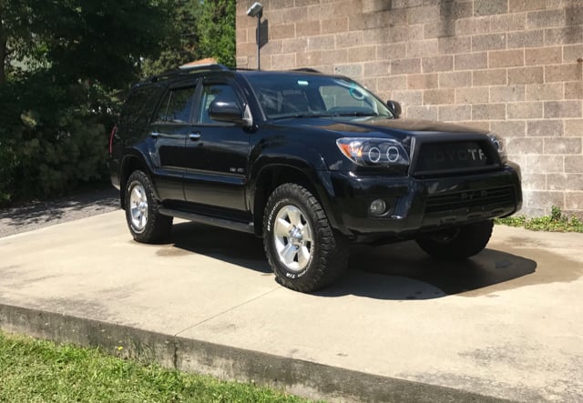

Recent install of the 2/1 kit on 265/70/17's on stock powder coated wheels.

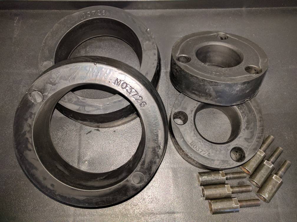

Have a set of Daystars 2.5/1.5 if you're interested. $70 shipped

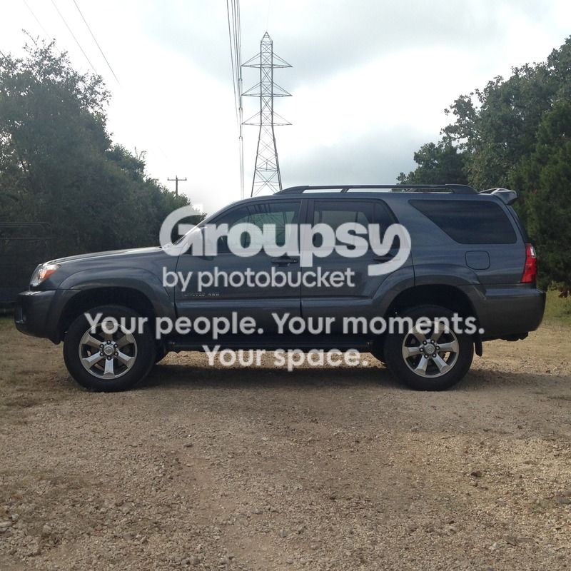

Trying to get the rear a little higher. Hard to see in the picture but I'm not a huge fan of the rear being lower than the front.
Currently have stock springs with daystar spacers in the rear. Not sure if I should do Fj with bags and/or 1" spacer,, wheelers t12, or icon 2". At the point where I need to make up my mind, going on a trip soon.
