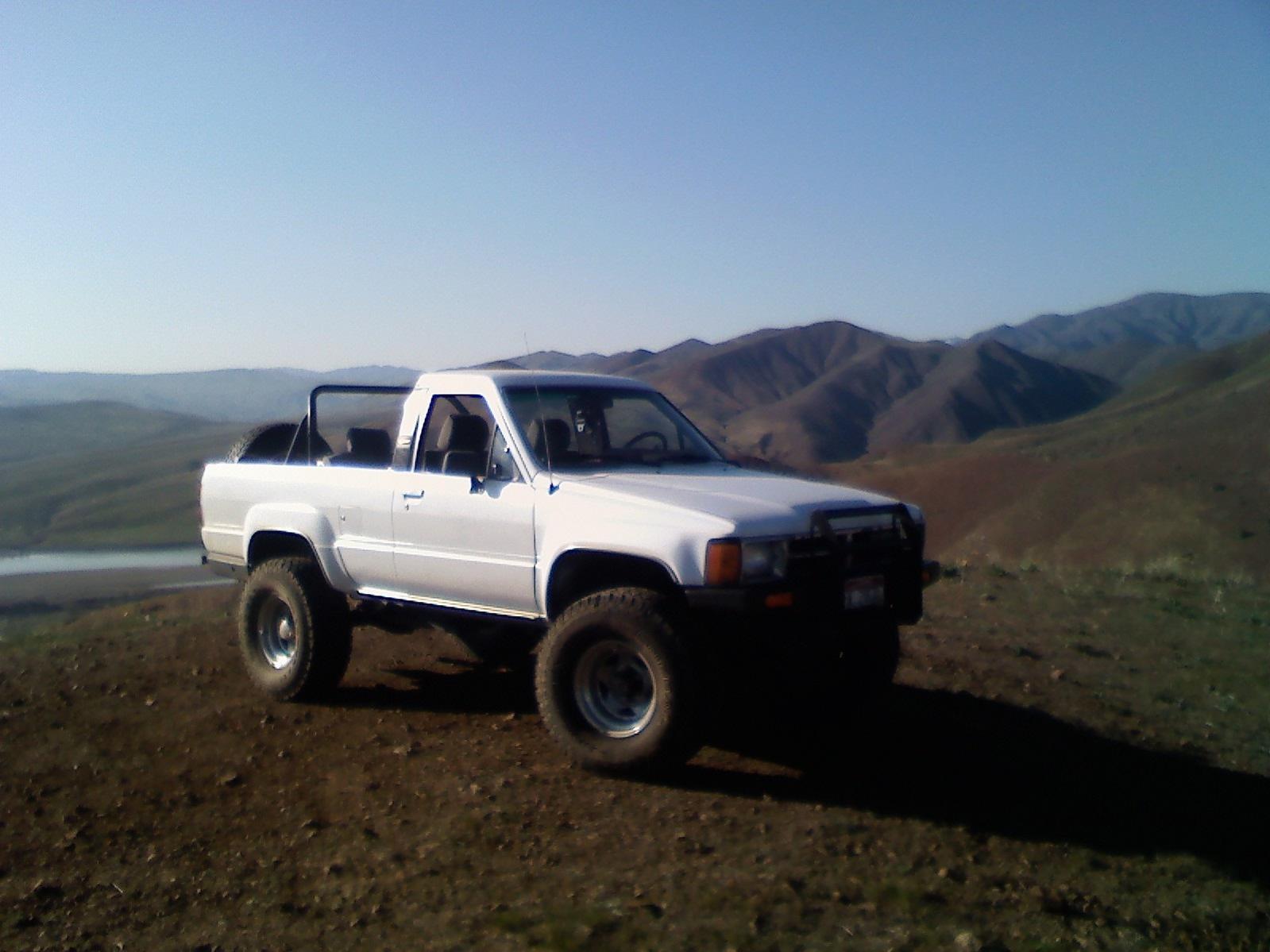

i have ya beat! mine was $14.95 paint job. well i guess about $20 after the sand paper.... walmart had a sale on spray on gloss white rustolium... "in a can" sprayed then sanded then sprayed then sanded then waxed and im very happy with it. been on there a year and its still lookin really good.
i dont know what the guys problem is who says rustiolium is the worst paint ever!!!
