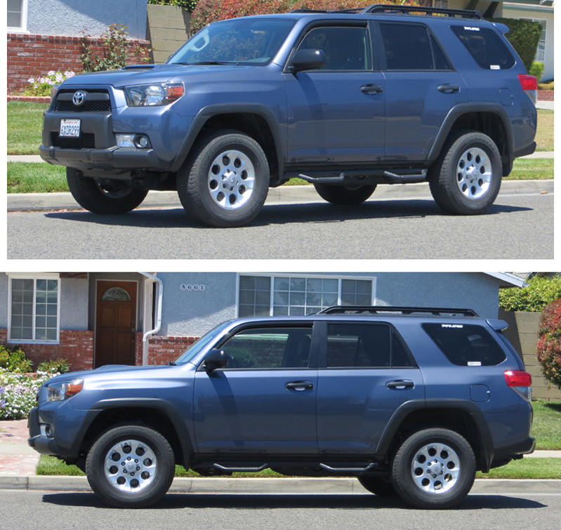

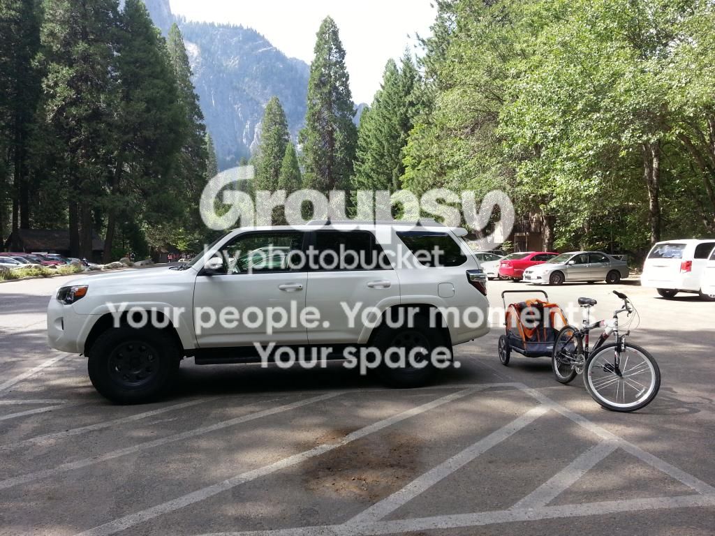

Not 4x4, but same idea.
20140812_102442.jpg~original
20140916_125654.jpg~original
20140916_125759.jpg~original
Bilstein
Mine are set to 0.85 and it's a bit higher in the rear with slight rake. 1.75 will be a better level, but may go tail low, reverse rake with much of a load in back.

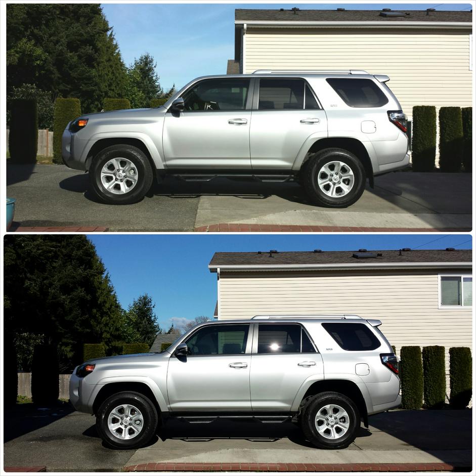

1.75" front and no lift in rear will result in a nose high and even worse with any load in the rear.
My previous set up at 1.75" front and 1" spacer in the rear. Even with two passengers in the rear it will be perfectly leveled.
Compare and contrast photo: stock suspension up top and bottom is with 1.75" & 1" spacer.

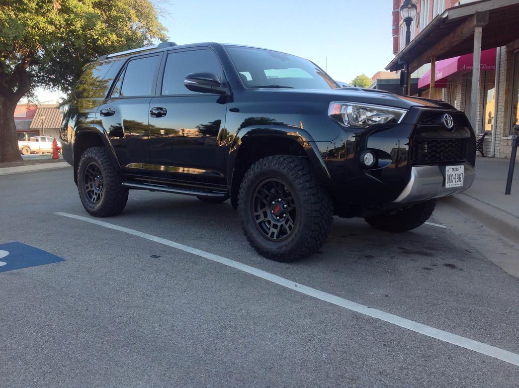

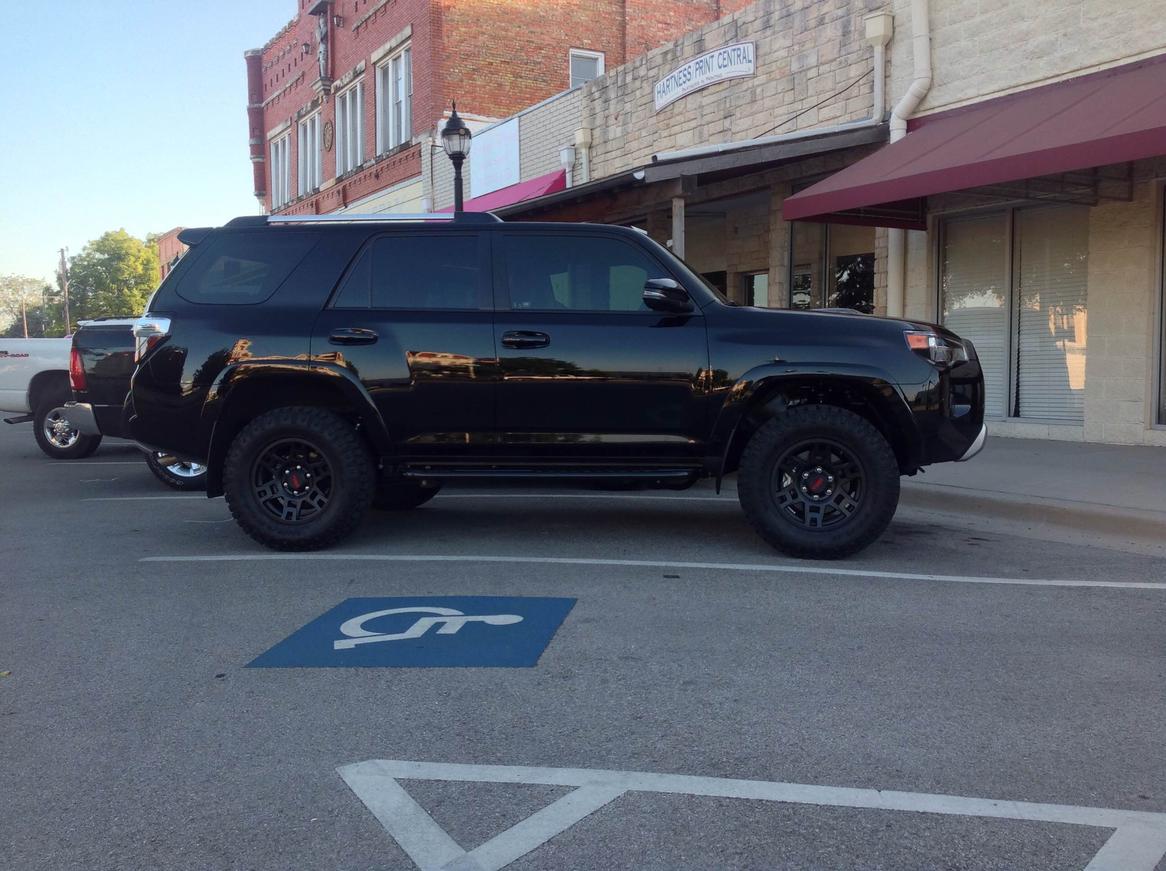

This is a Trail, not an SR5. But the front 5100s are set to 1.75".
I originally made no change to the rear setup (other than installing the rear 5100s). It was dead level and looked great when it was empty, but I felt like it got a tiny bit "nose high" when carrying a full load in the rear or towing anything. So I went back in and added 20mm OME trim spacers to each rear coil to give it back just a little rake while still leaving the front 5100s set at 1.75". I've been really happy with this setup.

Thanks for all of the replies and photos. I am going with the 1.75" setting, and if it sits nose high, then I'll add a spacer to the rear springs.
