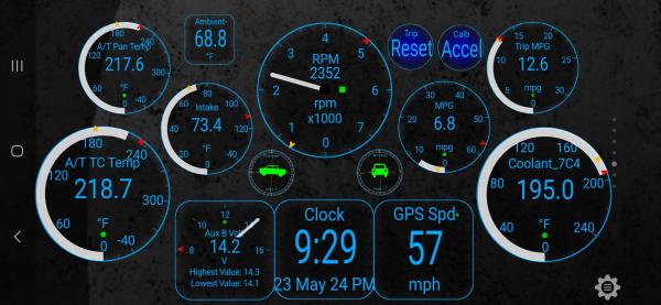

I installed Torque Pro last year (about 8k miles ago), and am using the VeePeak OBDCheck BLE+ reader. I was able to add the PID's from the OP in the Torque Pro settings menu, under the "Manage extra PIDs/Sensors". I just copied the uncompressed PID folder to my phone and found it through the Torque app to import them.
Here's what my dashboard looks like:
zkengle-albums-trans-cooler-install-picture63230-torque-app-screenshot-arriving-camp-mountains-towing-~3-000lbs-no-cooler-installed-~175-miles-3hrs-45min-ambient-air-temp-68f-t-pan-temp-max-around-217f-t-c-temp-max-around-235f.jpg
