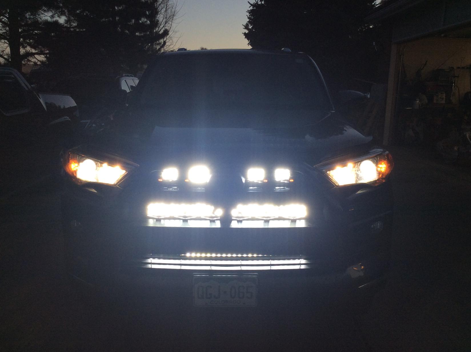

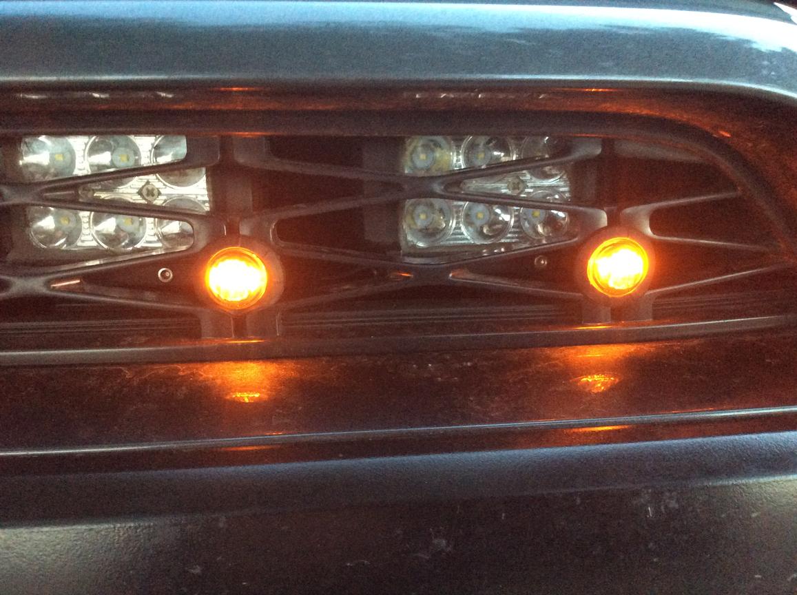

5th Gen Marker Lights in Grill
Installed some superbrightleds.
So I don't want the amber markers to be on when the low beams are also on. In that case, I need to tap into the DRLs, yes? That way the markers are on when the DRLs are on (I actually use the DRLs in daytime). But I suppose they would also come on when I use high beams, too, which is a bit weird. I'm a 2016 non-premium TE so I don't have auto lights.
This also would allow me to go completely dark, unlike tapping into ignition fuse.
The reason I'm thinking this way is because I have replaced my halogen low beams with HID. Running the amber markers with the HID lows seems a bit much--like a big FU to other drivers. (Yes, I know about adjusting HIDs down a bit to reduce impact to other drivers.)
Any thoughts on this?

It all comes down to your personal opinion on the looks. I am no electrical authority on this topic, but you are correct that if you tap into your DRL/high beam wire, your markers would likely come on with the operation of both. Most ppl who want to black out tap into the parking lights since the complement of those ambers with the amber markers looks good, but then you have the issue of the markers being on with your low beams. With regard to the HIDs, the amber marker lights that myself, [MENTION=127657]codyHTX[/MENTION], [MENTION=136976]elusive01[/MENTION] and many others use are not crazy bright at night. You don't need to worry about blinding other drivers with all those lights. I run HID low beams with the amber markers on with ignition, and have only received compliments about the look.

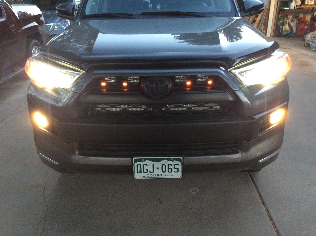

got my install done yesterday, combined [MENTION=57196]needsmoresalt[/MENTION] install using RCO's add a fuse method he posted earlier in this thread and parts of [MENTION=62757]chudiddy[/MENTION] install by shaving the light down around the ends, covering the excess with shrink wrap and installing from behind the grill through the slots.
By shaving the ends of the lights, were you able to install the behind the grill, instead of in front of the grill as in the RCO version? If so, how did you secure the light behind the grill?
Finally joined the marker in grill club

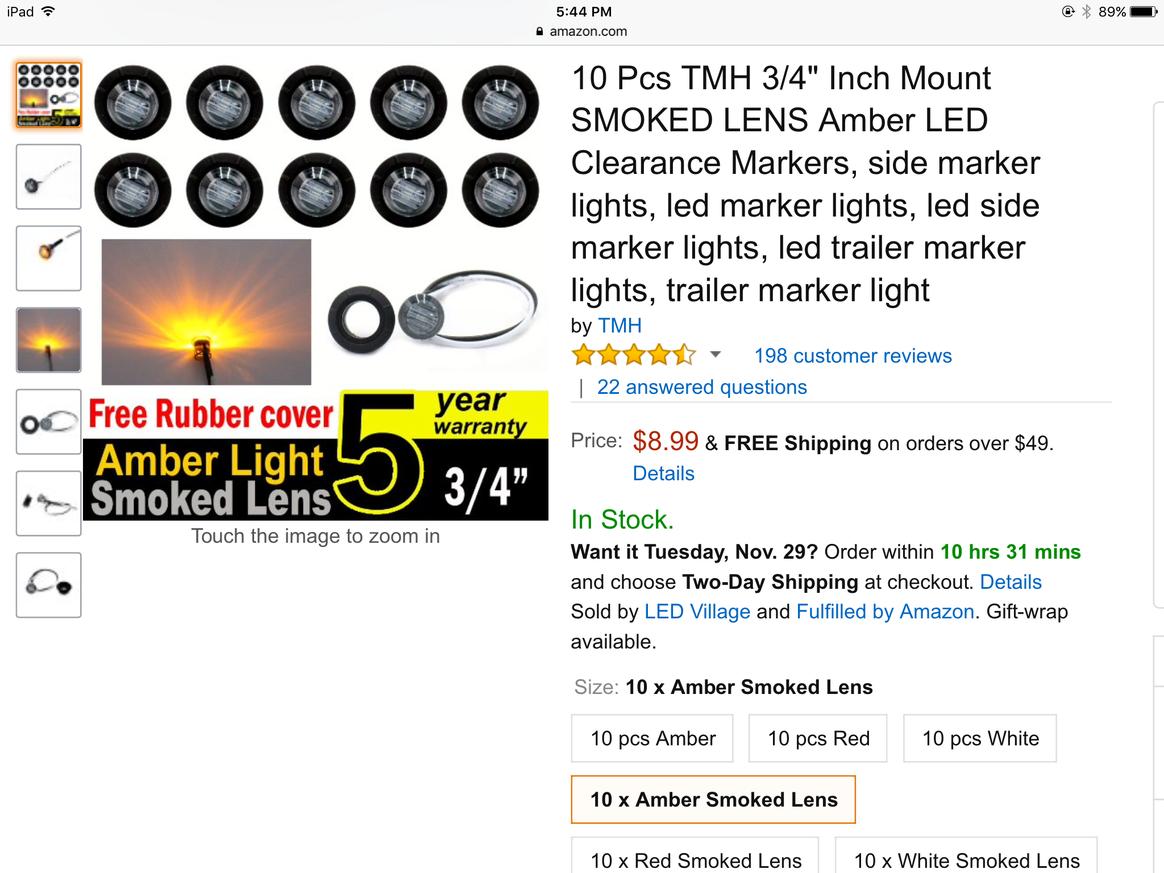

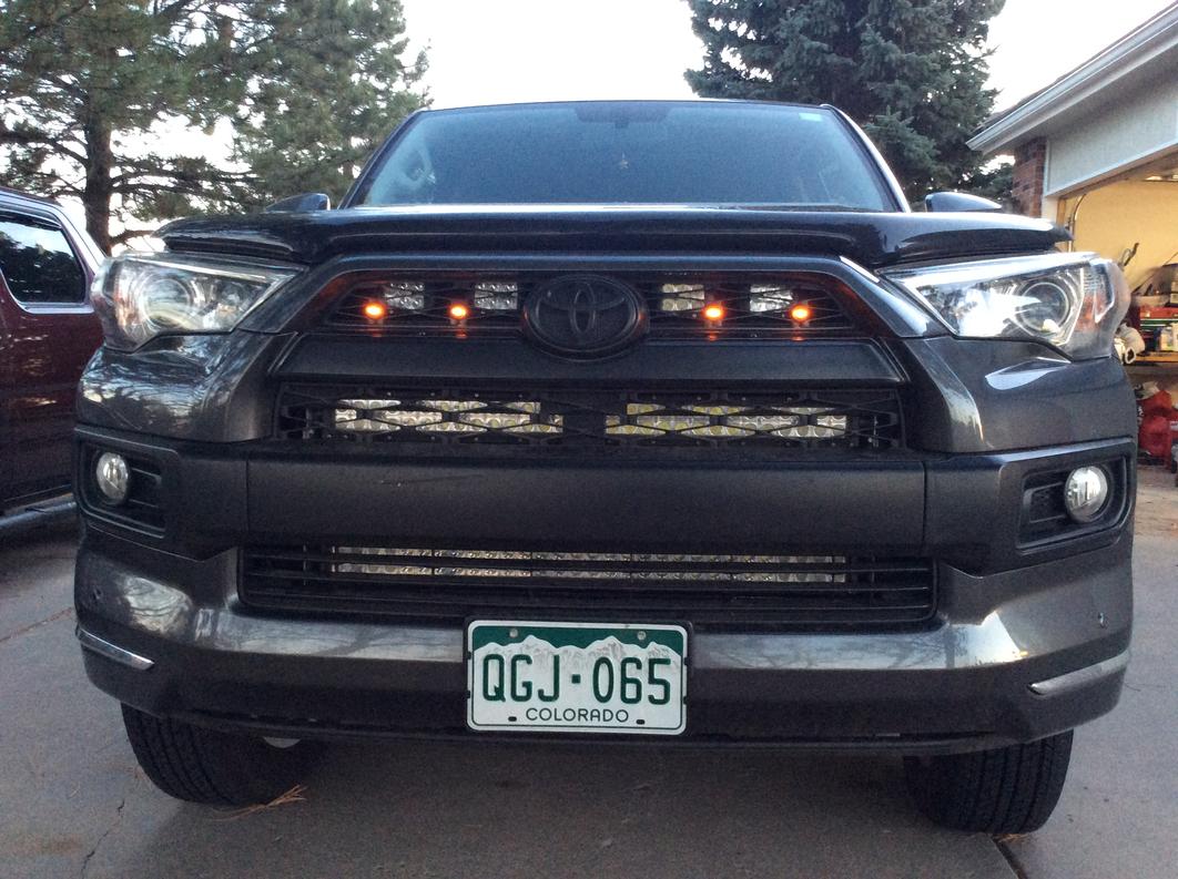

I installed some $9 lights from amazon. These are TMH 3/4" smoked amber lights. They are rated for 60 lumens, I don't think they are that bright, maybe 20 lumens. It's on whenever the engine is started. May add a switch later.
The lights come with a rubber grommet. It's actually fits in between the grill without any modifications. I just wedged it in there and it's pretty tight fit. Also there is markings on the light that tells which is top..
The last picture is with all the lights on except the fogs. I have to do the independents fog light mod soon.
Have you driven like this during summer? How did you not overheat?
Have not had any problems with overheating. There is a lot of airflow between the lights. It looks like it takes up the whole air vent. I driven it to vegas and summer driving in town. Even in 100+ weather city driving.

kuh;can you post a link to the lights you used? I have an idea to use the grommet.
I don't know how to hyperlink the actual website, but I have a picture . It was from Amazon.
Hope thishelps
