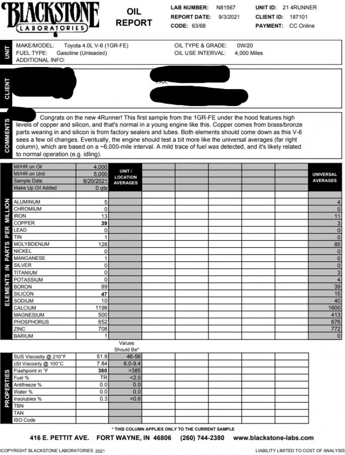

Blackstone oil report that a couple asked for..
2021 TRD Pro that has seen quite a few trips into the California mountains.
This oil was sampled at 5k miles, and I had changed the oil at 1K; so there are only 4k miles on this oil.
TL;DR: data report shows normal wear for a new engine; count for wear and silicon should drop after a few more changes.

That’s better than my first oil report, and very similar. Only thing that took awhile to come down was that copper. Nice first report!
