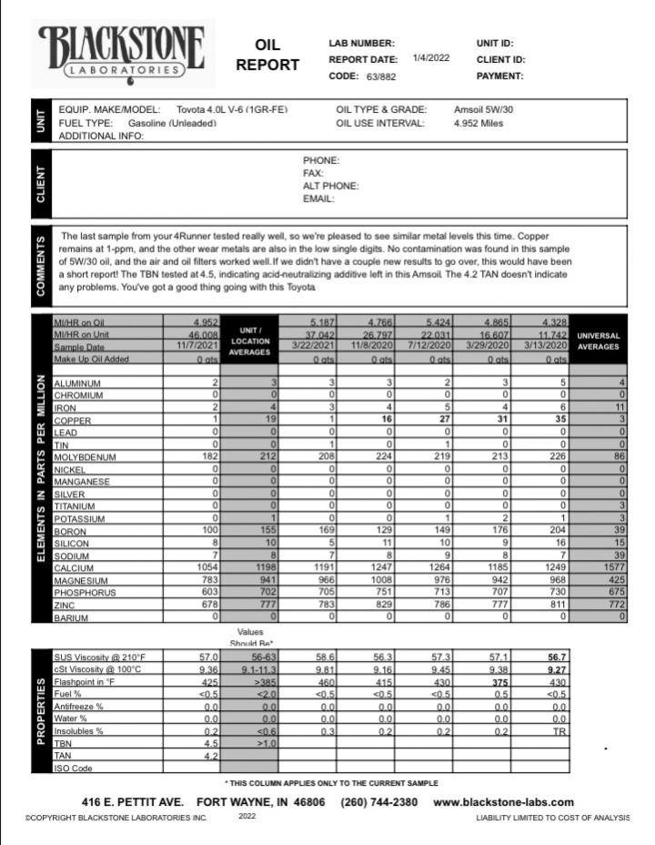

Amsoil 5w30 with TBN and TAN added to the sample test. This oil had 100’s of short trips with a few long hauls to Florida. It held up well!

You’re using Amsoil and dumping it after only 5,000 miles? And doing a $30 oil analysis each time? And using an Amsoil filter?
That’s quite an expense for “peace of mind”.
Peace of mind is priceless. I run synthetic with OE or quality aftermarket filters and dump every 5K as well. I will never go 10K as they claim we should.
