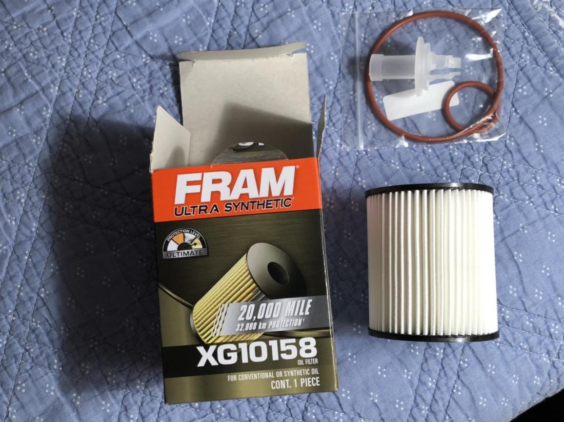

Has anyone tried this Fram full synthetic wire back oil filter? Construction seems solid.

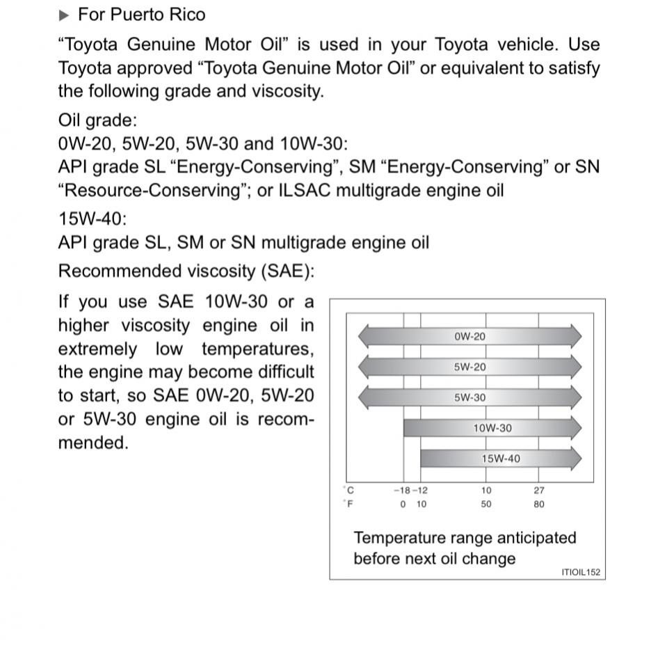

My 2021 manual says anything other than 0W-20 should be temporary. I have not seen a manual say that before. Usually they show a range of temps for a couple different weights. Not this one.
Interesting. I looked that up and see they got rid of the Puerto Rico oil section that specified other oil weights for that climate.
However the text does say for the US:
“The 20 in 0W-20 indicates the viscosity characteristic of the oil
when the oil is at high temperature. An oil with a higher viscosity (one with a higher value) may be better suited if the vehicle is operated at high speeds, or under extreme load conditions”
This is what the owner manual for my 2018 includes:
Phoenix AZ has higher summer temperatures than Puerto Rico. Approved viscosities for a 2011 Tacoma 4.0L in the USA are 0W-20 and 5W-30. Therefore, I use 5W-30 in my 2011 4Runner Trail.
What temperature does your engine oil actually stay at though? The cooling system is designed to keep oil/engine at a certain temp irregardless of ambient. Do you know if your oil runs hotter? Personally my temp gage is the same at operating in AZ July or winter in UT
The robust 4.0 engine will be fine with either oil under normal operating conditions and ambient temperatures across the USA. For most operating conditions above normal, 0W-20 is adequate and at the same time less capable to protect than a higher viscosity oil.
In city driving, my wife tends to make short trips and tries to pass everyone on the road. When the vehicle warranty expired, I began using 5W-30 for driving from Phoenix to Flagstaff, moderate load, grades up to 6%, high ambient temperatures and speeds of 85+. An OBDLink MX+ shows coolant temperature rises 5 degrees and ATF temperature peaks at 224 F on the steepest grade.
I change oil at 5000 miles and filter at 10,000. So, taken all together, I appreciate the extra level of protection 5W-30 offers.
