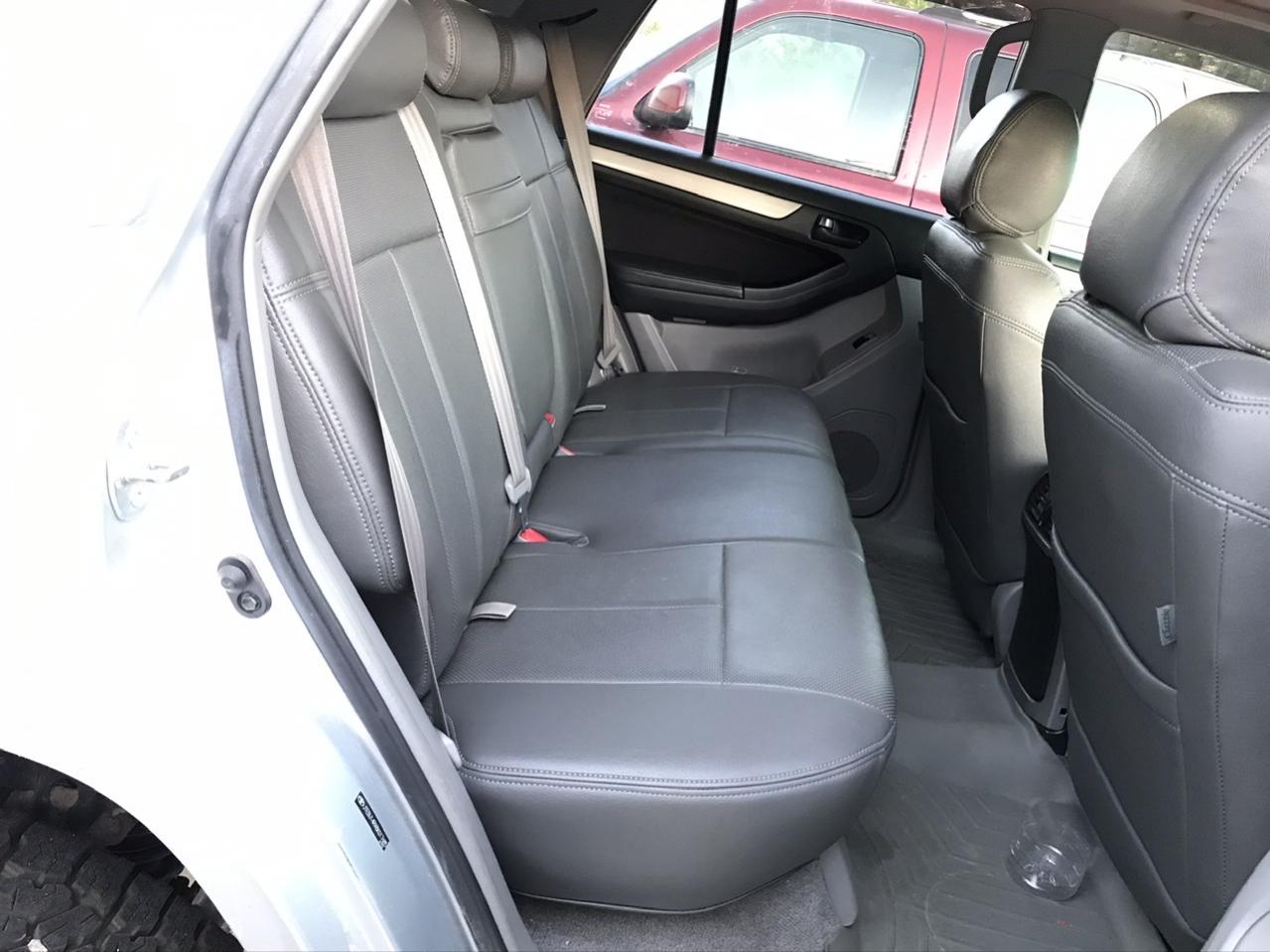

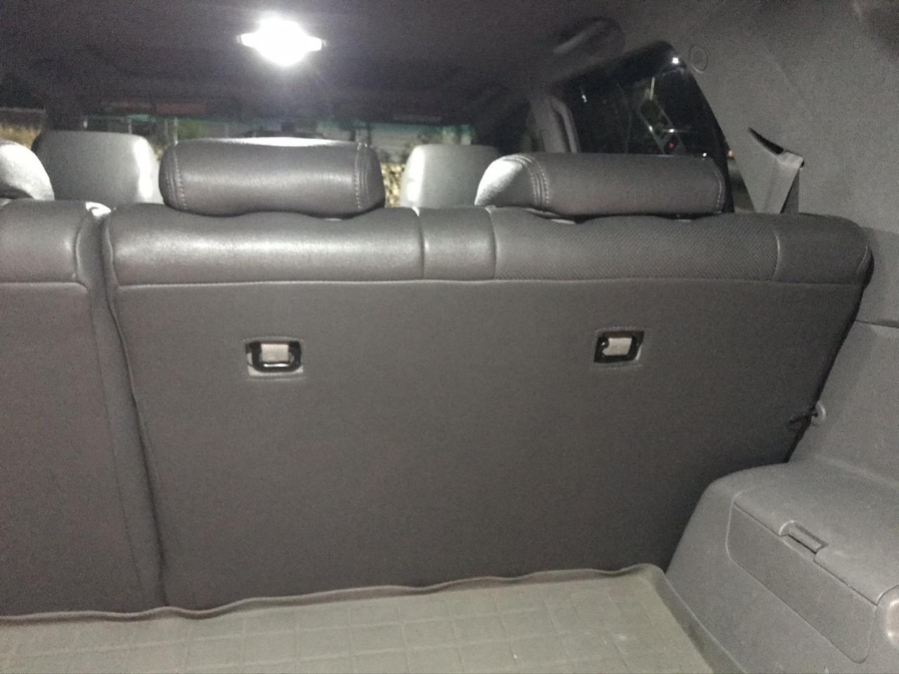

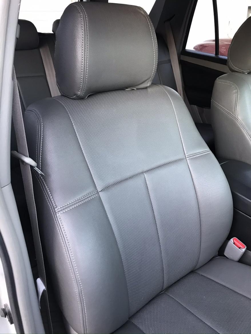

I’m happy with my Clazzio perforated leather seat covers. They fit well and hard to tell they are just covers. Everyone thinks they’re leather seats and are shocked when I tell them they’re just covers. They sell a pair of seat heaters with switches for $119-$169 that I’ve been considering getting as well. May consider it before next winter. I have heated seats in my Subi and they sure spoil you.
The leather seats.com covers are a little pricey but look very nice.
