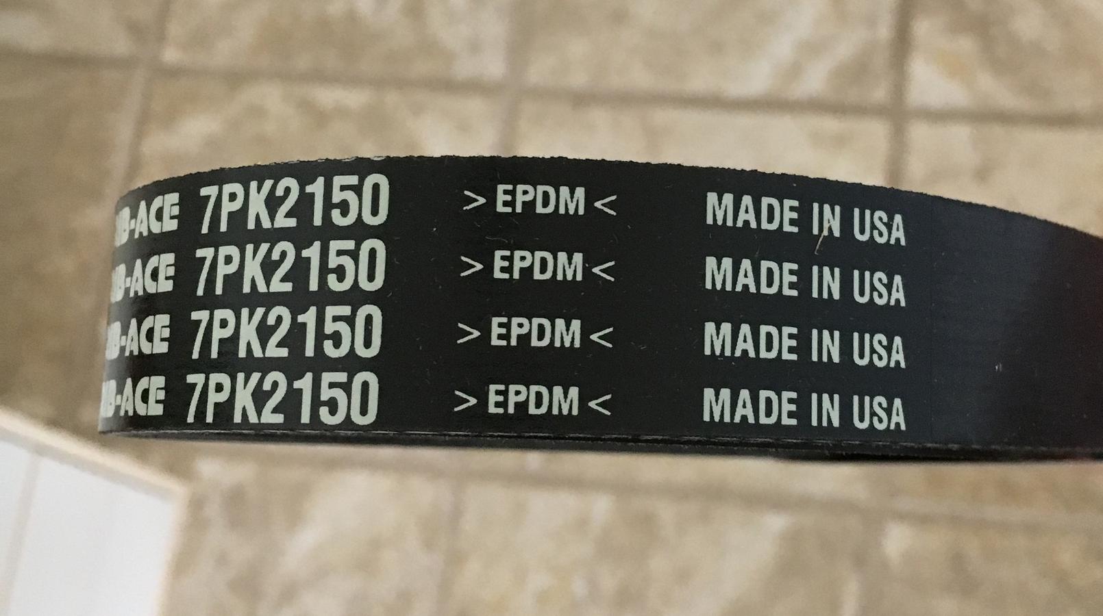

I got my belt from Amazon. They canceled my order once but I finally got it in hand. Length is as stated when roughly measured with a "meter" stick. About $12.
