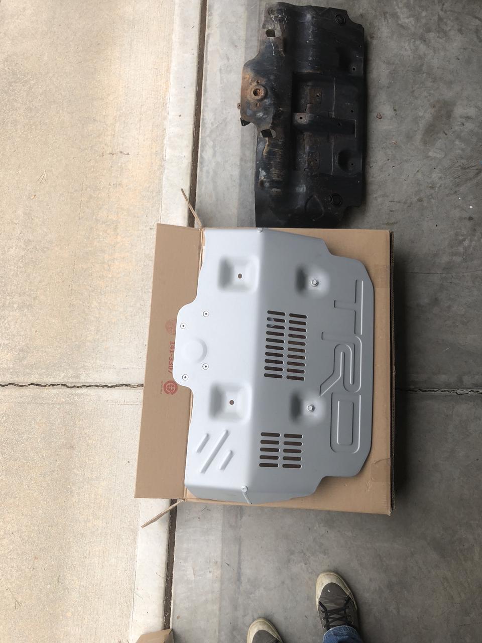

Hi, wondering if the oem 5th gen skid plates fit without issue on a 4th gen. My front skid plate is pretty rusted and it seems easier to find a 5th set.
Ok, it seems to me that no one has tried this.....
Well I guess I will be the Guinea Pig!
I believe there is some modification that I will need to do like longer bolts but I will be giving this a whirl this week. Please if any one here knows something please let me know.
:popcorn:
Not OEM, but per RCI when I asked (someone near me was selling their 5th Gen stuff), the transmission, transfer and fuel skid fit but need the 4th gen mounting hardware. The front will not fit at all. To me, that means OEM will not line up properly.
It’s most likely not a direct bolt on, but that doesn’t mean it won’t work if he’s willing to fab up some different mount brackets or spacers. Probably not worth the trouble though when you can buy a nice RCI set or other that will just bolt right on with no drama. I think if I was able to get the TRD one for free, or very cheap I’d work with it though just as a fun project, but I’d never order a new one without knowing for sure I could make it work correctly. If it’s not very solidly mounted, it will be useless in actual function, just be for aesthetic purposes.

Good luck bro. I was planning to try this out like I said earlier.
Probably easier to just start with a piece of sheet metal if you wanted some diy time.
I think all you're going to end up with is a destroyed 5th gen TRD skid plate. It's not even remotely close to the 4th gen plate.
Maybe try being supportive or not say anything at all. He's gonna give it a shot either way so maybe it'll help one way or another.

Let us know how it goes!
Thanks to you all! [MENTION=124959]Runn4est[/MENTION] thanks for that. I am currently taking some measurements and see what I will be able to do and see if it will be at all worth it. If not I still will post those measurements and maybe someone that has access to doing some fab work would be able to get it done. [MENTION=3312]tv4184[/MENTION] thanks for that support, I was at the dealership and they had one so I thought "what the hell, Ill give it a try".

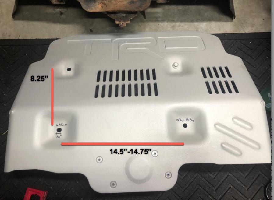

Another update, I have done the measurements and it looks like things are fitting fine however I need to now do the measurements with the skid plate under truck and aligned. The skid plate its closer to the frame by 1/4" and also the tail piece sits about 1.25" back from the stock so don't know how that will align with a RCI mid plate kit so need to assess that.
Measurements of distance shows that the holes are in a perfect square of L(14.5-14.75") x H(8.25") with the bolt holes on the right being sliding holes of a .25 difference.
Keep you all posted. Here are the measurements for now.
Any updates on this? Did you get it to fit?
