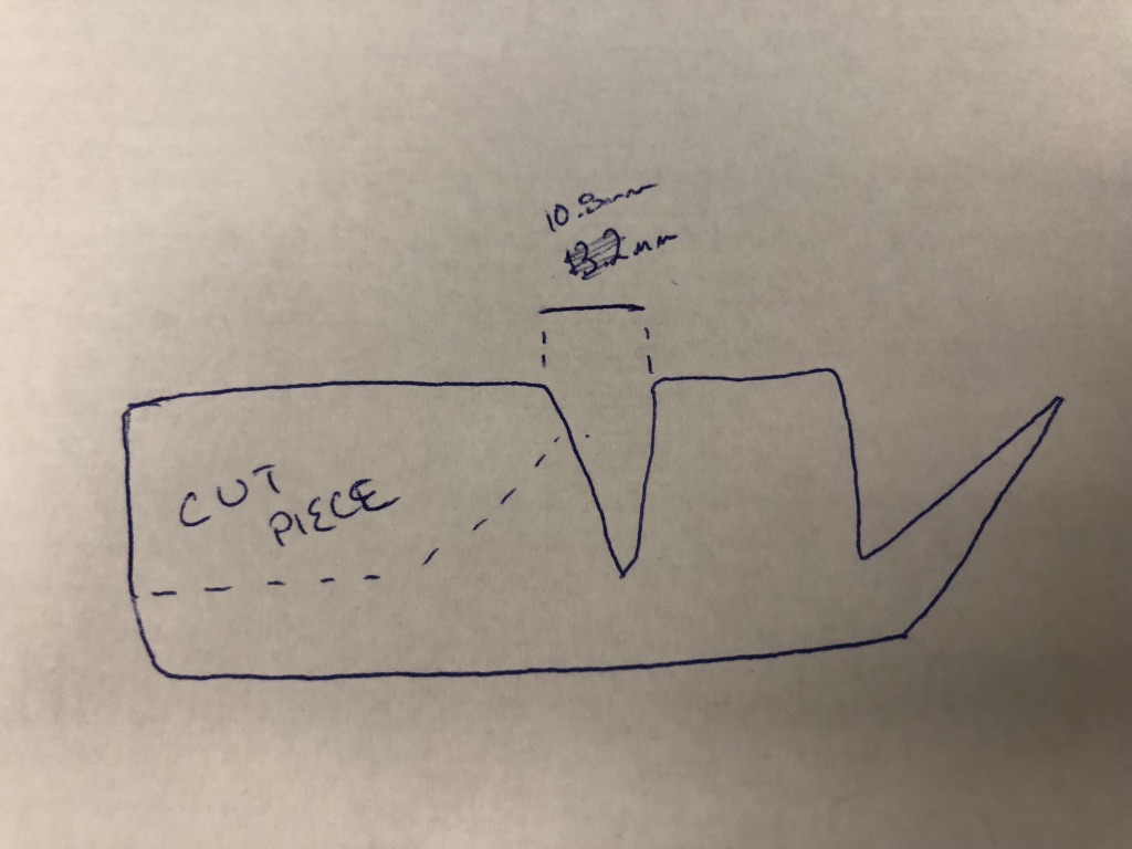

Ok! sorry for the delay had other obligations that took priority but sorry to keep you guys waiting.
So, after taking those measurements the next thing to do was to then take the measurements for the sides that needed to be cut. After assessing those measurements, I then attempted to see how it would fit and found that the strength of the plate would not be the same as some of the aftermarket plates that are available i.e. RCI.
So yes 1 point to those that told me so but don't know unless you try. So it is doable but with the cutting and also having to get a bracket for the most rear part of the plate, it ends up to be more trouble then it is worth to go further.
