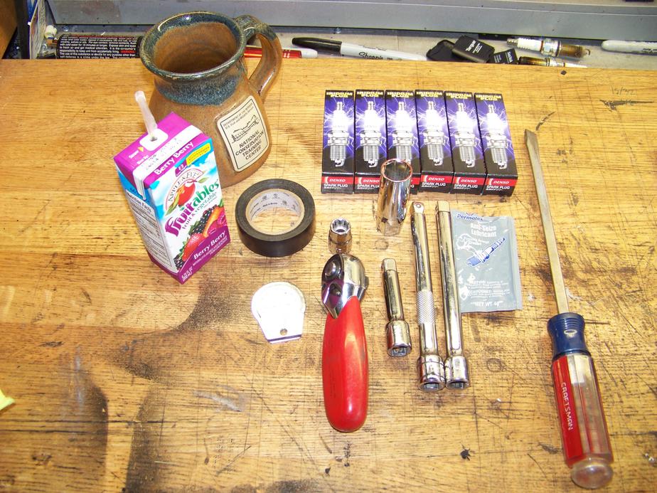

5th Gen Spark Plugs- Photo Tutorial. So easy a 6 yr old girl can do it...

You can see that plug here, at the top of my workbench- it's all black around the bottom...
