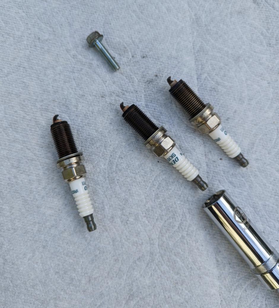

2013 SR5 @ 125k. When I pulled the old plugs, the passenger side plug threads had just the standard light crud on them, but driver side had oil on the threads. Worth any significant concern? No noticeable engine issues.
