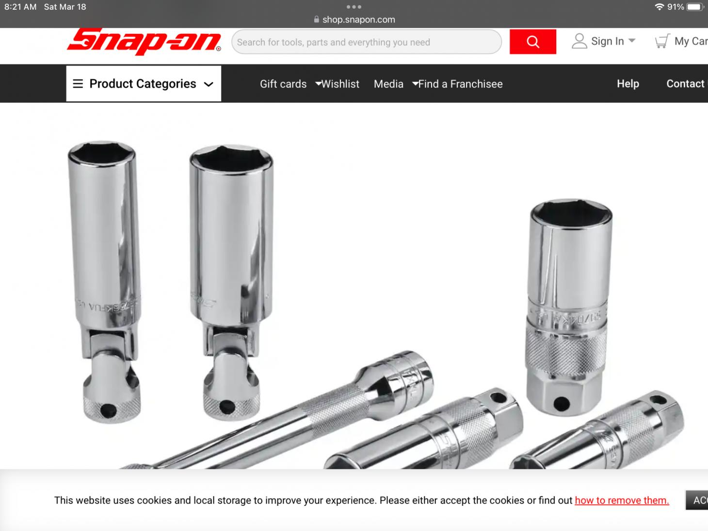

The swivel is essential to avoid cracking the porcelain. Im cheap by nature so I went shopping at ebay. Found a nice used snap on spark plug socket for $25. Love it. Magnet inside holds the plug and the swivel work great.
But make sure the BB on the extension goes into the socket where the hole is. Otherwise it can pop off. If there is no hole, drill one
