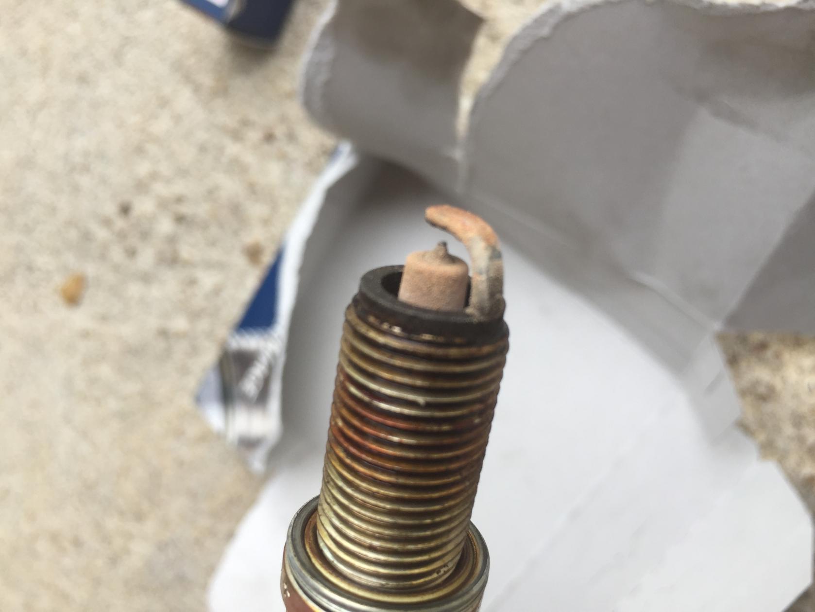

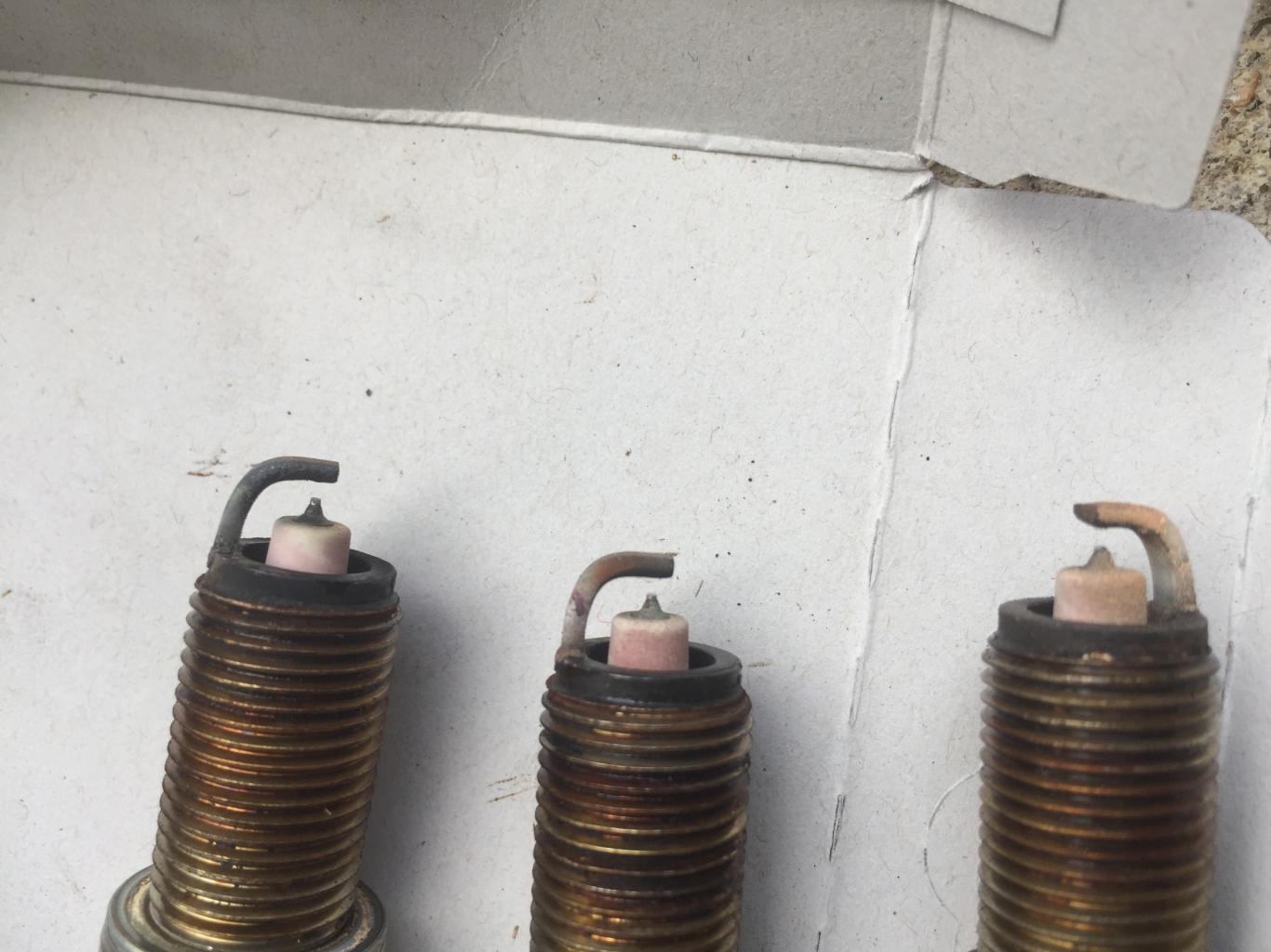

Not sure why the heat ranges are all over the place, but my 2015 Trail calls for heat range of 16. DENSO SK16HR11. Using significantly different hear range plugs may cause issues in the long run for somebody, especially since going up or down is different for different brands. On our air cooled bikes, we'd change the plugs based on season and riding locations.

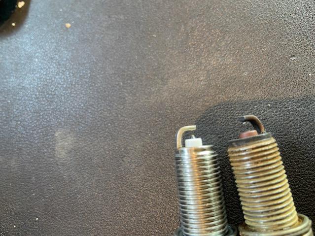

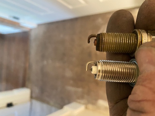

Life intervenes and I was delayed about 20K miles from replacing the spark plugs. 2014 SR5 is now at 260.5K miles. Most of the old plugs were tough to get out, like it took major force. When I looked at the plugs, it almost looked like they had swelled some and the tips had worn significantly. Engine had never skipped a beat. New plugs went in east with the anti-seize on them.

The last image shows EMBLE stamped on the metal shell of the old plug. Are these the words, "ASSEMBLED IN THE US WITH FOREIGN CONTENT? The old plug ceramic insulator appears to be shorter than the new plugs. In both images the ground electrode chip appears different. Are the new plugs genuine Denso? These subtle differences may indicate counterfeit spark plugs. The following links show how to identify counterfeit parts. I think most of the SK20HR11 plugs listed on Amazon are obviously counterfeit.

The last image shows EMBLE stamped on the metal shell of the old plug. Are these words, "ASSEMBLED IN THE US WITH FOREIGN CONTENT? The old plug ceramic insulator appears to be shorter than the new plugs. In both images the ground electrode chip appears different. Are the old plugs genuine Denso? These subtle differences may indicate counterfeit spark plugs. The following links show how to identify counterfeit parts. I think most of the SK20HR11 plugs listed on Amazon are obviously counterfeit.
https://www.denso-am.eu/media/1374174/identify-counterfeit-denso-spark-plugs-white-paper-_pk3.pdf
Toyota Counterfeit parts EXPOSED! - YouTube
"Are these words, "ASSEMBLED IN THE US WITH FOREIGN CONTENT?"
Yes
Whether they were counterfeit is a moot point now, as they are no longer in the engine and they went 140K miles. The ones in the pics were the two worst for wear.
Yes
I mistyped a word in my post. I should have asked, "Are the NEW plugs genuine Denso?' The old plugs were genuine. I was noting significant differences between the new spark plug and the old genuine plug. Your thumb covers the metal case and ceramic of the new plug, so I cannot be certain if the new spark plugs are genuine. Did you buy them at a Toyota Dealer?
