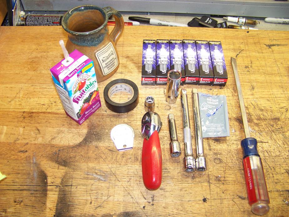

5th Gen Spark Plugs- Photo Tutorial. So easy a 6 yr old girl can do it...

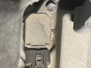

One thing I would just like to add, get a vacuum cleaner and suck the dust/debris around the coils first before taking it out. Awesome post btw, much appreciated
