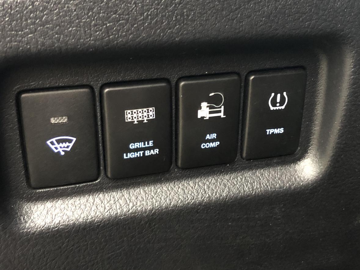

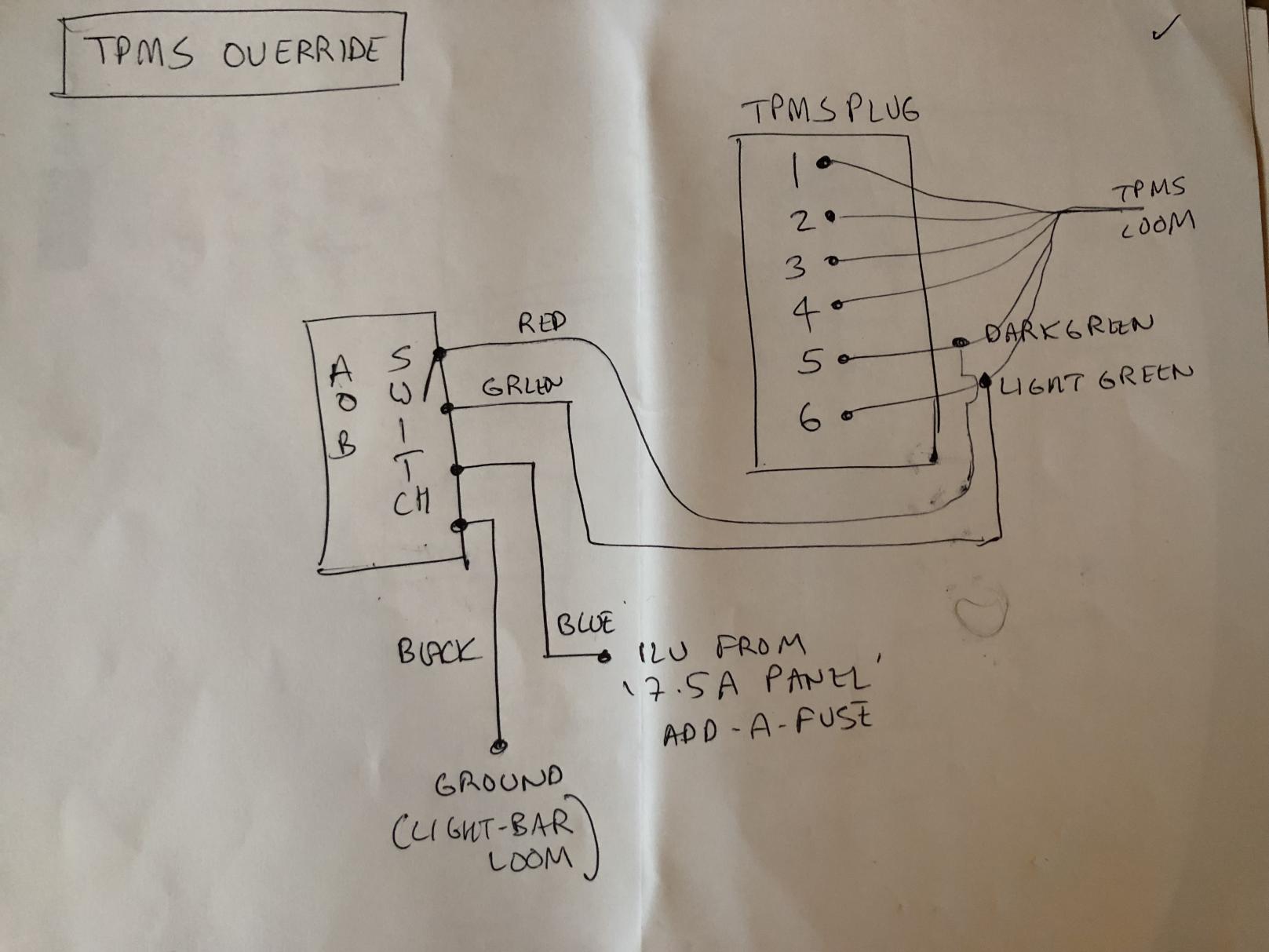

Totally works - I bought a TPMS switch from AOB and put it in a switch blank , connected up as posted earlier and I have a switchable light. - will post photo if anyone is interested
Please post a photo. I am interested in this switch and where you located your install. TIA
here you go - wiring diagram & switch layout

Correct but why wouldn’t you - simple to do & at night it’s a great reminder of all th hard work that went into installing it!
