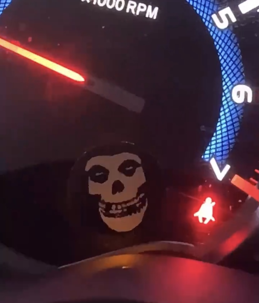

Finished this mod faster then a school boy on prom night.
