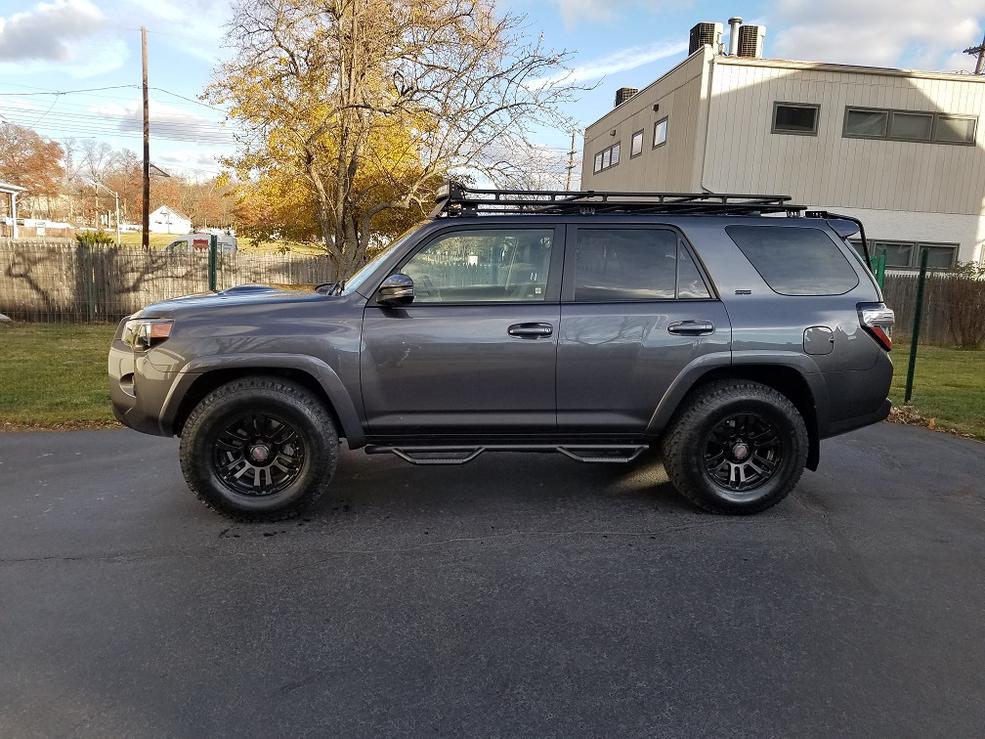

not a common choice on the forum, MB TKOs with Chaos center caps wrapped in 285/70/17 General Grabber AT2s. No lift yet.

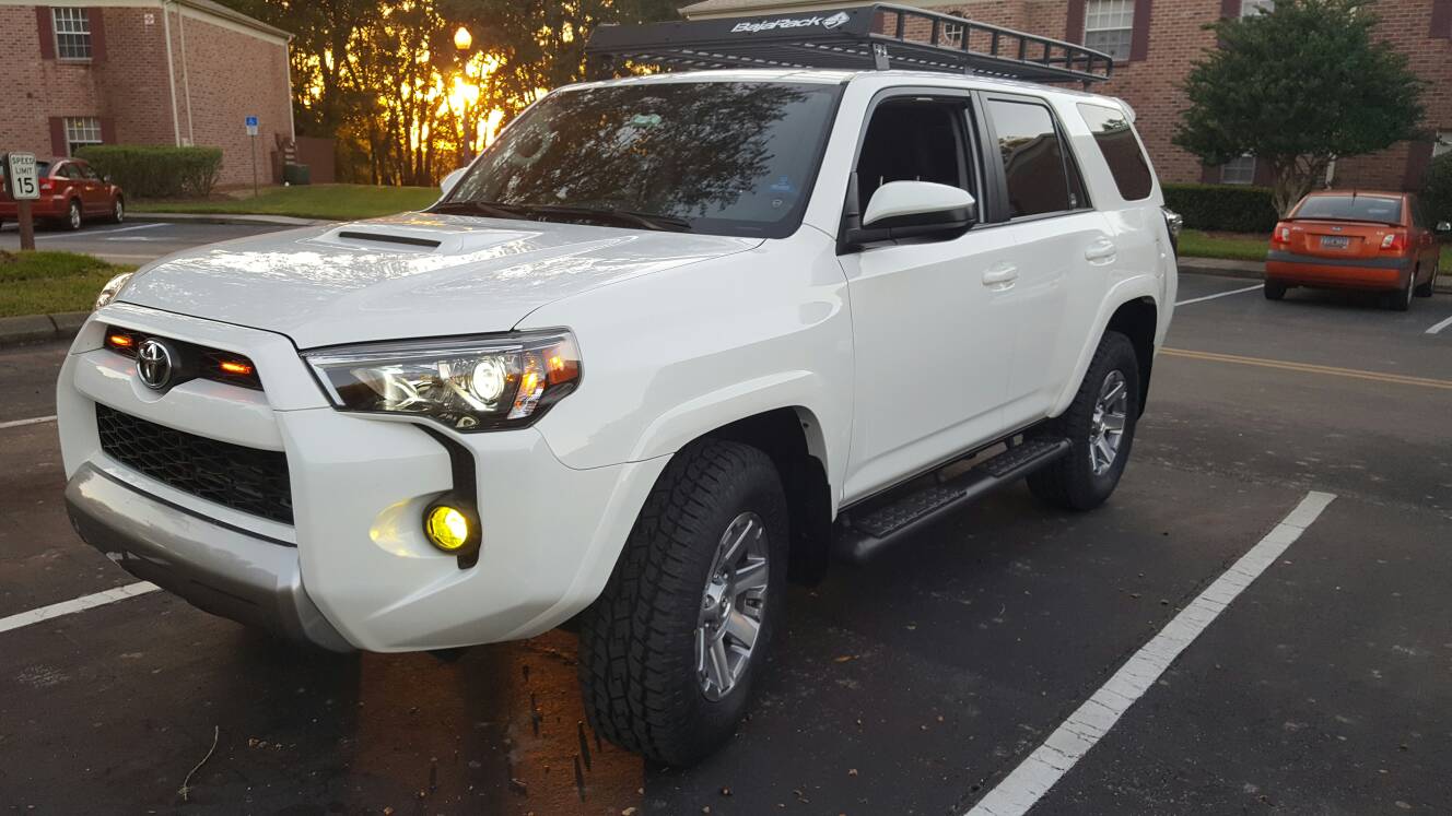

My 285/70r17 Yokohoma Geolander A/T G015s don't rub at all with my 2015 SR5 with stock wheels (7" wide) and 3" toytec kit. I didn't expect that...

I understand that. But [MENTION=131471]CF_Machete[/MENTION] is running no lift. Not sure on the back spacing on those rims. But that's a good fit!!
I actually mounted up the 285/70s prior to the lift.. No rubbing when turning, but I wouldn't want to do any flexing, as there would likely be rubbing in the upper portion of the wheel well.
And rubbing??
rubbing in left reverse at full lock and mild rubbing at lock with flex. Daily street driving is no issue, but the fender liner mod is a band-aid. I'll have it lifted shortly.
The MB TKO rims are 17 X 8.5 -6

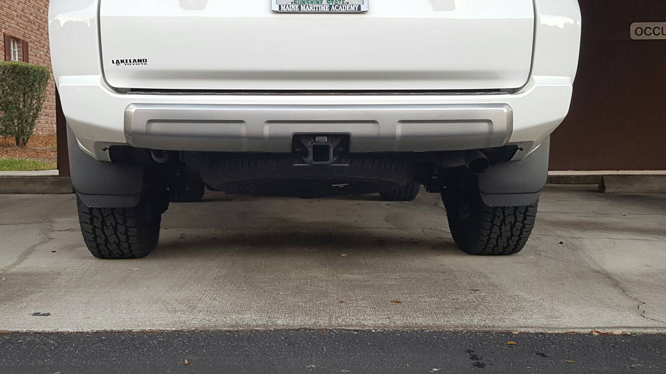

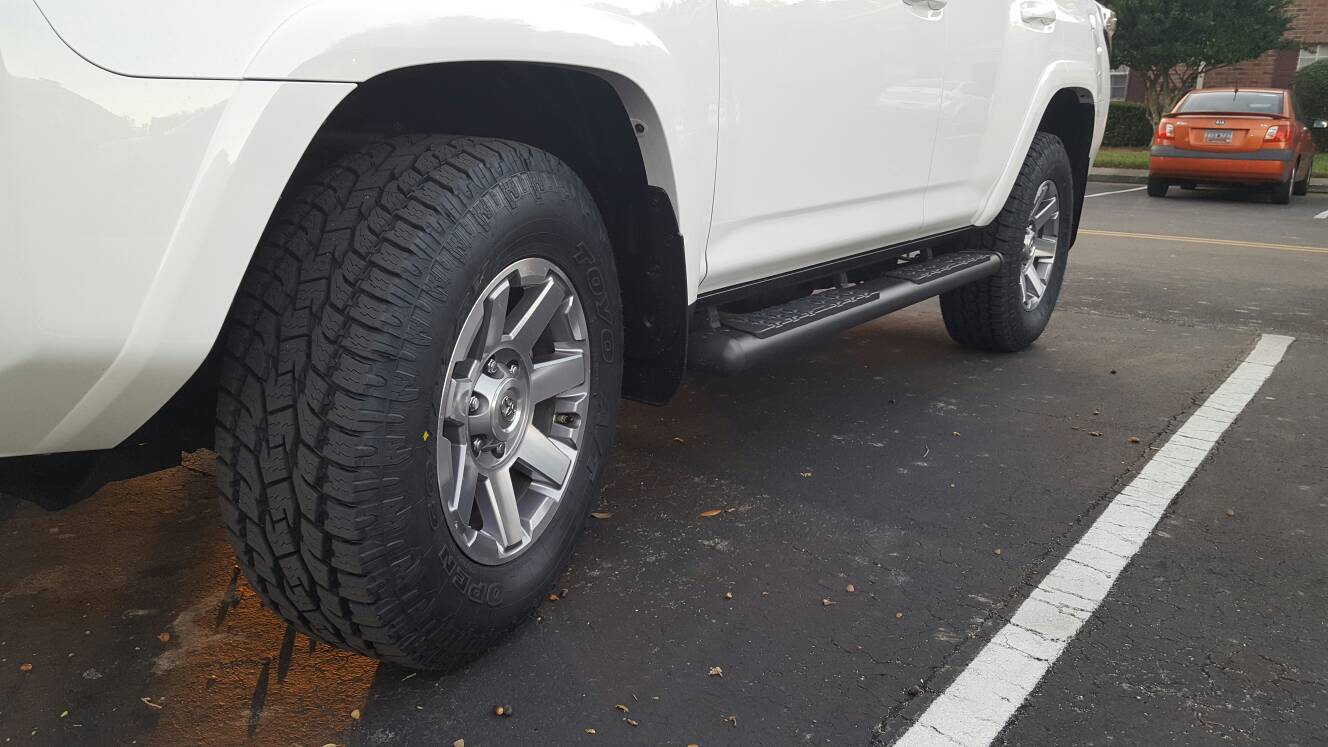

Went with Toyo ATIIs in stock size. I had the Toyo Open Country RTs on my Raptor so I stayed with the brand I knew. 20170112_173313.jpg20170112_173319.jpg20170112_173430.jpg

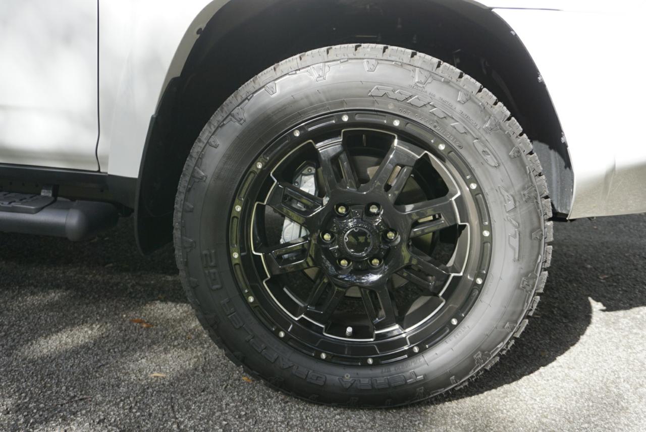

XP wheels
I've had my XP package for 2 weeks and really love these wheels.

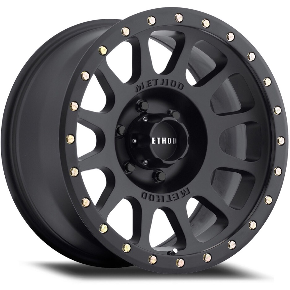

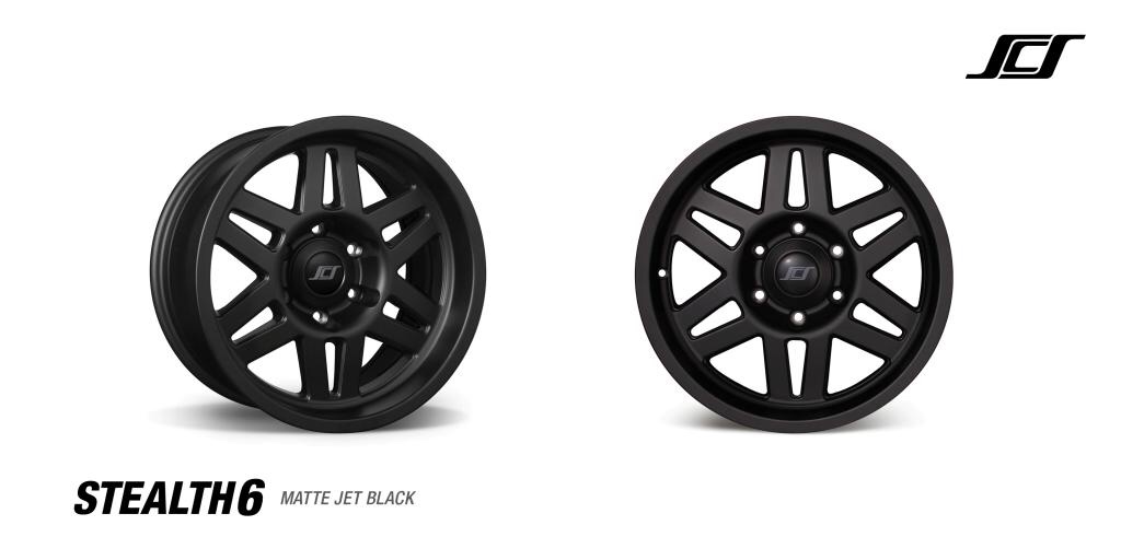

I'm about to lose my mind trying to decide which rims to go with.
Torn between Method Nv and SCS Stealth 6
Stealth 6 is -10 and NV is +0
