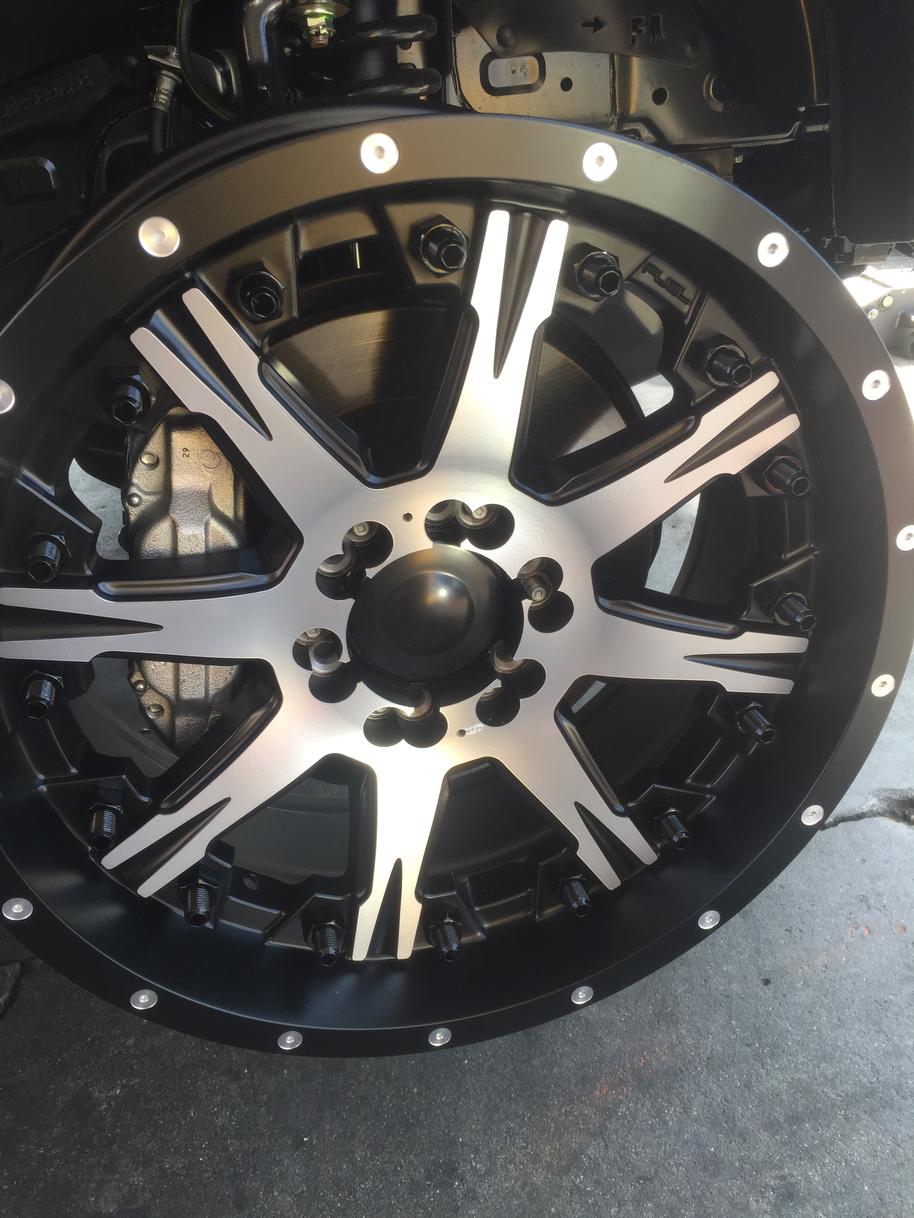

Fuel Assault wheels

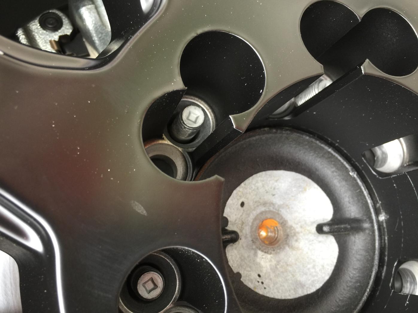

I got some Fuel Assault wheels. The guys at good year won't mount my tires because there isn't enough of the stud sticking out to thread the lug nuts on. Does anyone know if the et extended lug nuts will work or do I need to get the longer studs? I did research and found that I may be able to do either, but just looking for anyone that has experienced this and what you went with and the part numbers if possible. Already ordered the et lug nuts but if those don't work I'll order the longer studs. I have a 2016 SR5 so I'm not exactly sure which studs would work. Sorry for the noob questions but it's frustrating having the new wheels and tires just sitting in the garage. Thank in advance!

Where did you buy these wheels from? If it was me, I would return the wheels and tell them that the length of available thread on the wheel studs is not sufficient and quote Goodyear. I personally would never run wheels with universal lug patterns on a wheel. That's 12 holes where there should only be the six mounting holes necessary for your 4Runner. I think they made the mounting location for the lugs extra thick due to removing so much material for the extra set of universal lug pattern. 12 holes where there should only be 6 holes in a critical strength area of the wheel right next to the hub. Hope this makes sense.

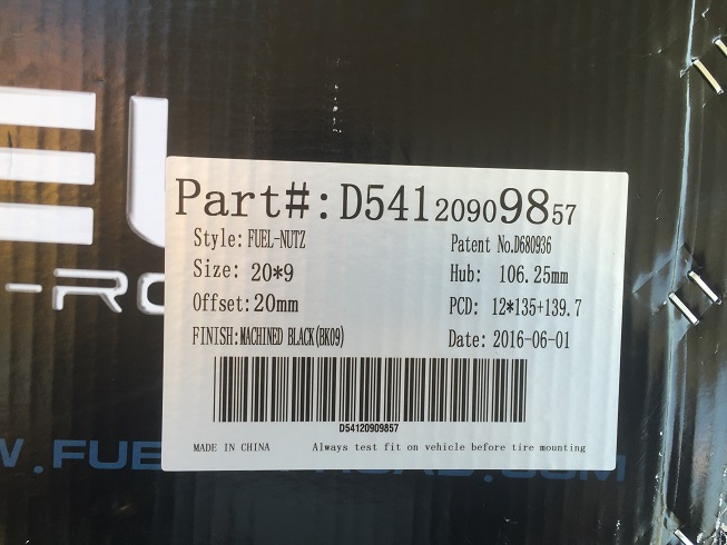

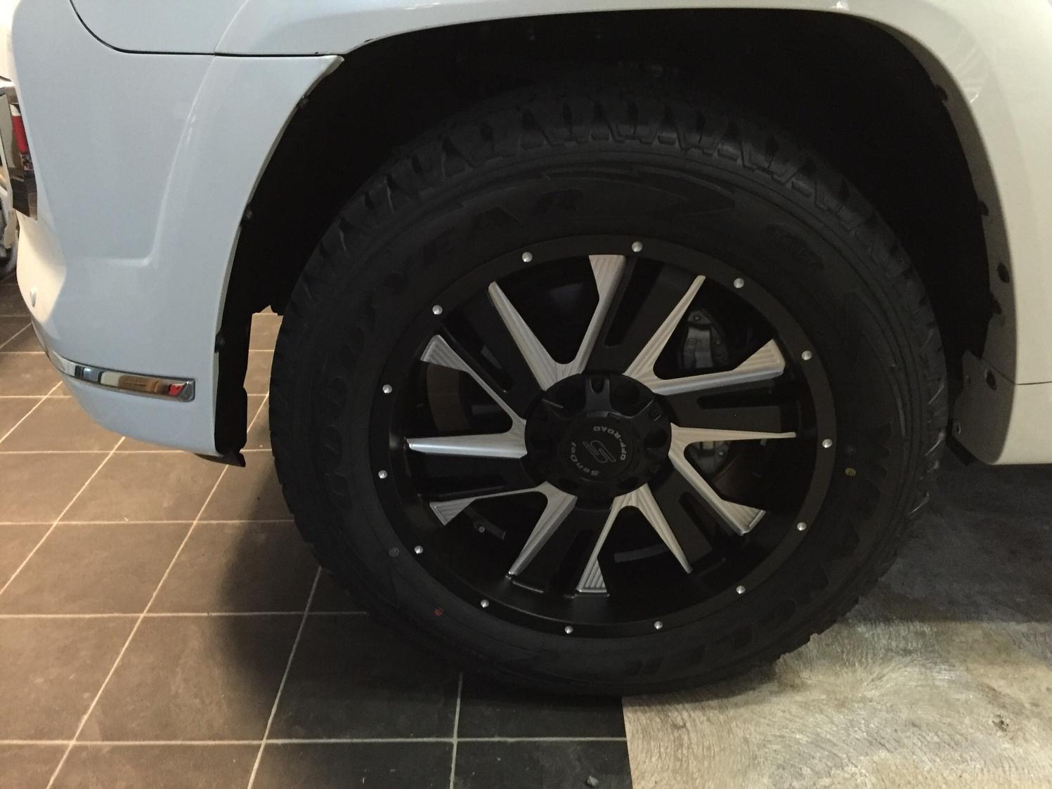

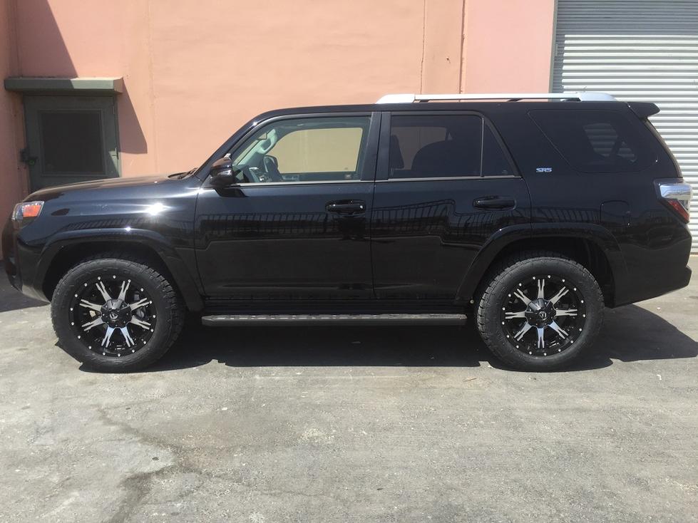

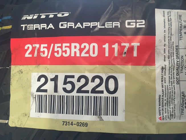

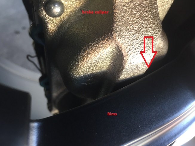

So last weekend I became a member of the 5th Gen T4R’s.. I ended up getting a 2016 4x4 SR5 black 3 row seats ..
Just Wanted to share my wheels and tire package with you guys ..
20x9 with +20mm offset / 275/55/20 Nitto Terra Grapplers G2
