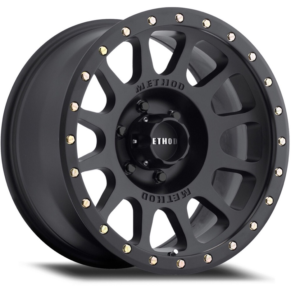

I love methods but I know if you decide to get them, you should also invest in some hubcentric rings to prevent potential vibration. 108 to 106mm.

Toyota's have hub centric wheels. Methods are lug centric wheels with a 108mm bore, and Toyota's have a 106mm hub.
While 2mm doesn't seem like much, some people have reported vibration while driving with Method wheels. Many companies make rings to sit behind your wheels that will convert your 106mm hub to a 108mm hub, and therefore should eliminate any vibration issues with Method wheels.
Good luck with your choice. Method wheels are sharp!

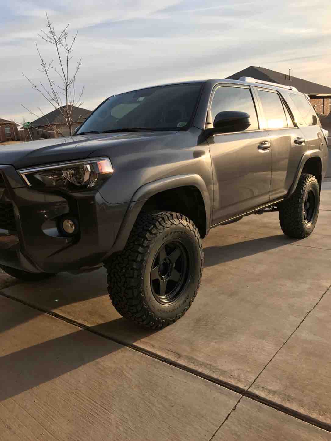

Ended up going with VTX Outlaws!

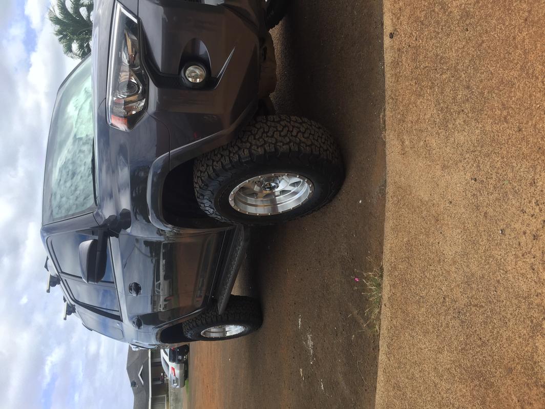

OK Here's Mine
- NV Wheels 17x8.5
- BFG Ko'2s 285/70/17
- Toytec Boss Kit with 2.5 reservoir rear shocks, Total Chaos UCA's
- Photo(s)
- Body mount chop: No
- Do your tires rub: Not after the lift

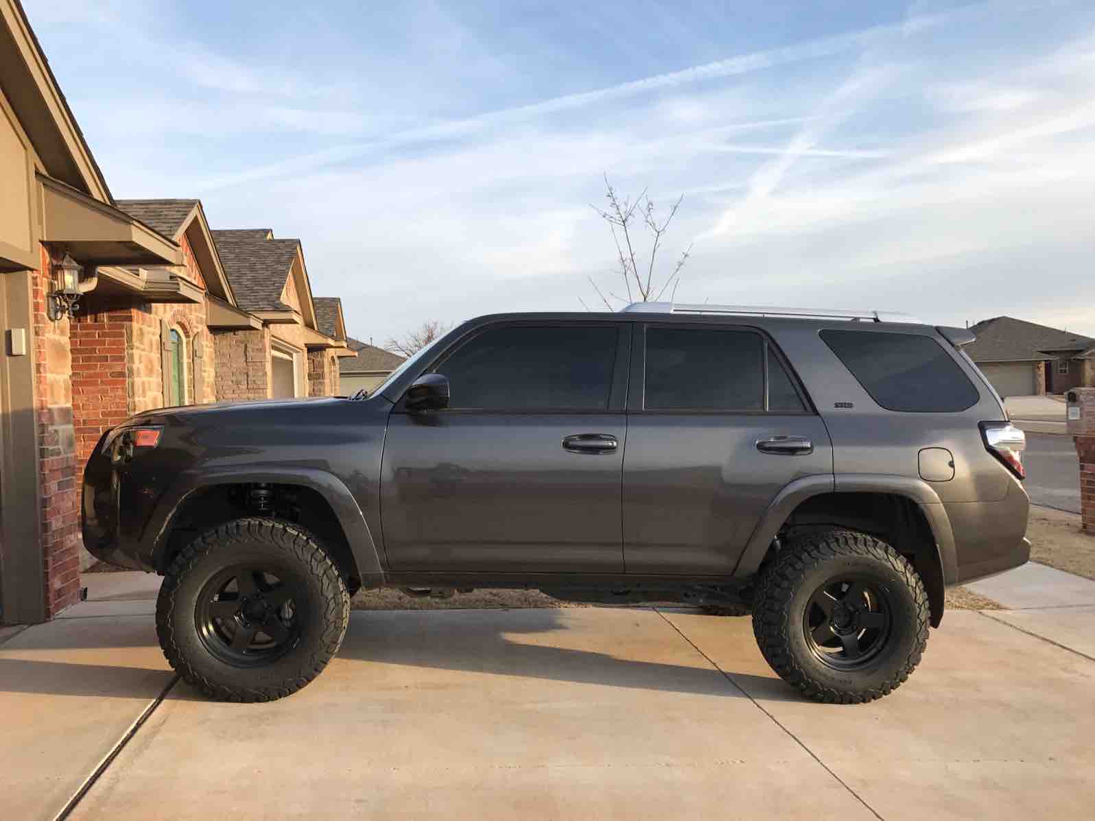

Method wheels 17x9 -12
BFG KO2 285/70/17
3" Toytec stock UCA's
Body mount chop: no
Do your tires rub: yes trimmed mudflap and moved over inner fender with some trimming on bumper next to inner fender no rub now.IMG_0251.jpgIMG_0252.jpgIMG_0253.jpgIMG_0254.jpg

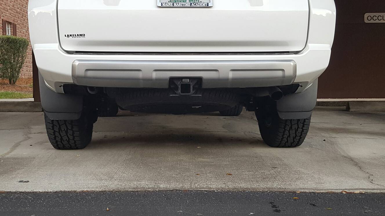

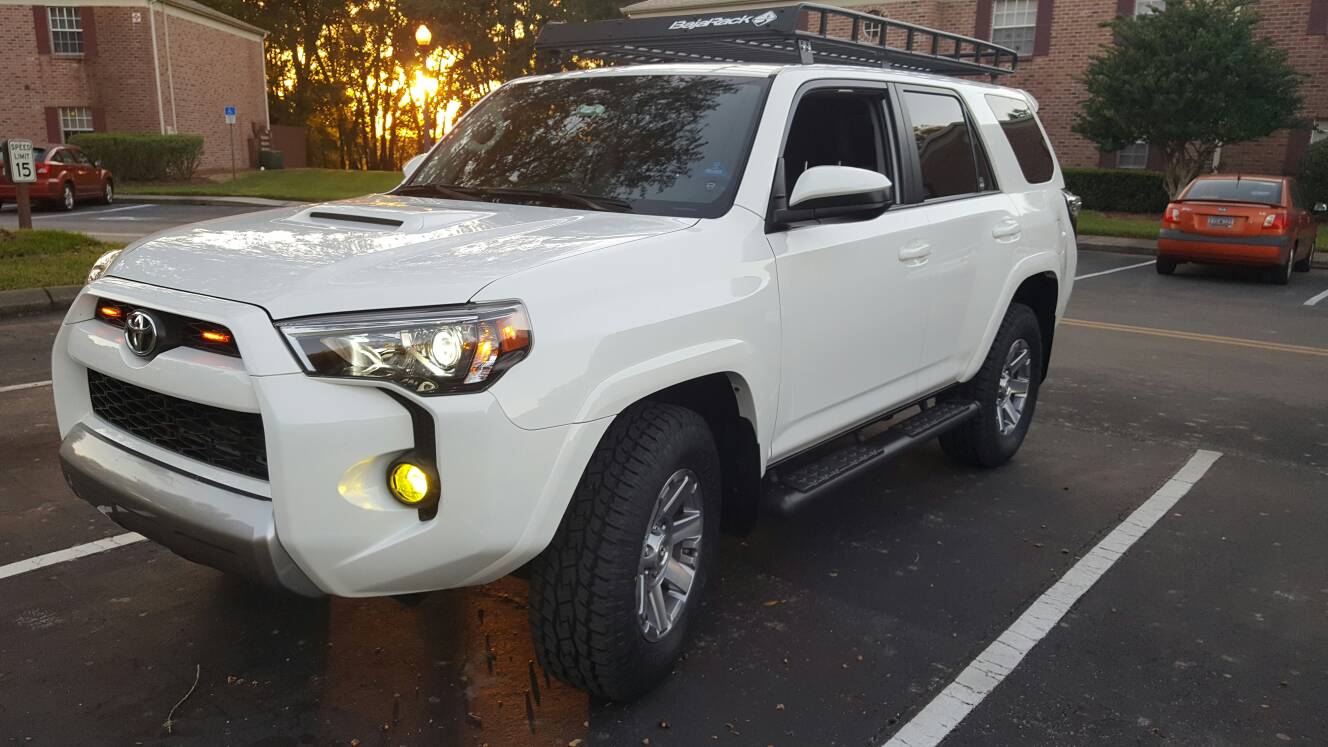

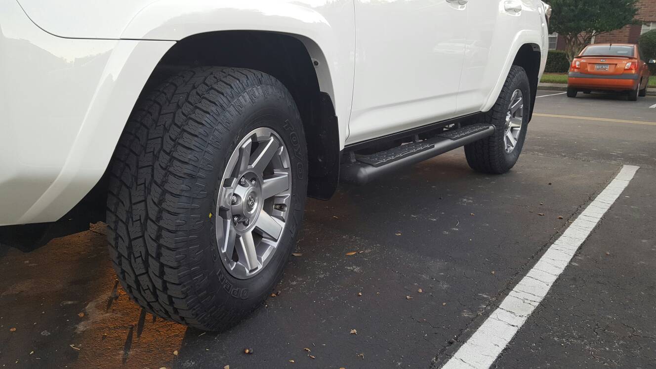

2016 SR5P 4WD Super White
Bilstein 5100 @ .85
Nokian Rotiiva AT 265 70 17

Previous posters have stated that the 265 70 R17 did not make a difference vs. the stock limited pizza cutters. In my opinion this is not true at all. My 265 KO2s completely transformed my 2015 4x4 4Runner Limited into a much meaner, cooler vehicle. Now to contemplate a lift.
Note: Even with the 265s I do get a very slight rub on the front tires when in reverse. Looks like it is rubbing on the part of the plastic wheel liner closest to the bumper and should not be hard to heat up and deform.
I'm getting the same rub on my 2016 Trail with the same tires. My wheels are American Racing AR-172s. Any luck with the heat and remold, or did you have to shave the lower edge of the front bumper? BTW, mine is rubbing only on the driver's side and only when backing up with the wheel cut to one extreme direction (clockwise).

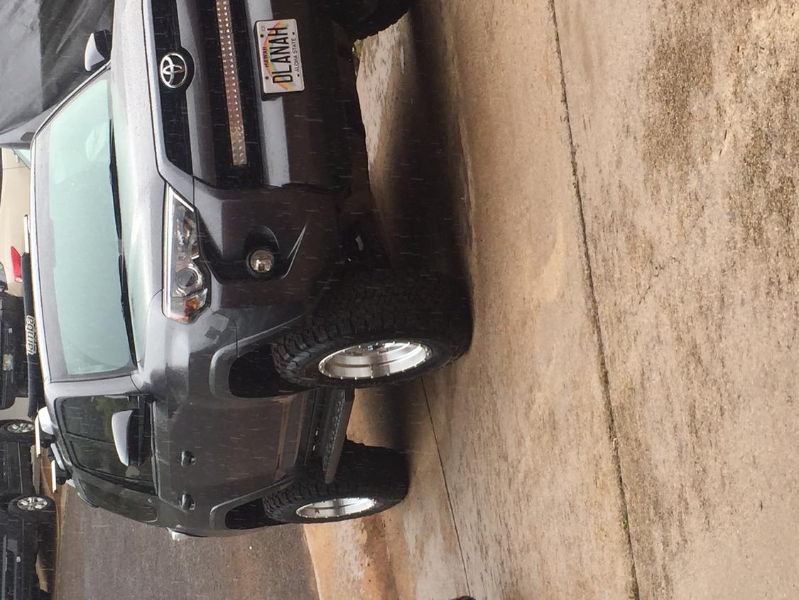

IMG_2616_zpshinbvmzs.jpg~original
Stock suspension
17x8 -10 MK6
P265/70/17 Falken Wildpeak AT3W
Had to remove the front mud flaps and push the front fender liners in and trim the bottom lip of the front bumper to eliminate rubbing.
