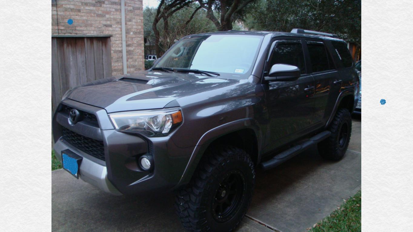

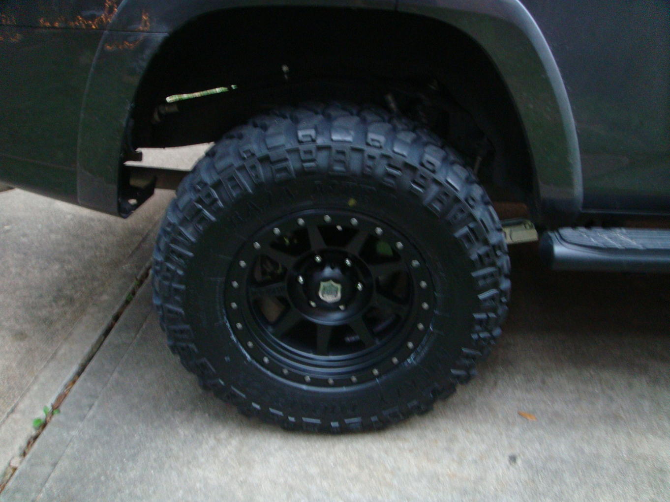

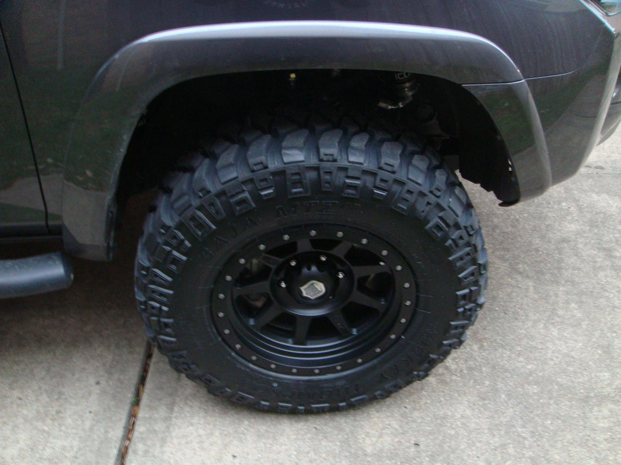

got some new tires and wheels today. Mickey thompsons mtz p3 285/70/17 with Deegan 38 Pro 4. -12mm offset 17x9 with 4.5 BS no rub whatsoever with mudflappers removed on my icon lift.

Those Mickey Thompsons look great, don't hear a lot about them on the forum. Let us know how they run!
been driving for a few days now. and they're not any louder than the goodyear duratrac. i like them so far. don't now if they'll get louder as they wear.

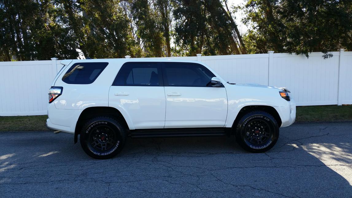

Trd pro wheels
firestone destination at p265/70/r17 outlined white letters

Specs on your suspension? Any rubbing? Also specs on the wheels.
It was rubbing slightly with 285 but after I moved the fender liner forward all the way I can, no more rubbing full lock forward or reverse. Not sure about offroad though. I have toytec 3 inch lift kit and light racing UCA.
