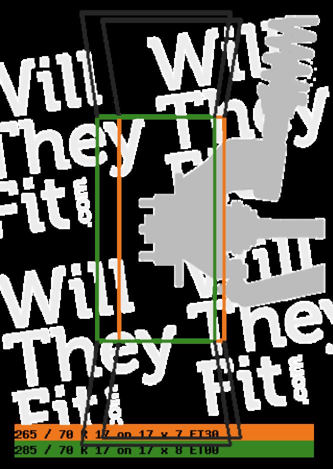

I’m terrified of having to do a BMC and becuase of that I’m waffeling between 275’s & 285’s. My prob is I really like the Nitto Terra Grappler G2s P-metric. They aren’t available in 276. I ran the online calculator using the numbers provided by FN wheels for the 17x8 six shooter & 285’s. Where as the OEM 201’’ SR5 has 30mm offset the six shooter has 0?
It said - Compared to your existing wheel, this new wheel will have an inner rim which is 17.3mm further away from the suspension strut.The outer rim will poke out 42.7mm more than before.
What do you think my chances are of needing BMC (like I said, I;m terrified of that)? If I may need it, would I be safe w/ 275s?If so, I’ll need to fins a 275 comparable to terra grappler G2 in P-metric.

I spoke w/ Dustin @ LH Wheels. He said he did this exact install numerous times (i.e. 2 1/2 front 2 rear, u a's) in a 211 SR5. He said "I gaurentee that set up whill need plastic trimming & no body mount chop.
