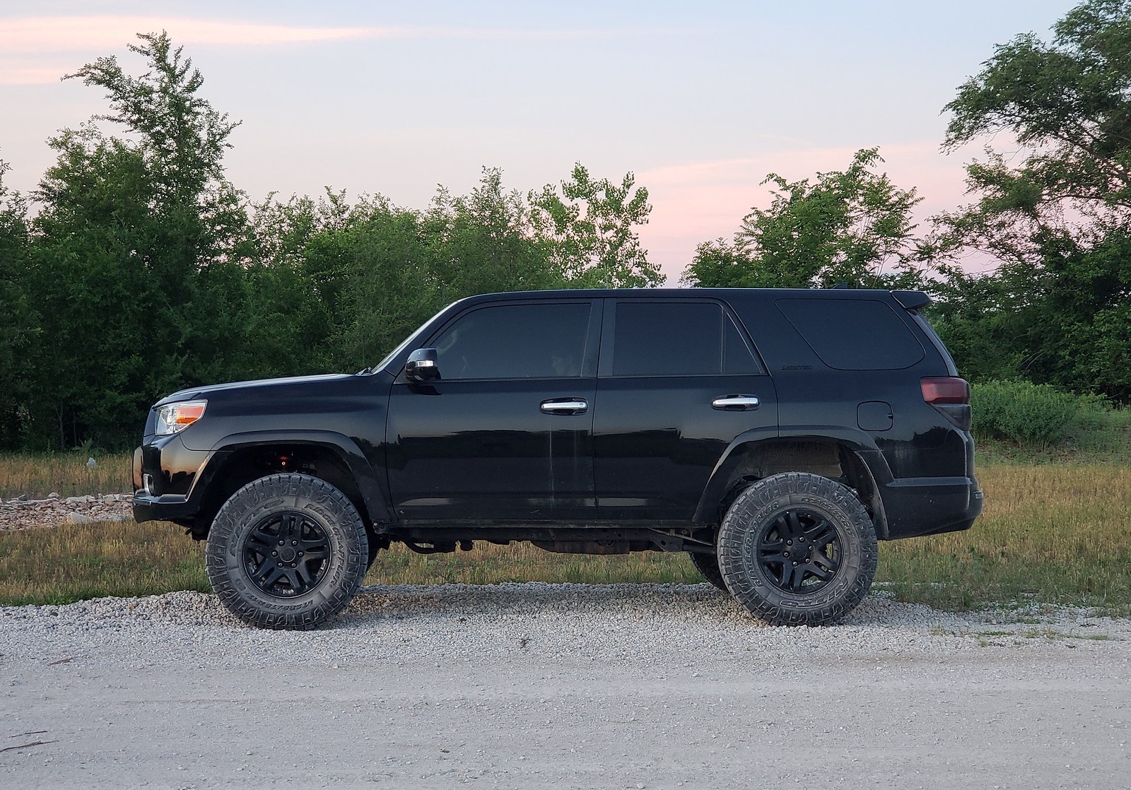

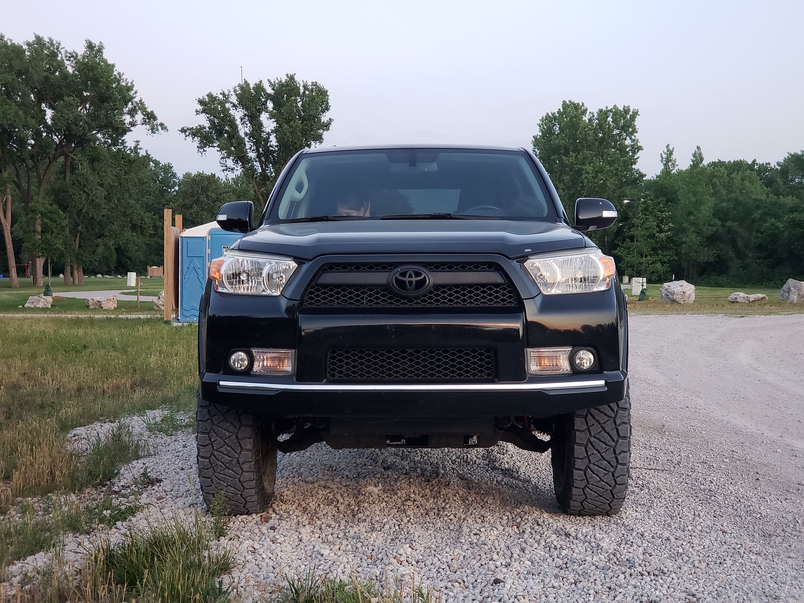

-FN Wheels Koenig Six Shooter 17x7, 0 offset
-Nitto Trail Grappler 285/75R17
-Toytec Ultimate with SPC UCAs
BMC
-Slight rubbing only in reverse at full lock when suspension compresses (a little more fender liner trimming will fix)
2010 SR-5, Toytec Ultimate lift with BMC, SPC UCAs, FN Six Shooters, 285/75R17 Nitto Trail Grapplers, SSO Sliders, RCI skids, CBI ditch light brackets, Yakima Megawarrior rack

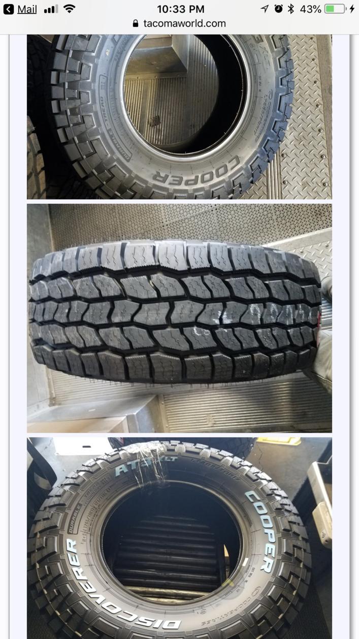

Saw these pics posted on TW tire and wheel section. Poster didn’t have much info other than these are new design for the Cooper Discoverer at3s. Side walls look good! Couldn’t find any info on the webs yet. Hopefully we’ll hear something soon!

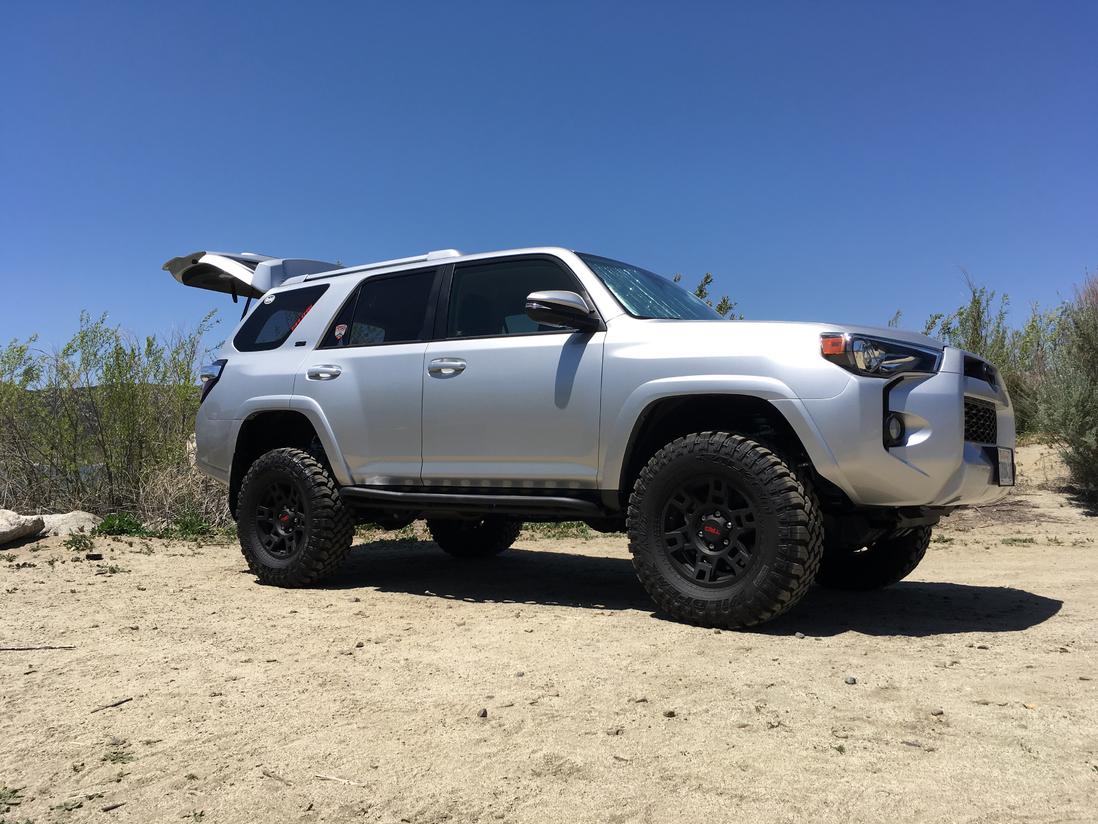

I think if you type in silver 5th gens. There will be many pics. But here is mine lol.

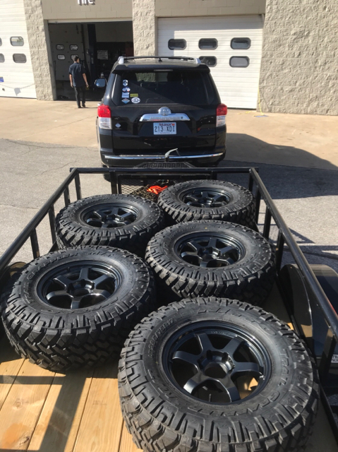

285/75-17 Nitto Ridge Grapplers
1st Gen Tundra Split 5-spoke wheels (7.5"; +18mm)
1.25in Spidertrax Spacers
Toytec Boss Performance (2.5 Extended Travel up front; 2.0 Remote Res. out back)
SPC UCA's
BMC and extensive trimming of the front bumper and splash guards
So far no rubbing front or back at full lock but I haven't flexed it yet. Was able to get over 4 degrees of caster on both sides.

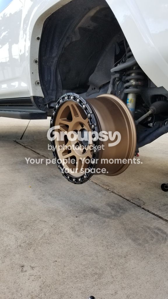

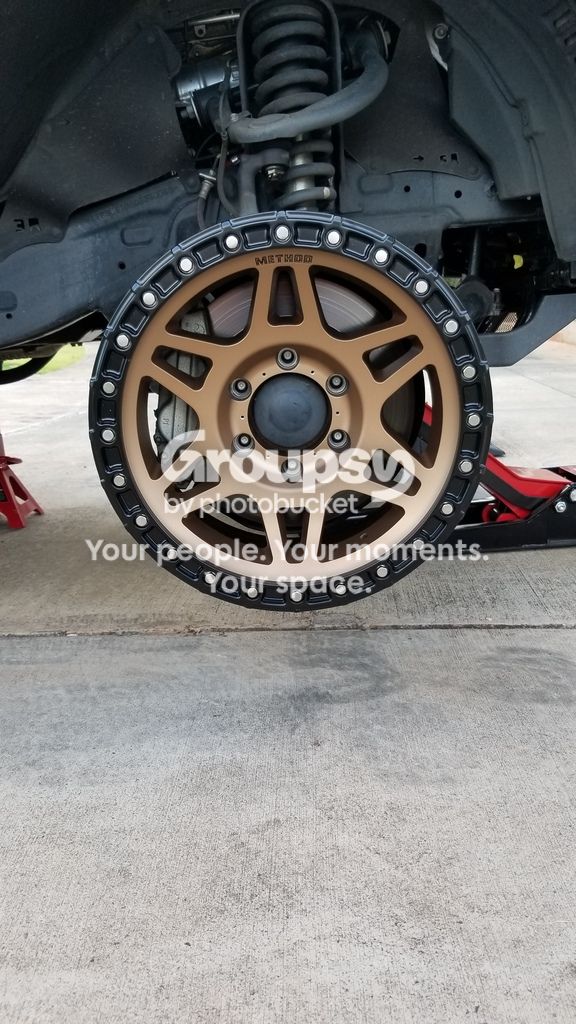

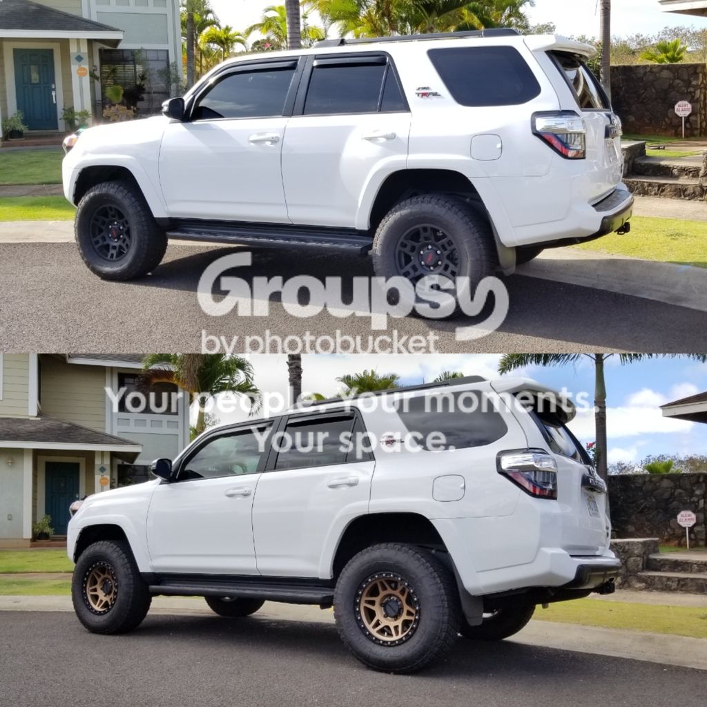

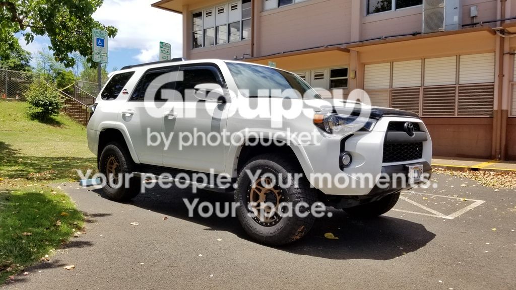

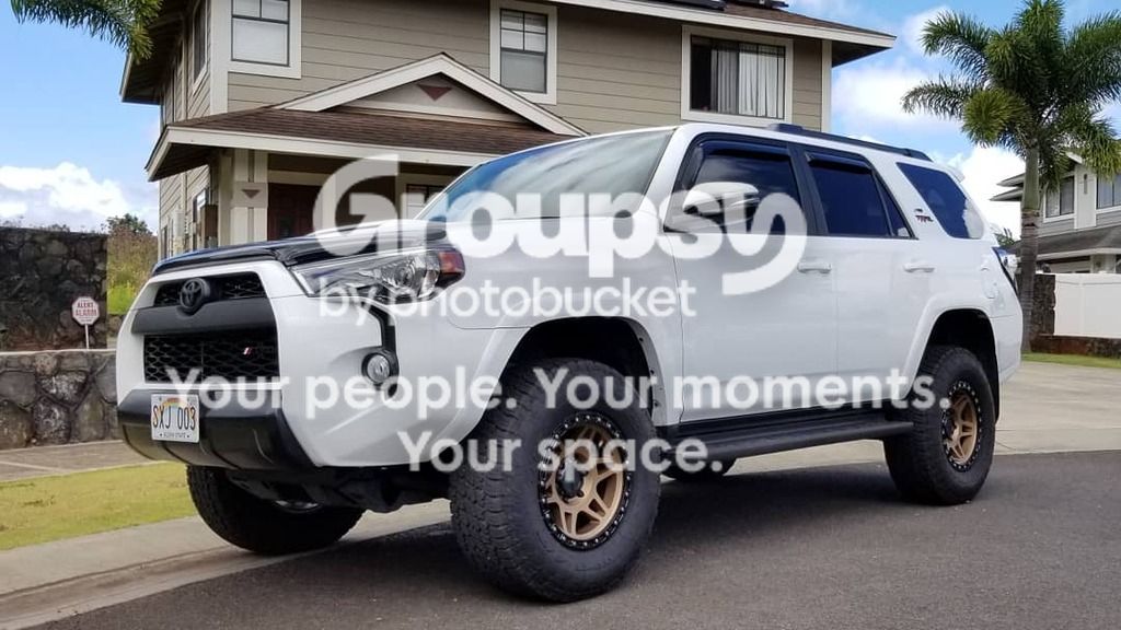

I went from the TRD Pro black wheels to Method Racing Wheels MR312 in a bronze color. Seems like everyone here has has the black TRD wheels, you would think they are the stock wheel. I think they are on 4 of every 5 new 4Runners I see lately.
My set up is 2.5 inch lift in the front and 1.5 in the rear using Bilsteins. I just recently bought SPC UCAs but have yet to install them. Everything aligned to factor spec with my set up and stock UCAs so far.
Wheels are Method Race Wheels: MR 312. 8.5 inchs with 0 offset
Tires are Nitto Terra Grappler G2 AT measuring 285/70R17
I did do a liner tuck and slight trimming of the front bumper (1/2 inch from front underside). Front mudflaps removed. Absolutely no rubbing whatsoever now.
Bronze is the new Black! LOL!
The before and after from black TRD Pro wheels to the bronze Method wheels:
