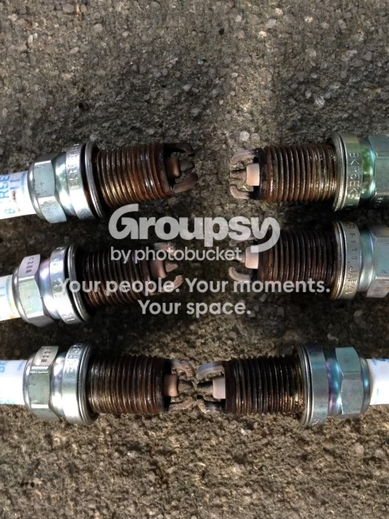

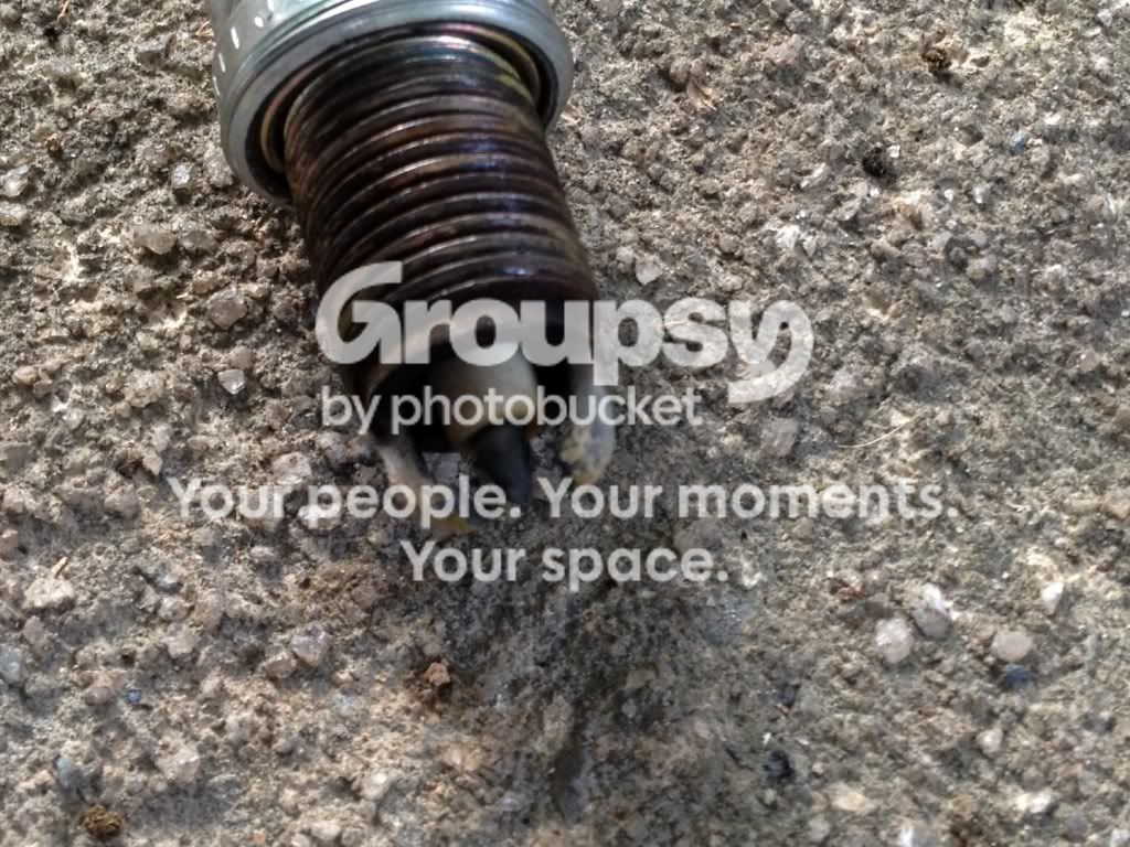

Pics of the plugs below. Believe they were needed.. and two wires fell apart when I pulled them off
iPhone152Large.jpg~original
iPhone150Large.jpg~original
