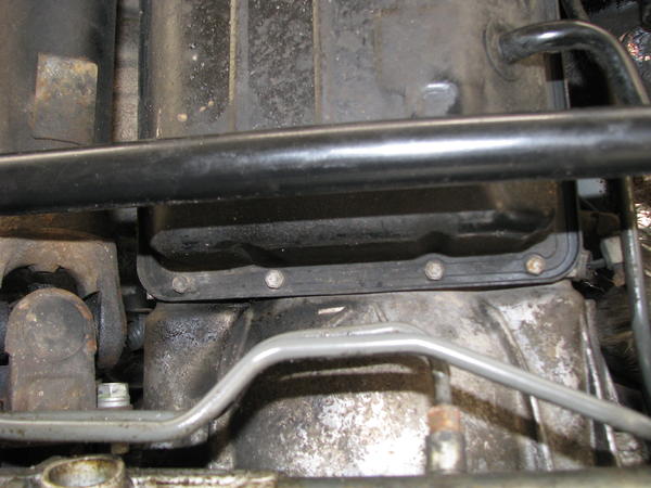

The cross membrane you guys mentioned about on the Trans...is that the same as the cross bar?
If I understand your question, the crossmember is the structure bolted to the frame on both sides see pic1:
poleclimber63-albums-engine+swap...-picture27732-underside-including-tranny-cross-member-2-small-holes.jpg
this pic is looking from the front with the front dif in the foreground, the tranny cross-member is the member with 2 smaller holes facing the camera.

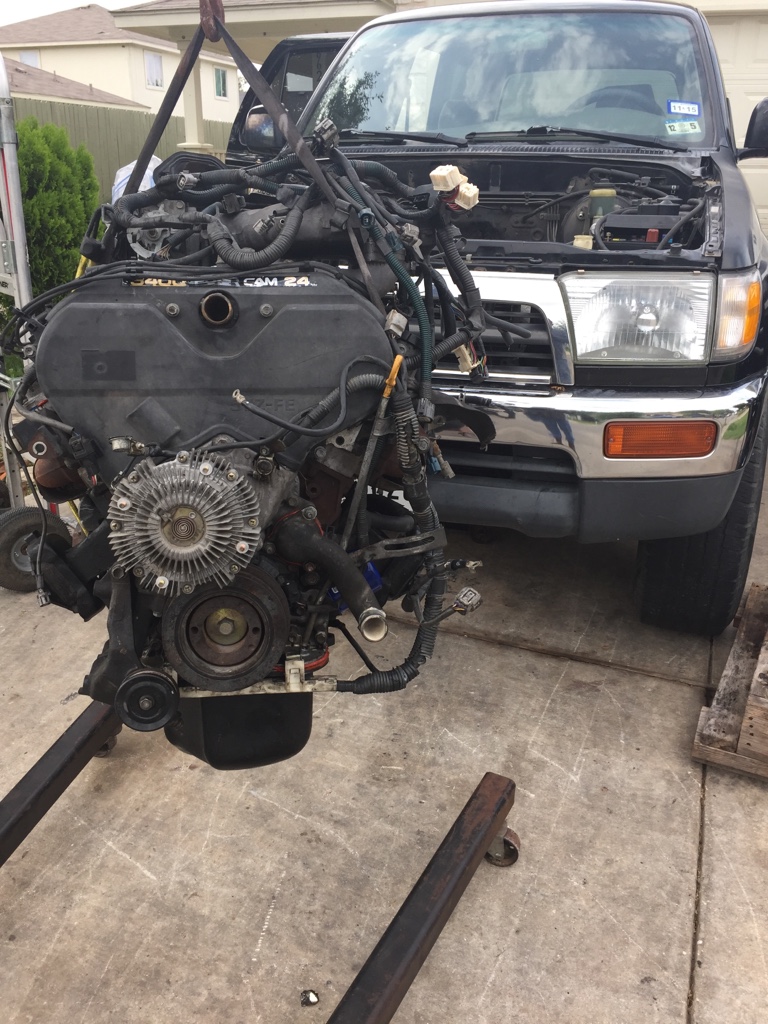

The second pic2 is where I inserted my block to hold the tranny in place with the engine removed. The bell housing is toward the bottom of the pic and the large bar is the front stabilizer bar which crosses under the tranny pan... the pan is towards the top of the pic.
