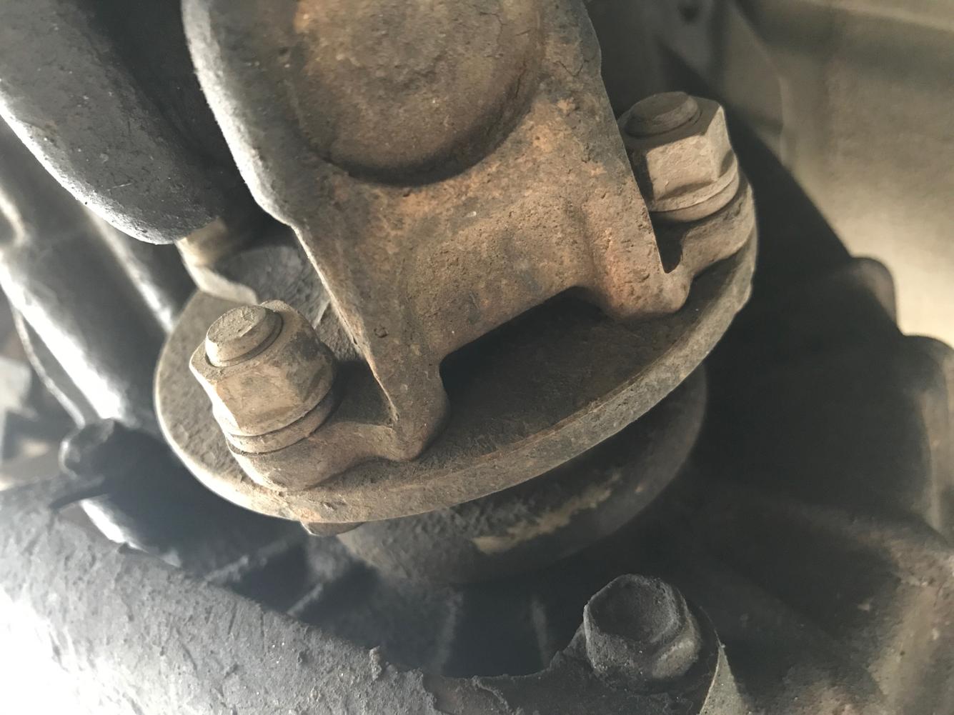

How should I remove the front drive shaft? It is unbolted from differential and Tcase. If memory serves me right, at the differential all bolts are removed so It should break loose there. On the Tcase there are still 4 bolts, nuts removed, sticking thru drive shaft. I figured I need to remove rear drive shaft and slip Tcase toward rear of vehicle to free up front. Is that correct?
I use the gap in between the bolts to get a pry bar in. sometimes a shock from a hammer helps as they tend to rust together
Not really. The rear end of front shaft is nuts on studs in the flange but the front is nuts and bolts through holes in the diff flange. So if you remove the front bolts completely, you just need to compress the front shaft enough that the front yoke circular rim clears from the hole in the front diff flange. Then the front end drops free and you can pull it forward off the studs.
Same for the rear. Separate the diff end first because those are bolts. TCase flange has studs.
