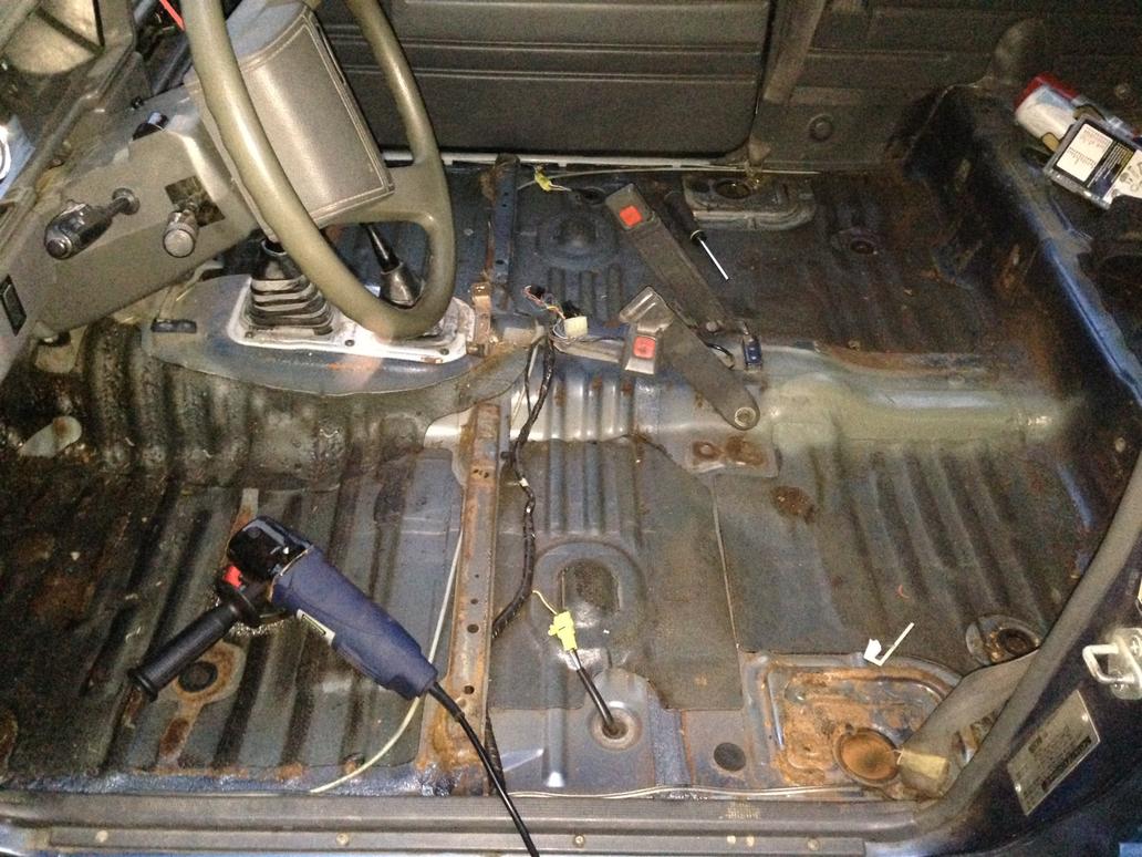

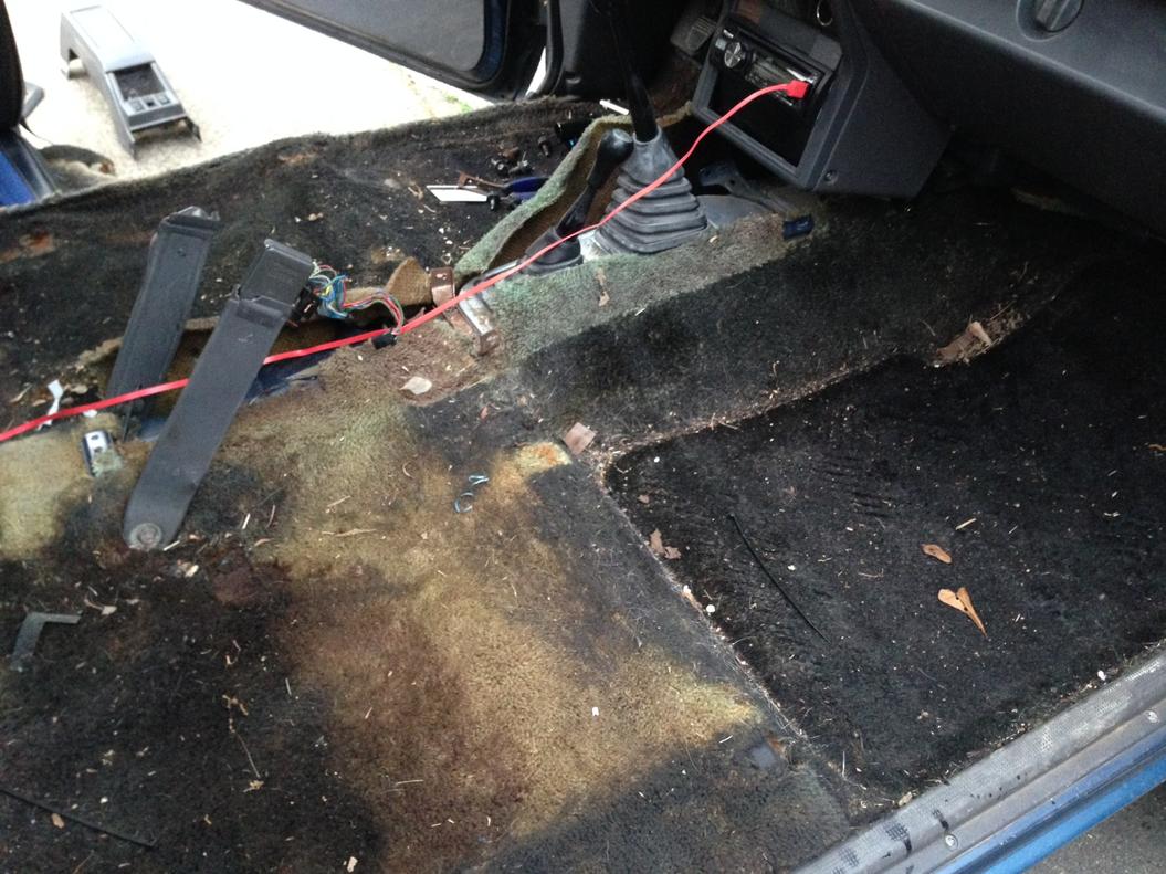

So I ripped out that nasty carpet that came with the truck. It was incredibly satisfying while I was doing it but then looking at a bare tub I was definitely thinking "what have I done?!!" There is a little bubbling surface rust under there and I can tell from the nasty state of the carpet that it had absorbed an awful lot of moisture in it's day.
I wire wheeled some of the rust off then prepped it with some self-etching primer. I think I will use underbody spray to protect it.
I'm a bit worried about cutting out and installing the vinyl floor kit I bought. There is a lot of cutting and holes to make in it but the non-factory garbage carpet that was in there before did not leave me much of a template.

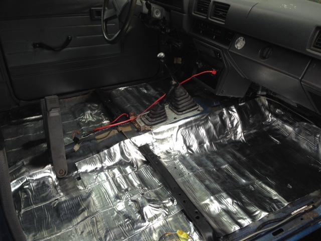

I am going to put down some "peal n' seal" for sound deadening/insulation as other people have done on here. Hopefully I can figure out how to get everything back together again.

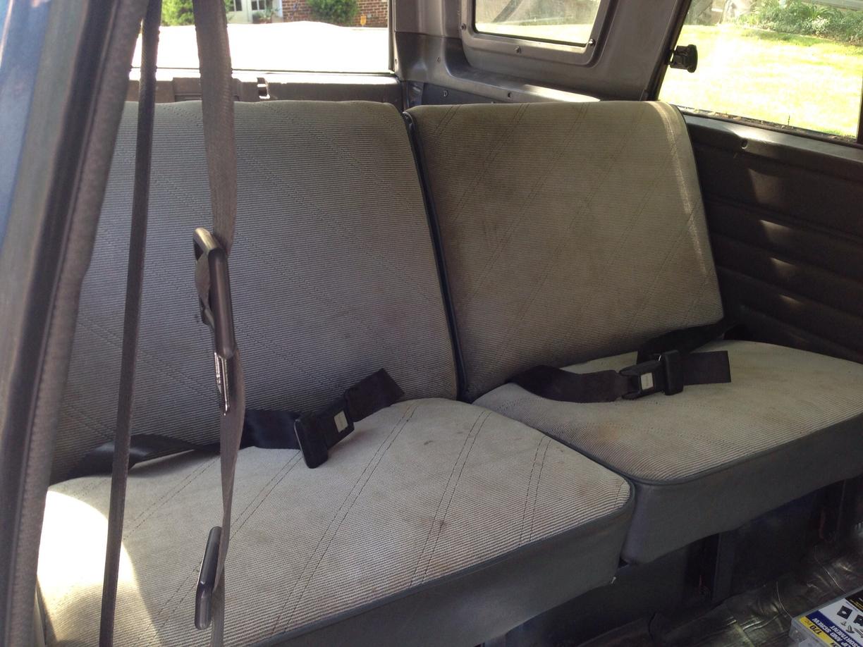

Are your rear seats split, or full bench? Mine are split, I will try to remember to get some pics of how they latch if it will help.
You will love the softopper!
They are spit fold. Here is a pic. Factory hinges have two bolts per hinge that attach to the seat frame. These do not work with the factory hinges I got off ebay!
My '85 came with a 1 piece rear bench, but no brackets/hinges. I got a set of factory hinges and drilled holes in the seat frame for bolts. I think I have read about 3rd gen rear seats fitting pretty well. You might consider that, since your seats don't seem like a direct fit anyway.

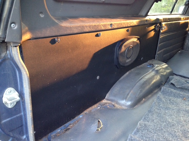

Ok, so here are some pics of what I've been up to...

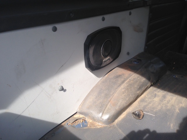

So I'm loving this harbor freight bed armor stuff. Cheap, seems to stick well and sprays on thick and consistent. My cargo area came with some DIY panels made of some kind of cutting board-like material. I used bed armor on them to make them black instead of dirty white. Yes, I need some new pop rivets. I think I may use this stuff for the rest of the cargo area floor and make some hard back panels for the seatbacks.

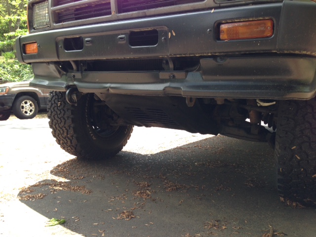

I also installed a factory Skid wire wheeled, primed, and covered in more of the iron armor junk.
My passenger area is still covered in bare peal n' seal. I'm going to make one last attempt to install the vinyl flooring but I may give up and have the local upholstery shop do a proper job for $100. Cutting and trimming is not my strong suit.

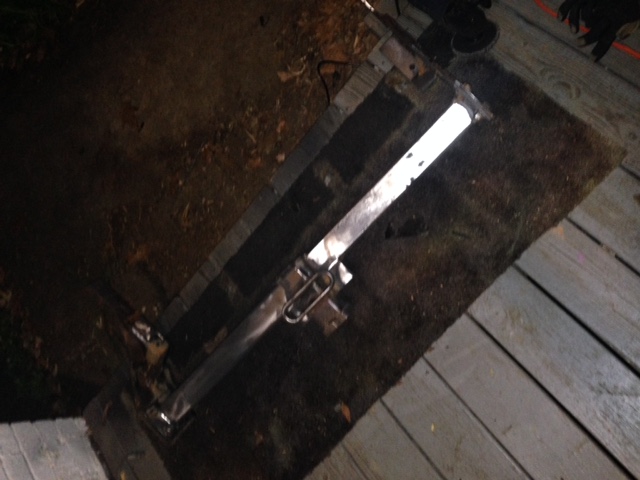

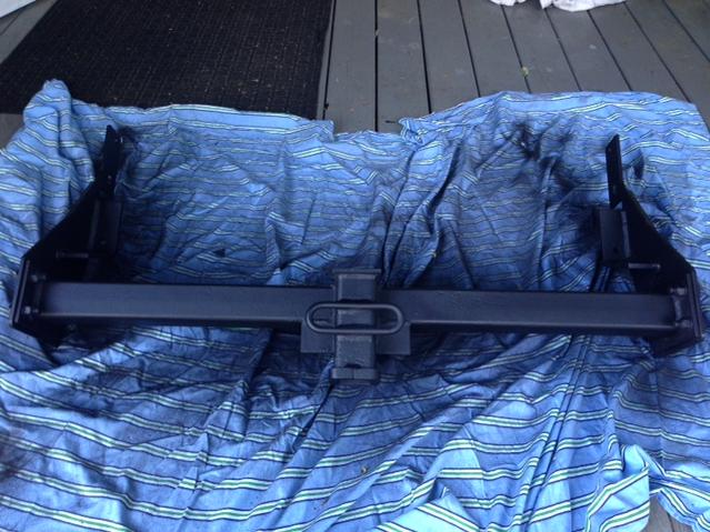

I'm working on re-finishing this rusty old trailer hitch (another gem from ajohnson). I really want a bumper with an integrated hitch because I will only ever use it for hitch bike racks. I don't like the idea of hauling around 50lbs of trailer hitch all the time.
I'm not big on the trail gear one personally. I don't like the gap between the bottom of the tailgate and the bumper. Anyone have a good suggestion?

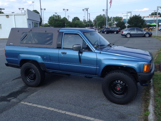

So softopper sent me a charcoal gray top instead of a black one! I doublechecked to make sure I ordered the black and sure enough, I did. I'll contact them when they open today and see if they can help me out. In the meantime my truck is sitting with a tarp on it and the fiberglass is at a friends storage unit. Went ahead and got the softopper framework in place. The instructions show fully boxed aluminum bed rails but mine came with stamped steel L-shaped ones. Kind of disappointing because it makes it look a bit more like a home depot project. A few other things have changed in the kit but the instructions are pretty vague and not up to date!

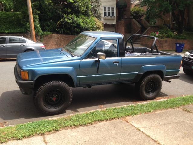

In other news, I got the roll bar in place finally but I will probably pull it back out again soon to re-finish it.
Hitch is prepped and re-sprayed, just waiting for the bedliner to fully harden before I put it on.

Talked to softopper on the phone yesterday and they gave me the option of switching to the black or a $100 discount to keep the gray. I chose to keep the gray mostly because the hard top was already in storage and the truck was in front of my house with a tarp on it.
The gray is kind of growing on me though and $100 is a pretty decent discount. I think it now kind of looks like something a South American cartel would use to transport paramilitary troops. I already managed to get some scratches on the windows, man they scratch easily! Thanks to Softopper for the great customer service!
