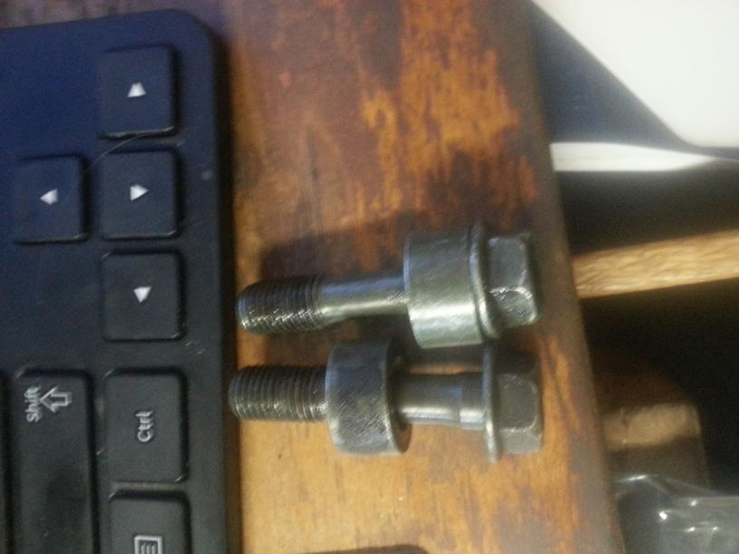

Hello everyone, I have inherited someone else s project. I have 2 bolts that where in with supposed parts for the head and cam tower. I cannot find where these 2 bolts go. they have a spacer and are locked on by the threads so they cannot come off. Any help with heir possible location would be perfect.

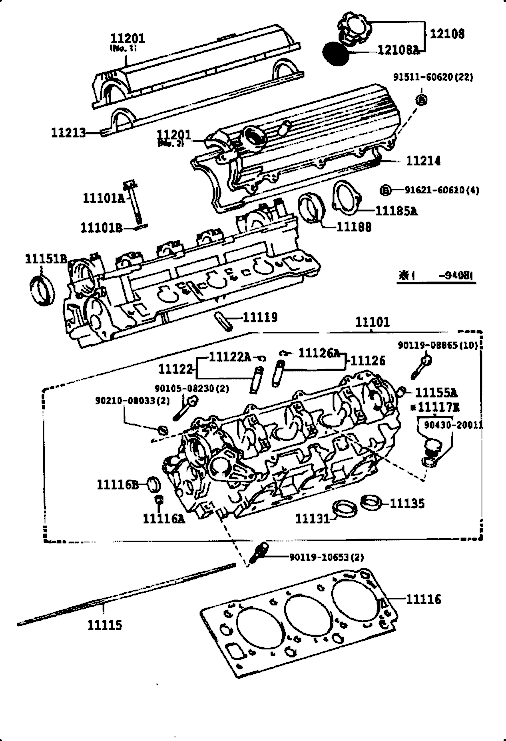

perhaps this will help
a picture always helps.Registar with TOYODIY.com for more exploded:bluejump: views

Thanks for the exploded View. I have looked at that one before posting and the only thing i could come up with is they are the 90119-10653 but cannot find a picture of that part to confirm it 100%. the bolts do not feel as if they are threading in there to hold the head in position correctly.
Yep, that's correct. Drivers side is front side just below the distributor shaft. Passenger's side is on the aft end of the the head.
