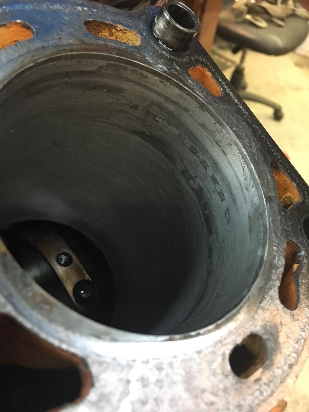

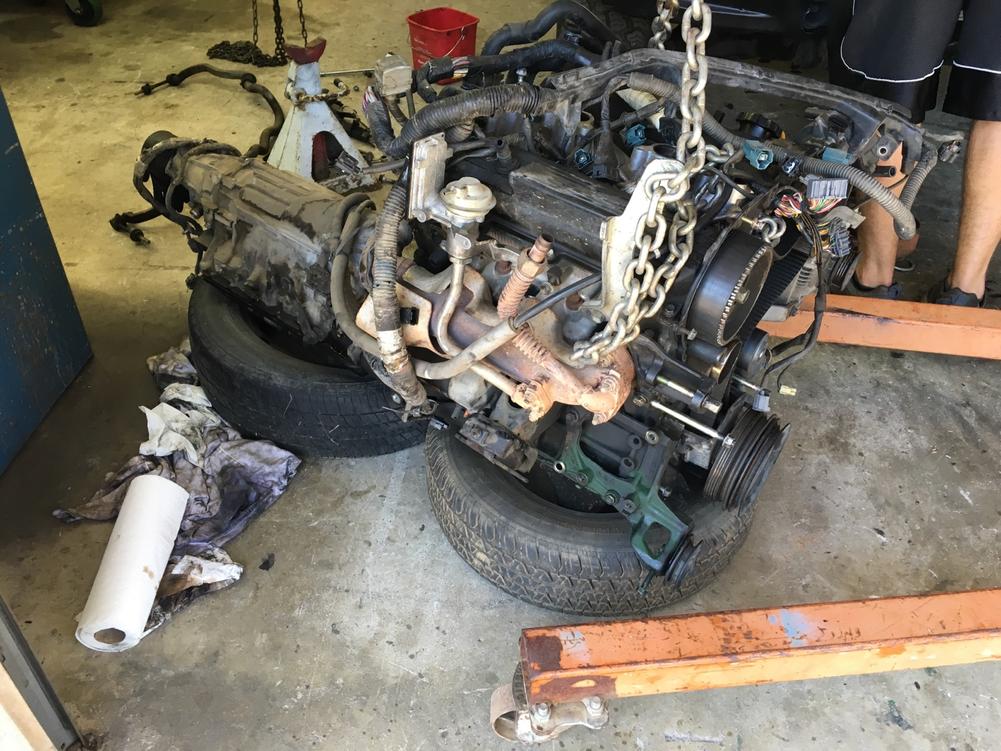

Alright, first thing's first... taking out the engine! She's ugly. But she hasn't been "molested" much, a lot of things are factory and show little to no signs of being touched before. We took the tranny out with the engine because it is just easier that way.
She had a blown head gasket so we tore her down to the block to diagnose the cylinders.

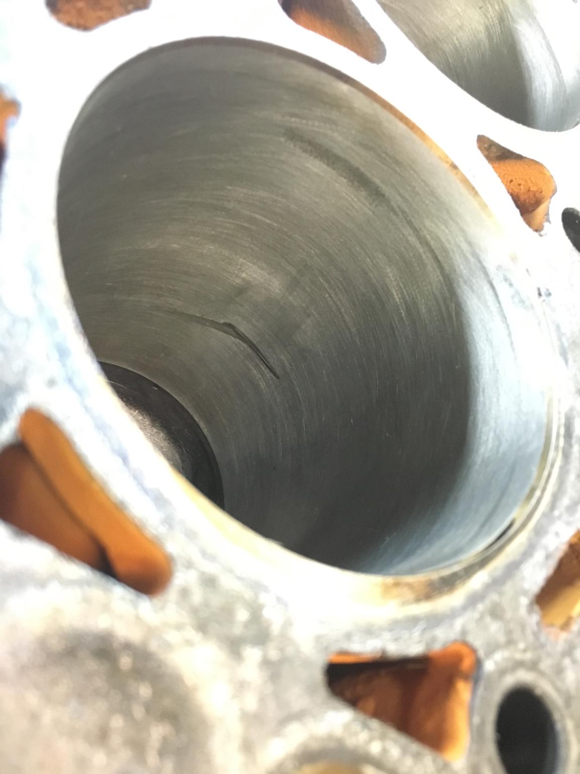

As you can tell, the cylinders looked awful. At first we were just going to say "screw it" and run it, then we noticed a giant gash (last photo) in the cylinder. Now we would have to get it bored and re-honed and I am trying to take the absolute cheapest route.

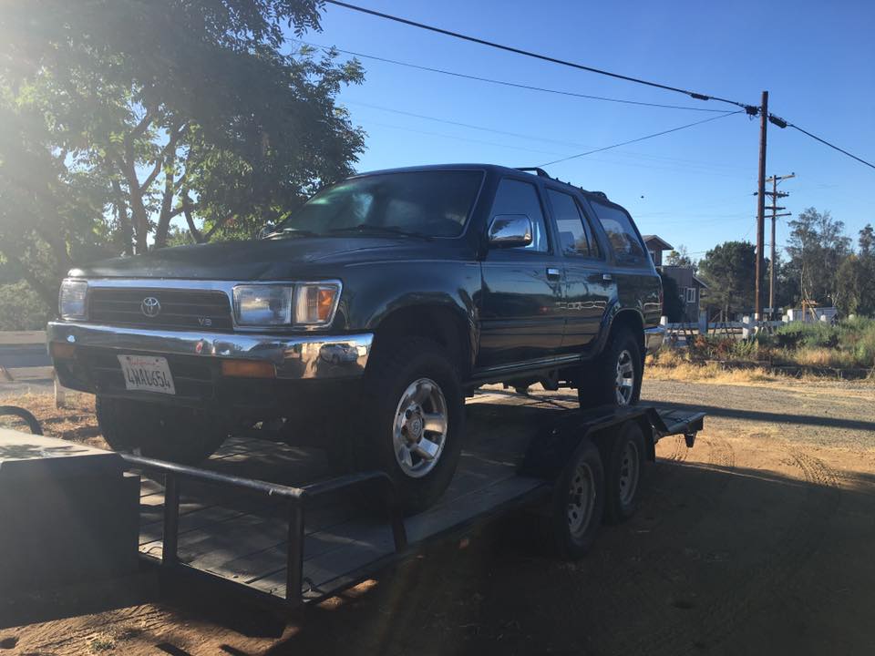

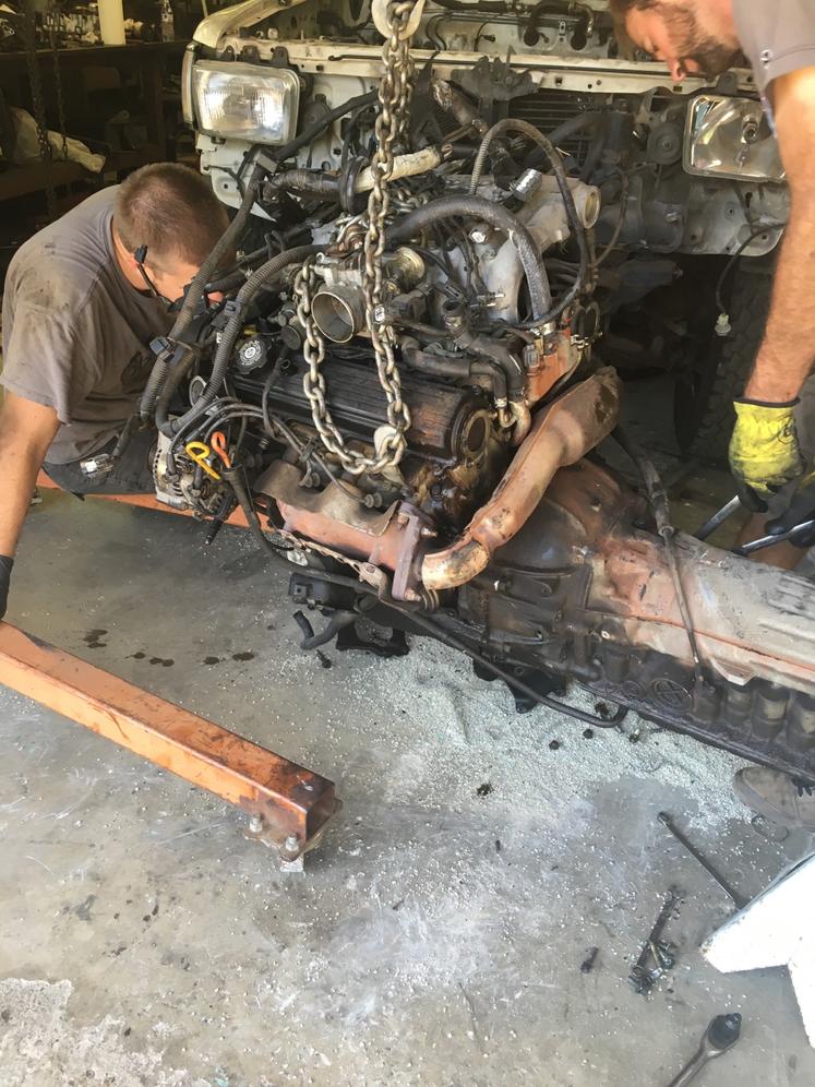

So, going to our friend's place (he has 3-5 4R's for parts) we trailered his newest addition to the shop and ripped her apart. It's the exact same truck ('95 2wd with 3.0)
so we tore out the engine/tranny from her - again she had a blown head gasket but it was a much more recent problem (mine had been sitting for almost 2 years with the previous owner)
Cylinders don't look AMAZING but who cares, it's a 3.0.... it'll be better than nothing, and it looks way better than mine. Only one cylinder is a little iffy but she'll run fine.
Yes I plan on doing a 3.4 swap in the future but right now I'm just trying to get it running....
Last night we put new piston rings on and put the pistons back in. Now we just need to re-build the rest!

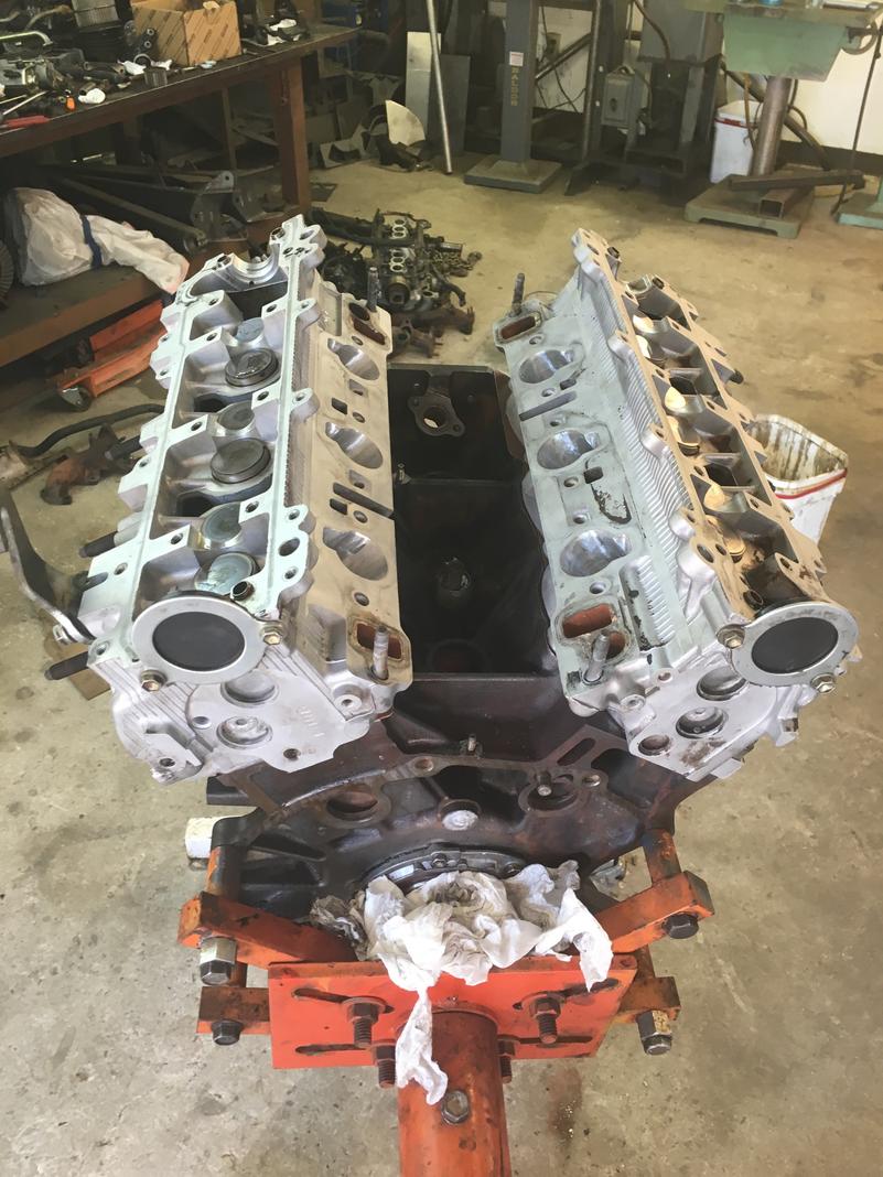

July 31: Big Day!
Yesterday was a big day!

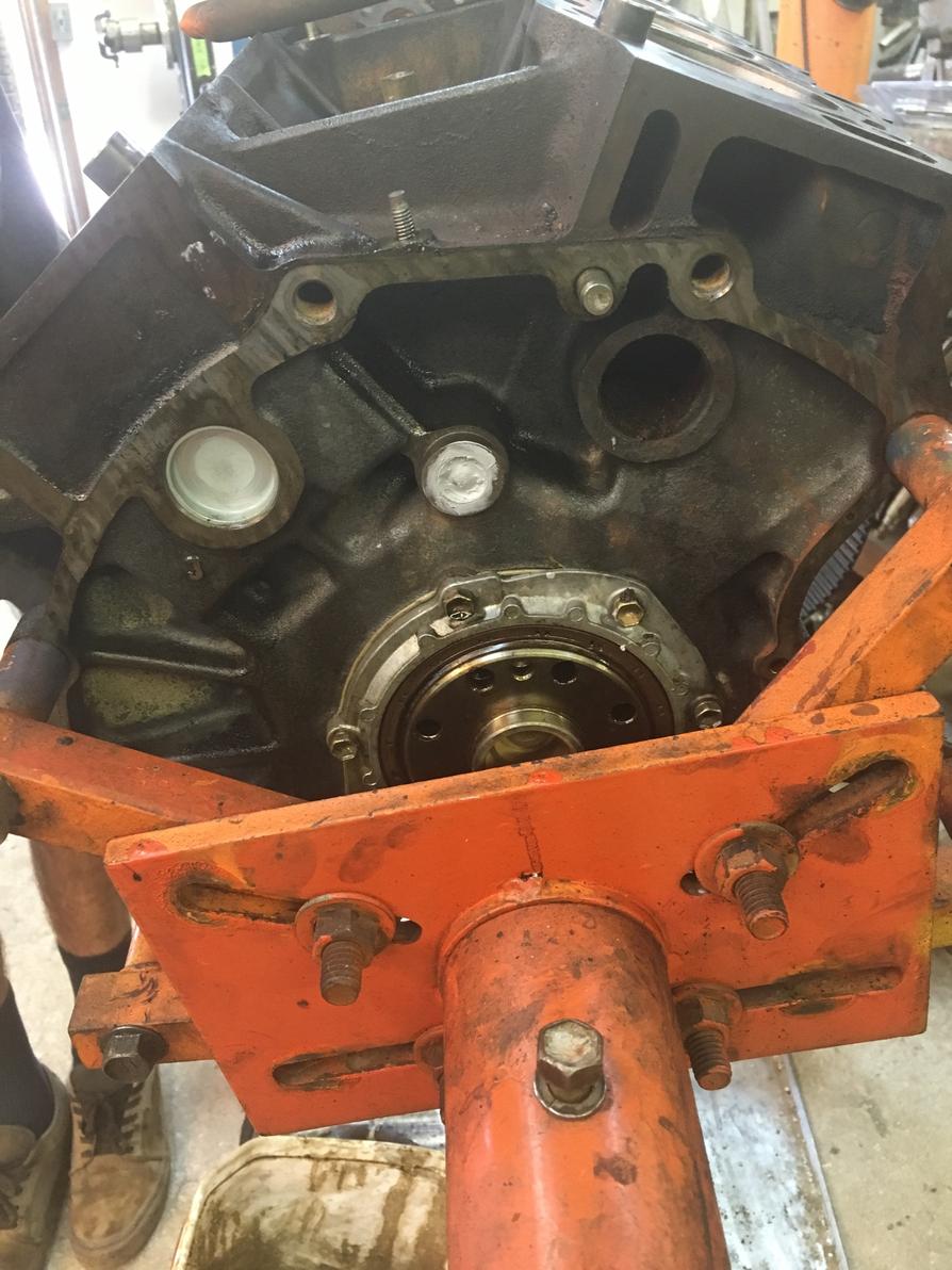

We got a new Rear Main Seal

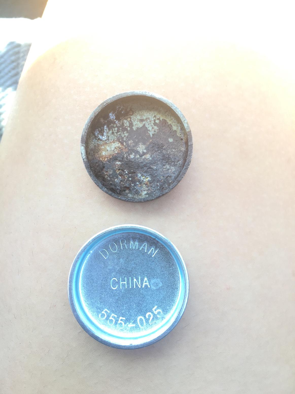

New Freeze Plugs (the one pictured actually has a hole in it.. cool.)

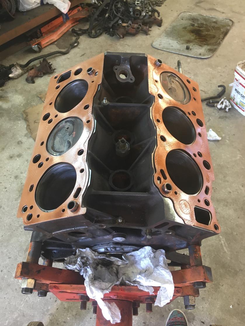

Copper Spray on the new head gaskets
Heads on and torqued!

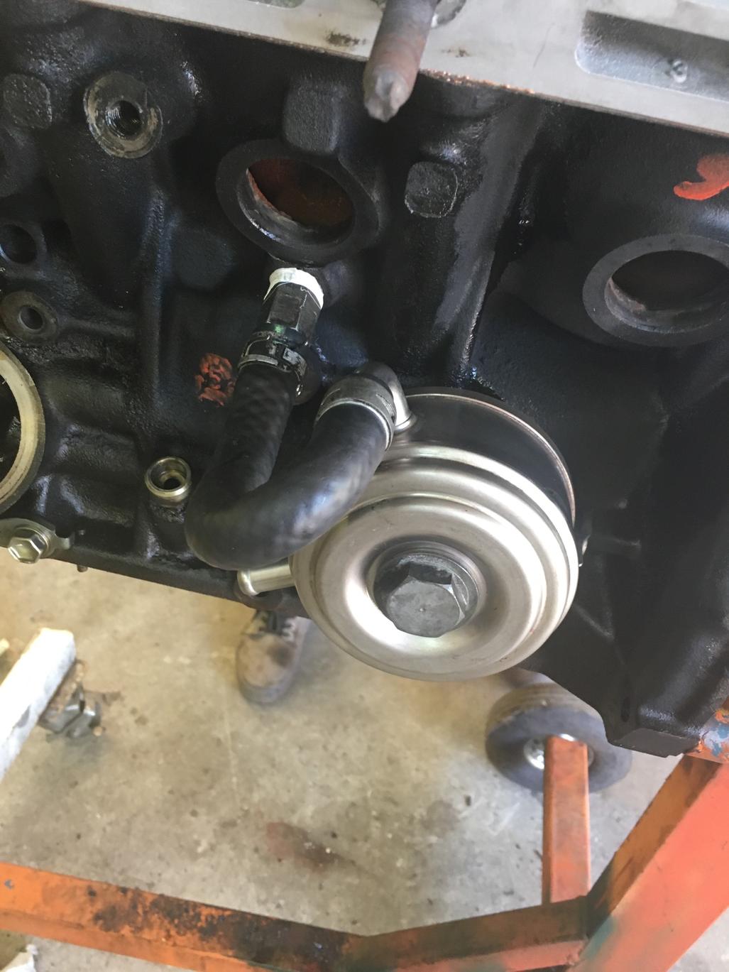

Oil cooler cleaned / new hose attached

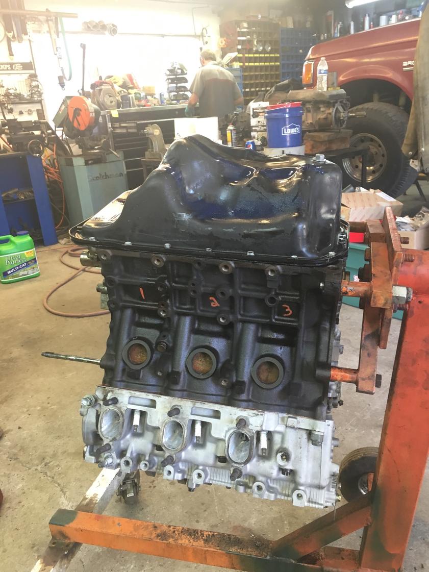

Oil pan on - boyfriend gave it "race stripes" (found blue spray paint and had fun. Thanks babe.)
so close... yet so far...

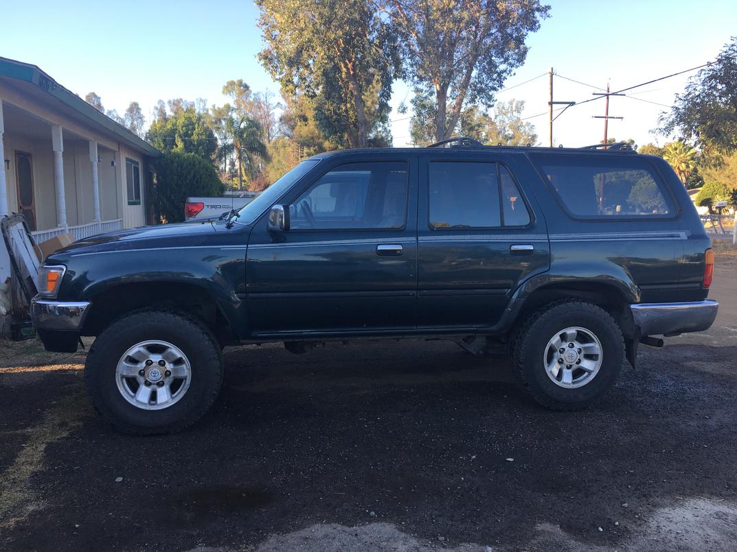

So as of this past Friday (9/9/2016) She is registered and Smogged! She's ready!

Preventative work, mainly. We would rather seal everything we can while it's out rather than find out down the road that it's leaking in a hard to reach spot.
