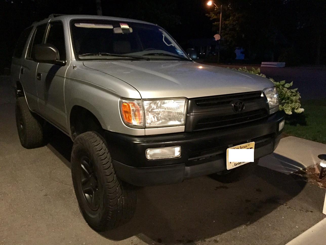

I have an 02 4Runner, and I can tolerate the fat lip front bumper because I got a good deal on it, and everything is mechanically sound, but I would much rather have the older 3rd gen bumper, specifically without the lower valence. I have the fog lights in the bumper also, which I already have a plan to replace and mount elsewhere with the new bumper, but I was wondering what all I need to swap bumpers. I was planning on getting a bumper from a junkyard, and I was wondering what brackets I need to make it work. Has anyone done this with pics, or made a write up? Any help is appreciated.

Correct...I just did it now, it does bolt right up after removing that crash bar...Brilliant mentioned that it is flimsy, while I wouldnt call it flimsy, it is def. not as strong as it appears...it only weighs maybe 5 pounds...still nice to have that buffer but I still took it off and put on the 98 bumper..def easier to have someone help you but Im glad its over with...I had to tape my signals into the housings cause I havent switched over (cut the wire and wire in the 98 lights) but it looks good

No they dont match but you can use the bulbs from your 02 and you will have to tape them into the socket in the housing from the 98...this is a good temp untill you cut the wires and re-wire the 98 bulbs in...I just ran out of daylight and theyre pretty well taped in there hah
heres a pic

I swapped 96-98 into my 99. The turn signals are not same. I just bought some cheap aftermarket on ebay and forced the bulb socket into the new case. The plastic support under the fatlip isnt much protection either so I still installed the 96-98 and will upgrade to armor soon after s/c.
