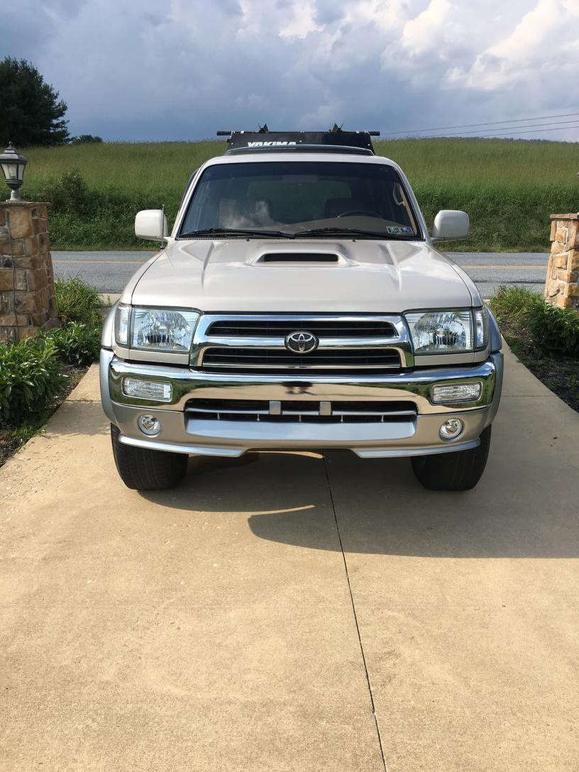

If anyone wants my old stock bumper they can have it. It's off of my 97 limited. It has a pair of small dents from someone backing into me but other than that the chrome is in great shape. Here's a picture of it before I took it off.

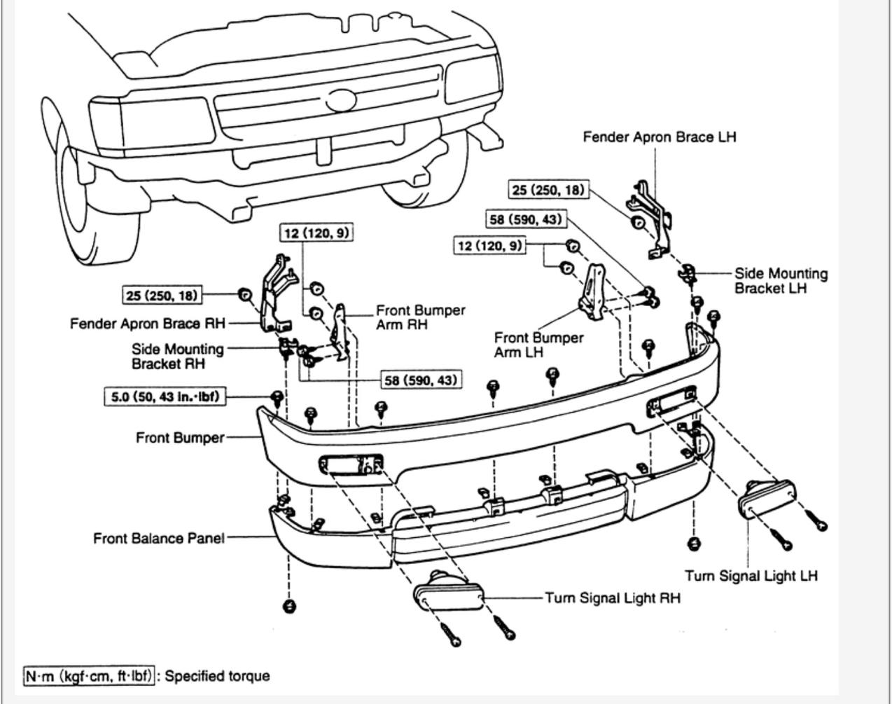

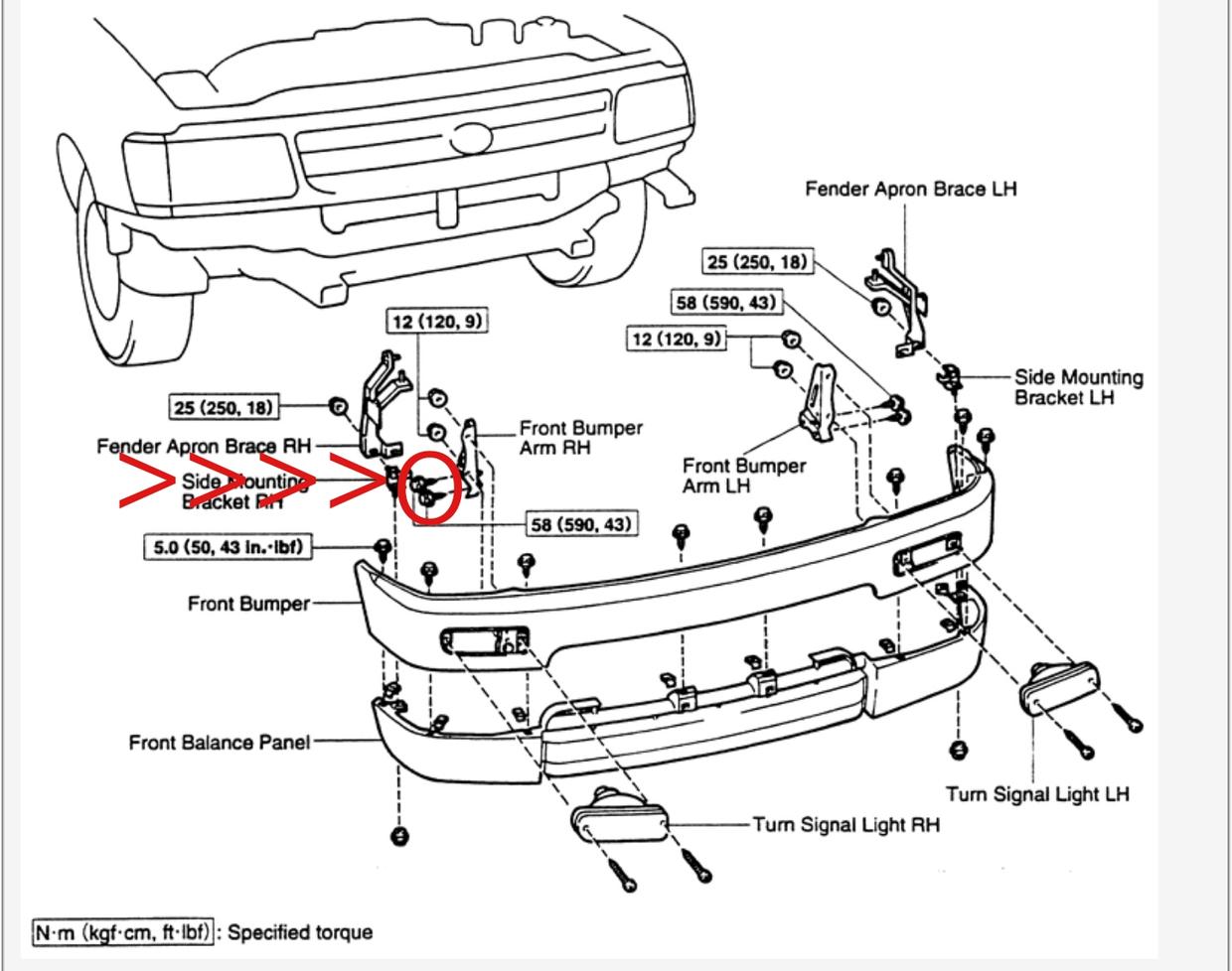

Sorry to 'revive' an old topic, but I've searched and searched and cant seem to find the size of these bolts. Any help would be greatly appreciated.

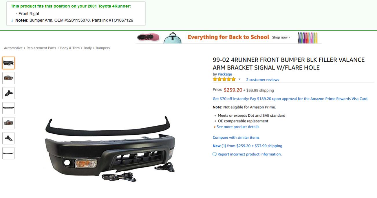

I had a boo-boo with my 2001 limited and I'm looking to replace my front bumper.
Ultimately I'd like an off-road bumper, but I'm not ready for new suspension just yet.
  • Screenshot_2018-09-17 Amazon com 99-02 4RUNNER FRONT BUMPER BLK FILLER VALANCE ARM BRACKET SIGNA.jpg

This is still my favorite set up and look if you’re keeping all factory stuff and looks better than adding the 99-02 bumper. The lower spoiler Also fit 5 inch lights that actually work at night and are super bright.
