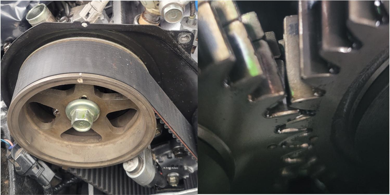

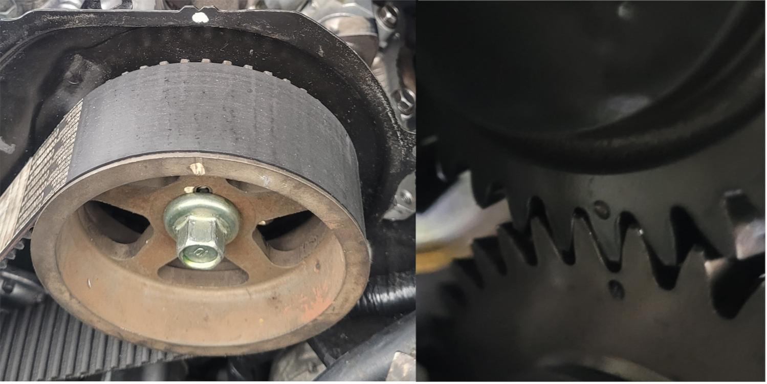

I took a ride back to the house to get some pictures for you guys and I noticed something that I'm not understanding. I have everything aligned as pictured but when I rotate the engine 720 degrees, my cam pulley marks line up, the came sprocket marks line up but the crankshaft pulley mark is off this much. What is the explanation for this?

You have the belt and cams right. I would suspect there's a sensor not communicating or unplugged. Double check the big ones like the camshaft position sensor and crankshaft position sensor, along with the MAF. Those three will cause a non-start issue. I would suggest getting a cheapo bluetooth code reader and the Torque app if you have a compatible phone. $40 and you can pull codes and it will tell you which sensor is preventing the engine from starting.

The fact that the timing marks are good at one point but when turned 720 degrees it is off that much at the crank pulley shouldn't be any concern?

If you are comparing the belt, the timing marks may not match up again. As far as the crank to cam ratio, I can't remember how many times each one spins. But as long as it lined up when you put the belt on, it's still perfect timing. Not like the a new belt can start jumping teeth.

Okay.. I've already turned the engine over multiple times so I am not comparing the marks on the belt at this point. I am using the stamped marks and notches on the engine and pulleys. The turn ratio would be 720 degrees on the crank rotates the cam 360 degrees. If I look at my engine now, all of the marks on the cams and crank pulleys are TDC. If I rotate the engine 720 degrees my CAM pulleys line up correctly but if you look in the 2nd picture of the crank pulley it's almost 1/4" off of 0. If I rotate 720 degrees again, everything will line up.
I'm going to break it down and start over. I'm thinking the crankshaft sprocket timing marks and the crankshaft pulley timing marks are not true with each other causing it to be those few degrees off,every other rotation, that is shown in the picture.
