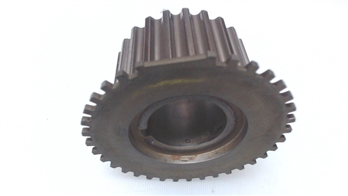

I might just be seeing some picture distortion with this crank timing gear, but it looks like one of the gear's teeth might be damaged. We chipped one of these teeth on the first engine build we did and the vehicle refused to run with several backfires taking place.
Turn it over and check the gear over 360 degrees to make sure it is absolutely flawless. I attached a picture from google because my build pictures are on an old phone.

Oh my gosh, you are right. It looks like one or more of the teeth is sheared right off. I was concentrated on the timing marks so didn't see it.
If you can, remove the upper timing belt cover and shine a light down on the crank gear. Should be obvious if they are all there. Just slowly turn the engine over with a breaker bar to see all the teeth.
I've turned the engine over and over looking at those teeth until I felt crazy at one point of trying to troubleshoot this... It's distortion in the picture if anything
